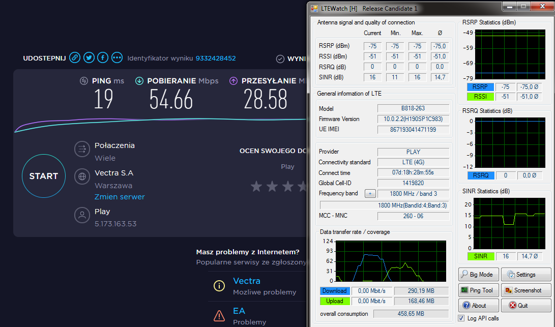

    hey, I join the topic earlier, I wrote that I have 1.9 km to the nearest BTS, only play has 2600lte there, Orange and T-mobile on Networks! 2100lte the highest band, so my contract is over and from today I have Play on Huawei B818. So far I had a chimney antenna geared towards this Networks! but linden was. 30 Mbs in the morning at most, 10-15Mbs in the afternoon for a cottage that's not good for the 21st century. I have a mast on the chimney about 7m high, from which you can see the above-mentioned. BTS. Please advise what antenna to buy? The cable from the antenna to the router is about 5m, then from the router, I still have a modem cable to the ground floor. For testing, the router is on the windowsill on the right side of the window on the ground floor. I did the test around 17.30.

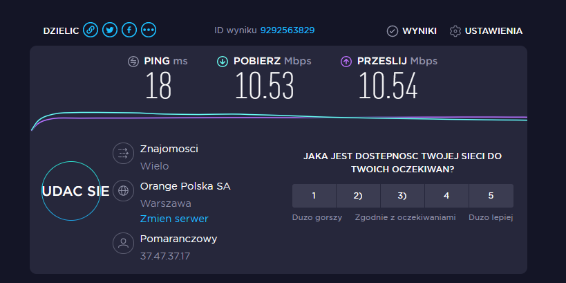

    Added after 14 [minutes]:
    Here I gave a screen with orange on the 1800 Sorensen antenna, I think it is called, without ltewatch because I turned off the wifi on the router and I don't want to Title: Huawei B818 on Play Network: Best Antenna for 2600 LTE & 1.9 km BTS Distance go and restart it, it's his last day

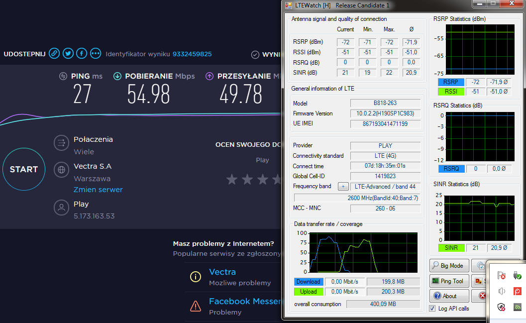

    Exactly what antenna do you have? Signal parameters are very good with this window. Especially LTE 2600 has hardly anything to fault. Only the SINR is average on all bands. LTE 2100 also at a good level. LTE 1800 is also ok, but LTE800 is usually clogged and it is the same in this case.

    I am also without an antenna, but he is on his way to me. We have similar results when it comes to transfer speeds.

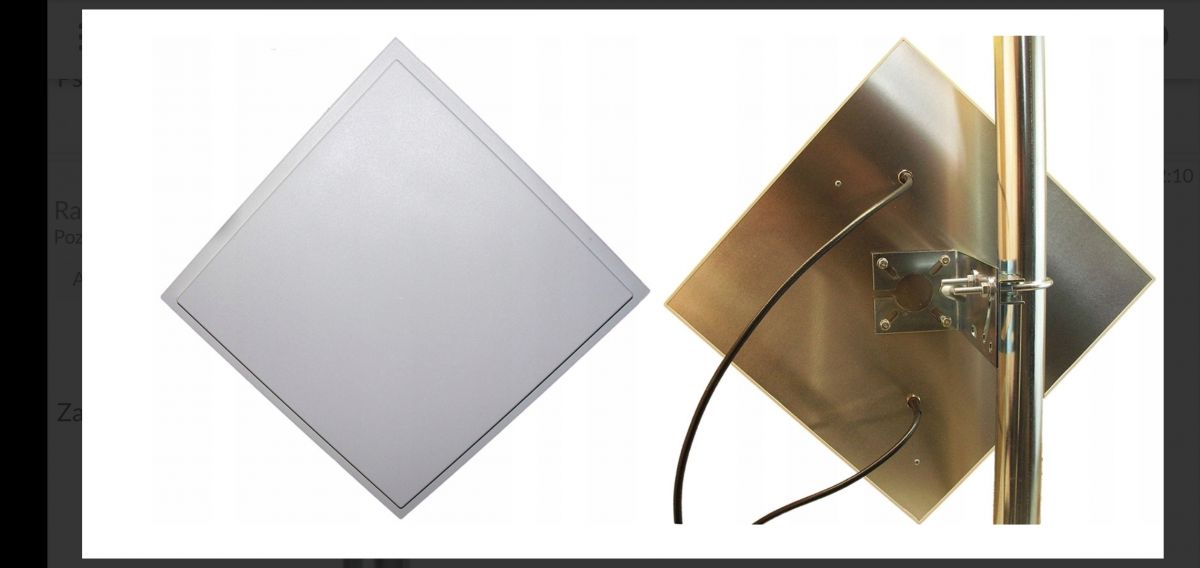

    Also, as in mine, in your case, I recommend the dual antenna in oblique polarization 1800-2600Mhz Link Title: Huawei B818 on Play Network: Best Antenna for 2600 LTE & 1.9 km BTS Distance

    ok, I can already see this antenna, I will wait for the opinions of people who wrote me what to do, and I will definitely buy something to use the possibilities of this router to the maximum, because if I put it on the roof, it will be again in min. I will be doing something in this area for 2 years.

    Then connect this Sorensen and repeat the tests on LTE2600, LTE2100, LTE1800 LTE800 does not interest you because it is carrion anyway, for this you need 2 SMA-TS9 connectors if you had a router with SMA .. Then LTE2600 + 1800 + 2100 aggregation, use HManager on Android or LTEInspecteur for Windows, in them you can force specific LTE bands to aggregate. The antenna works at 1800-2100MHz but so far it does not bother because the signal at 2600MHz is OK outside. Don't buy a new antenna for now.

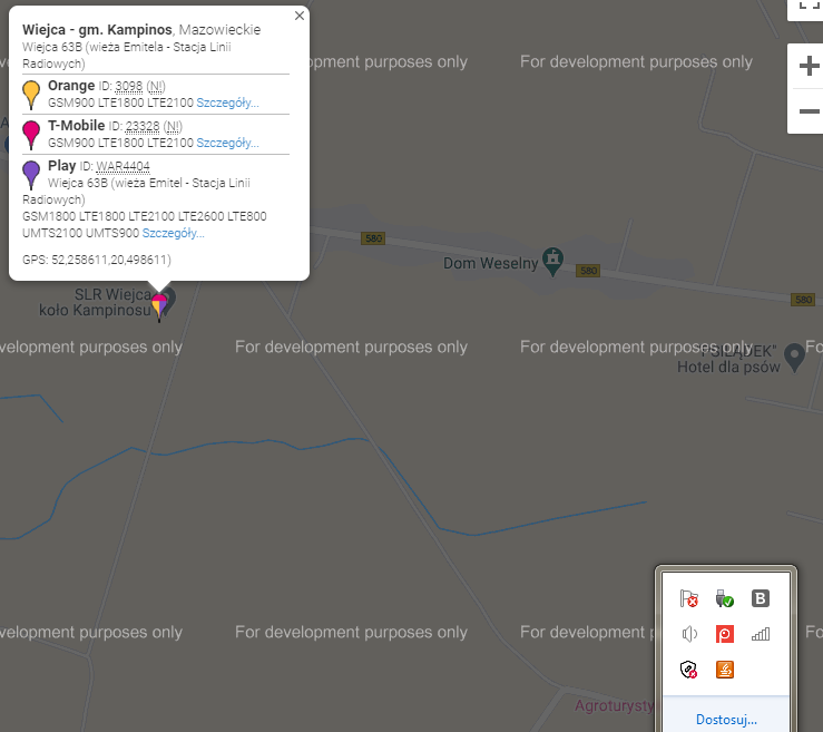

    Enter what location it is.
    You can skip the jammed 800 band. You can see you are close to BTS.

    location, my house bottom right, comes out 1.9km.

    So you are relatively close to BTS. B818 has TS9 connectors.
    This BTS Wiejca63B has aggregation access across all bands. So I am not surprised by your results.

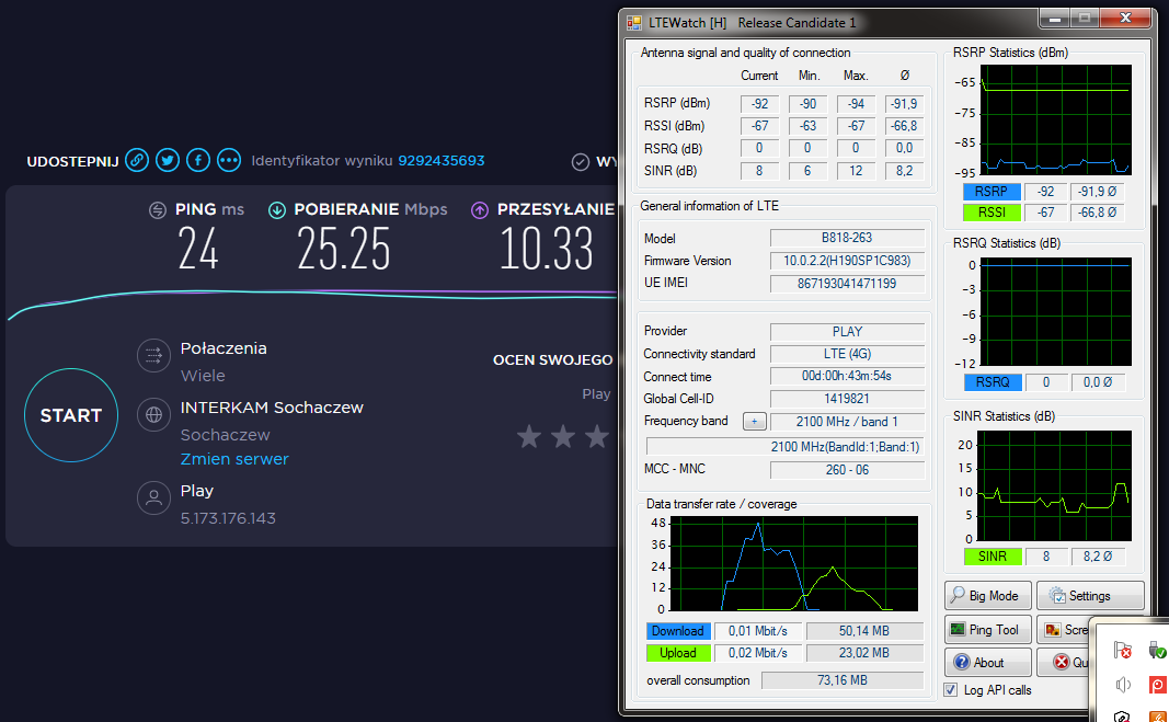

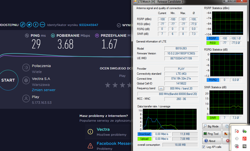

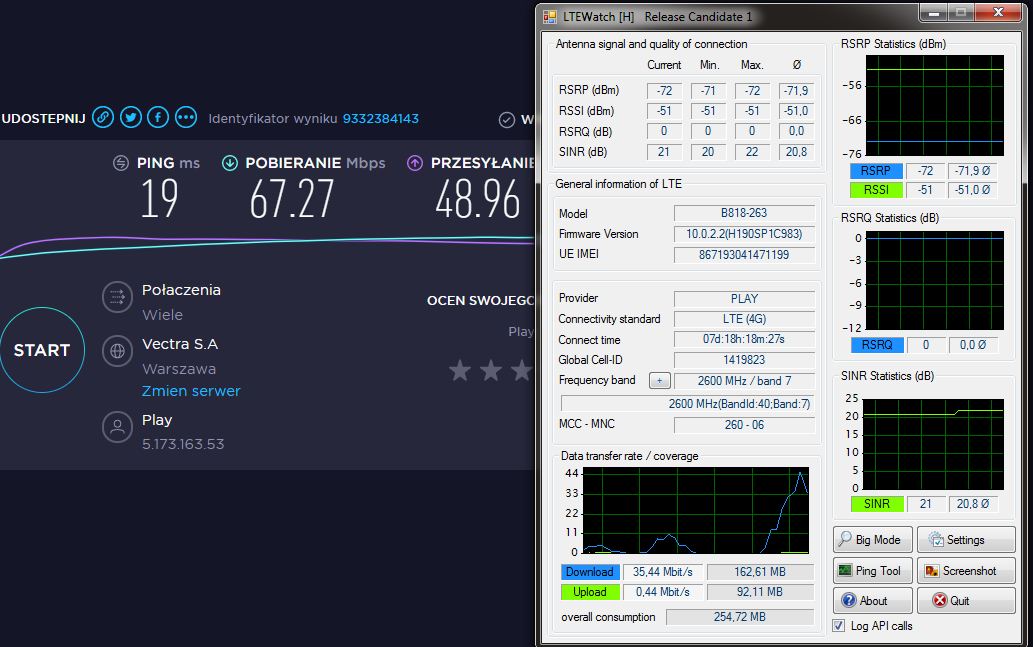

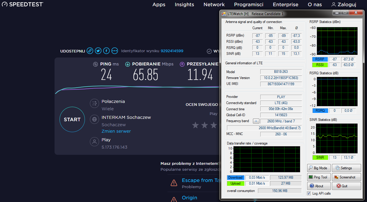

    hello, yesterday came the connectors and I have tests from this sorensen. Take a professional look, because for me a layman, the main parameters are better, but the maximum speeds from the sill are better on the LTE / A settings.
    Title: Huawei B818 on Play Network: Best Antenna for 2600 LTE & 1.9 km BTS Distance Title: Huawei B818 on Play Network: Best Antenna for 2600 LTE & 1.9 km BTS Distance
    Another question that bothers me is whether 2 years ago I did the cables well myself, soldering-crimping, somehow can I check it? then I checked with a meter and it was fine, but then I dragged these cables through the chimney through small holes, I could break something.
    And when I was changing the cables in the order of connection on the back of the router, the change in parameters was by 2.

    oki, I will order this antenna, and you will explain why the router on the windowsill had better results on speeds, although the tests with the current antenna had better RSSI and RSRP rates?

    It is enough that AUTO without an antenna combined with aggregation of several bands and with an antenna, e.g. on 1800 itself, and you have an answer in the form of a weaker transfer.
    For the antenna, buy a decent 5-meter cable, eg LMR400

    but there are identical ltewatch forced settings on lte / A and better results than on air
  • #30 18646462
    Range1
    Posts: 310
    Help: 80
    Rate: 22
    And how do you know if these were connections with the SAME BTS on air and without? Have you checked eNBID and E-CID that you are sure?
