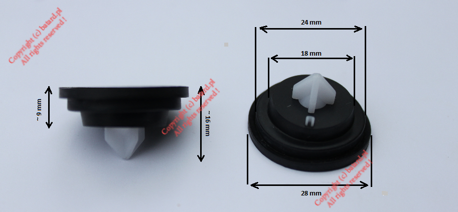

Where can I buy a replacement membrane gasket for this cistern filling valve?
A 28 mm diaphragm for this cistern filling valve can be bought for about PLN 6.50–6.70 from batard.pl, the Kranserwis seller on Allegro, or Leroy Merlin, and the 27 mm listing reportedly fits perfectly [#16207391] [#17947295] If you cannot find just the gasket, several replies suggest replacing the whole valve instead, since a complete valve costs only about PLN 11–20 [#16207371] [#16207391] [#18363165]

  • #16 17947295
    yosef99
    Posts: 7
    I will add my 3 groszy to the subject. A 28mm diaphragm comes to the valve you specify, they will be bought alledrogy at the kranserwis user as someone wrote above (PLN 6.50 + delivery costs) or at the Leroy Merlin DIY store, which is the only one currently on offer for PLN 6.70:
    https://m.leroymerlin.pl/hydraulika/narzedzia...Vx9myCh2dgQQKEAQYASABEgKn2PD_BwE&gclsrc=aw.ds
    in the description it is 27mm but it fits perfectly. I will add from myself that this membrane is difficult to access, even on the net. I leave the above information for other seekers :)

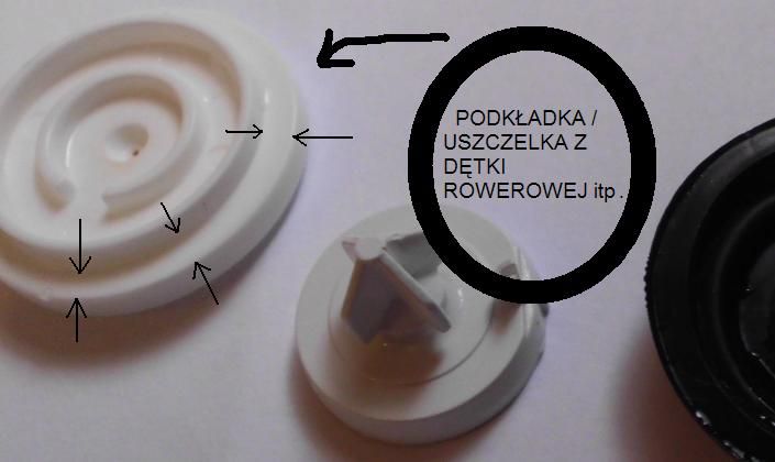

    Read the beginning of the already closed topic about the cistern: Cistern failure - where to buy a membrane, gasket? https://www.elektroda.pl/rtvforum/topic2789815.html
    I just repaired the cistern (low-flush - filling valve) at no cost.
    I CONFIRM what Zygaqra wrote - his way works !!! I cut such a pad from the old bicycle inner tube and super closes the filling valve in the low-rinse.
    Seeking Membrane Gasket for Cistern Filling Valve - Purchase Locations?
    You would need to buy a new whole shut-off valve and dismantle it and see if sometimes there is a seal that dissolves / biodegrades over time ... I wonder why it breaks so often. When you bought a new "porcelain" toilet in 1999-2000, it all worked for about 15 years - a flush. For the first time in 2015, the valve shut off the water supply to the cistern failed - that is, 15 years everything worked without a fault !!! Then I bought the whole valve the cheapest below PLN 20 in a hydrauylic store and since then it breaks down about every 2 years. I most often broke the valve when there was no water and then they released the water and then temporarily dirty water flew and the whole valve "shot" water mixed with dirt and air - the same in the taps. Last time when the cooperative was doing something and there was no water, I turned the tap on the toilet. Then when they released the water, I unscrewed the water supply pipe to the cistern, put the bucket and drained the water into the bucket, first dirty water flew, shot and fluttered, water mixed with air as if under high pressure ... and only when it calmed down and normal water flew and clean, I just turned everything and unscrewed the tap - for a few days the valve worked, closed well but after a few days it stopped closing again - i.e. refused to serve :)
    How did I clean this membrane gasket it was soiled as if with sticky black chewing gum - I was wondering where it came from, was it dirt or did some factory rubber gasket dissolve into tar ??? Or was it some original silicone grease? - But probably not. And the white circle on which I drew the arrows was also dirty in this sticky thing. We give this seal between the rubber membrane and the white plastic ring.
    After this repair, he gives himself 10 years of trouble-free operation ;-) Let's see how long it will last.
    https://leroymerlin.pl/hydraulika/narzedzia-h...-napelniajacego-ap-equation,p453949,l694.html
    ps. I have a Grundig M15 tower https://www.google.com/search?&q=grundig+m15 with a CD, a 2-cassette tape recorder, a radio, so old because it was bought around 1995. And you know what happened? The tape deck stopped working a few years ago, the cassette deck drive stopped working - just those rubber belts transferring the drive from the motor to the turning parts of the cassette "dissolved" and took on the consistency of tar !!!!!! -> https://www.elektroda.pl/rtvforum/viewtopic.php?p=18362756#18362756
