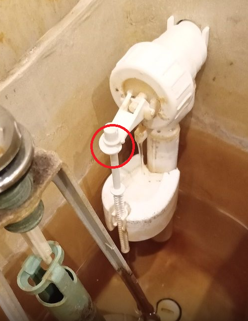

    The cistern is slow to fill, can it be fixed?
    Why is the cistern slow to fill and how to fix it? .

    Check for a clogged strainer in the valve if there is one. To check the filling valve if it is not clogged with some kind of paperwork.

    Also the float guide, whether it is not "overgrown" with stone. Because when the float does not drop low, it will only minimally open the fill valve

    @Pan.Kropa @Jacdiag what could be there when I unscrew that white cap, water is flowing and when I put it back together it's weak, there in that plastic is a hole of some kind it could be clogged ?

    Disconnect the float from the lever - then in the lower position there should be a maximum inflow of water
    Under the cap there is a rubber gasket that closes the water supply. The strainer that @Pan.Kropa wrote about is accessible from the outside of the cistern, after unscrewing the supply hose

    @Pan.Kropa @Jacdiag @jerry1960 I disassembled it a little syph was there but not much I put it back together and it still fills slowly. There is such a rubber gasket it is cracked is this the cause ? it is possible to buy such a gasket ? and such a whole mechanism is where to buy ? and I do not know what model to buy?

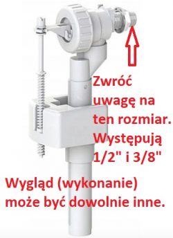

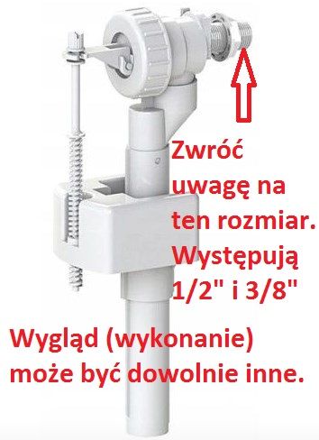

  • #11 20134061
    slu12345
    Posts: 160
    Rate: 13
    @Jacdiag @Mobali but it has to be the same shape of this valve?
    that would be?
  • #12 20134079
    E8600
    Posts: 8983
    Help: 529
    Rate: 2520
    It does not have to be the same important that it fits and does not interfere with anything.

    slu12345 wrote:
    ...but it has to be the same shape of this valve?
    It doesn't have to be the same, but it has to match:
    Mobali wrote:
    Preferably, dismantle the entire old cistern valve assembly and take it with you to the store - there will be no wrong purchase, and the salesperson will help you select the most appropriate one.

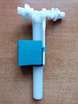

    Well, and you have carved. Today at my place failure of this valve only that the reverse. It does not close after topping up water. Disassembling the baked / stained for several years plastic is moderately worth the effort. At auctions costs new 10-12 zl and with shipping about 20 zl tomorrow at my place. I went to a chain builder. I assumed beforehand that up to 25 zł I will buy and above I will wait until tomorrow and pick up from the parcel machine. Well, and imagine that it costs 24 zł (they overheard my thoughts or what :?: ) (sic!) set ½" with the ability to switch to 3/8" water supply. The cistern is already working OK! :) :spoko: :lol:
    that would be?
    It can also be of other shapes (designs) but pay attention to the size of the tube (fitting) with the water supply.

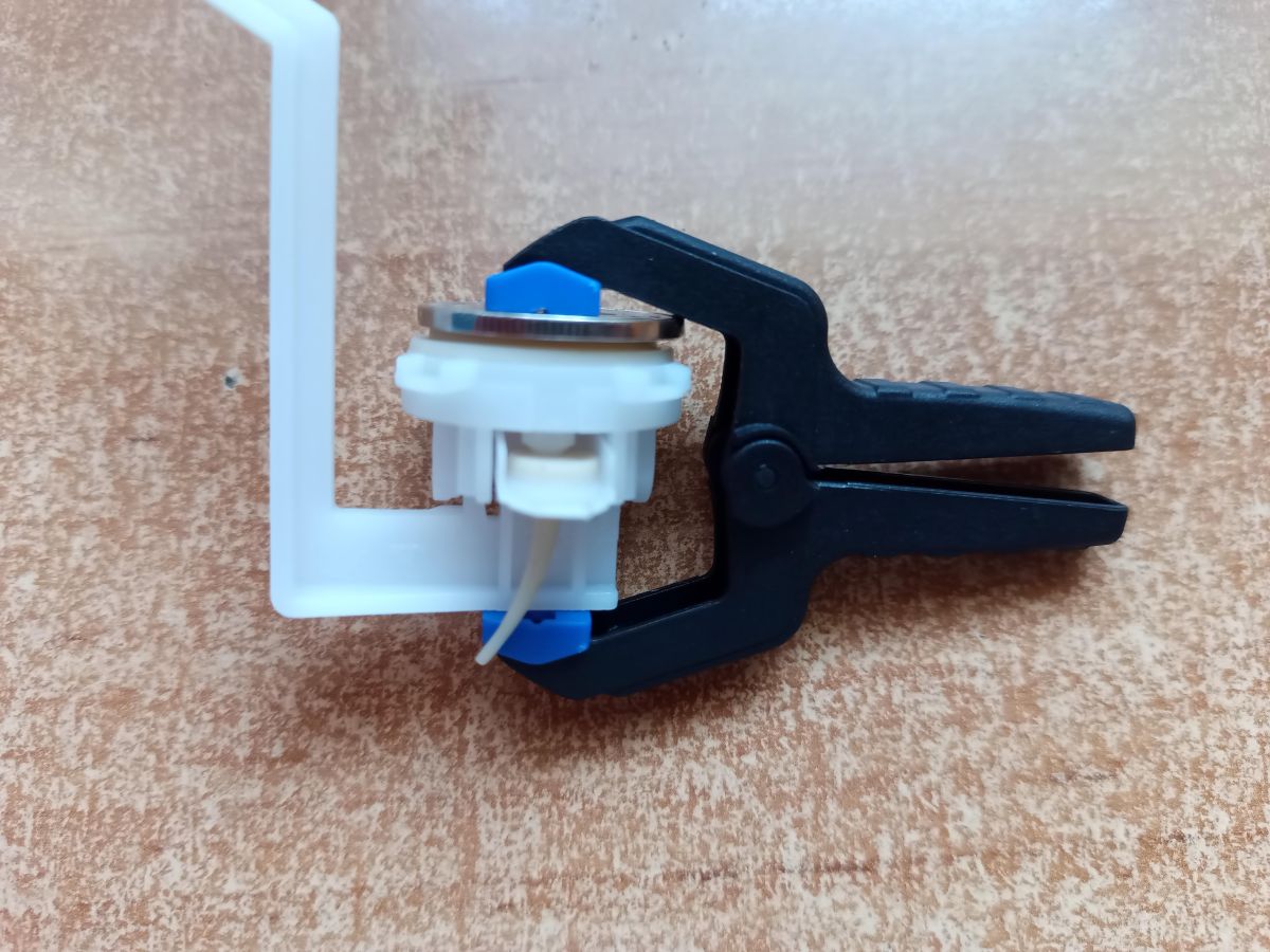

  • Silicone glue repair for leaking fill valve diaphragm
    #15 21601754
    Szeregowy2022
    Posts: 27
    Rate: 18

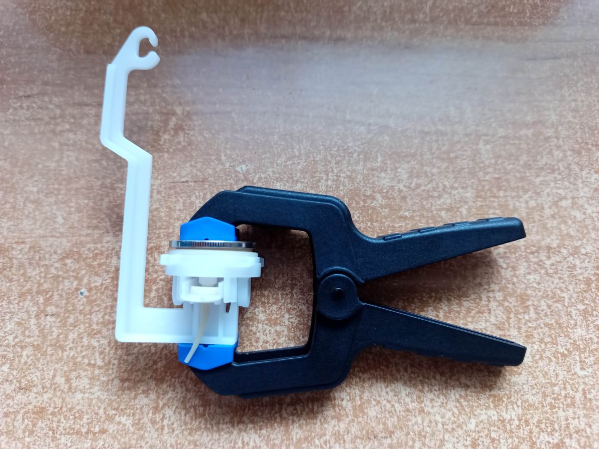

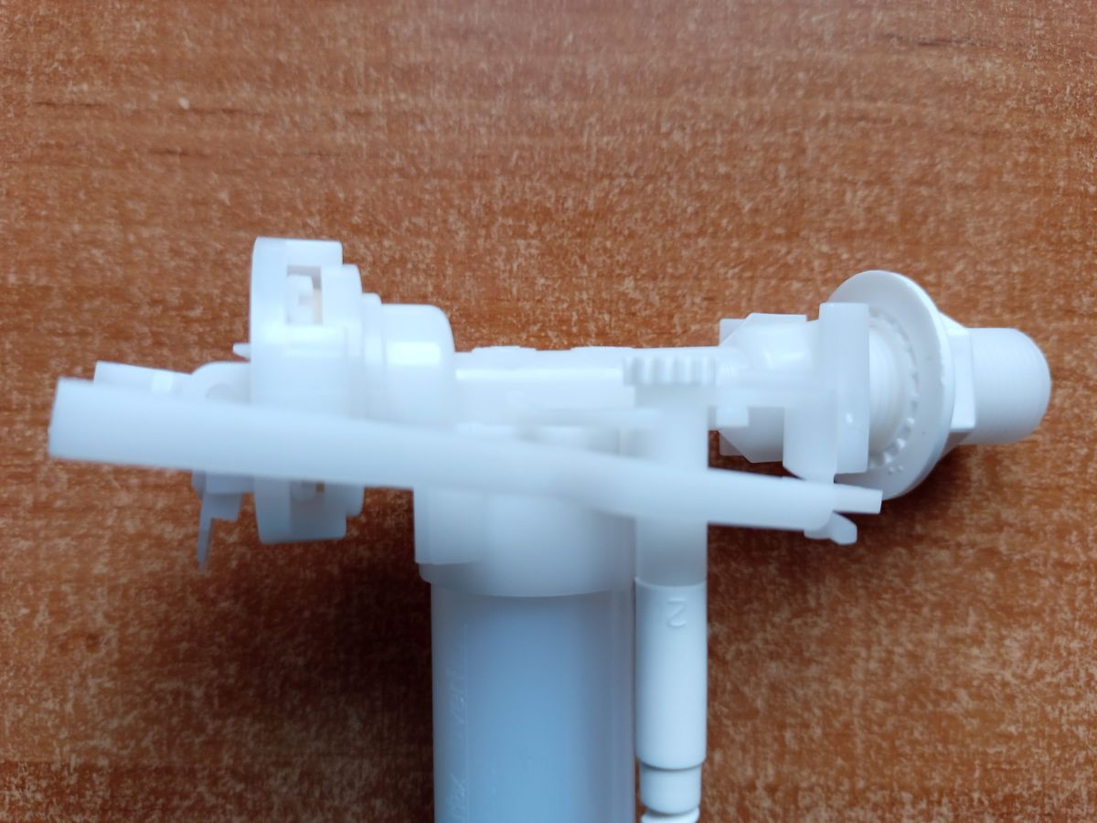

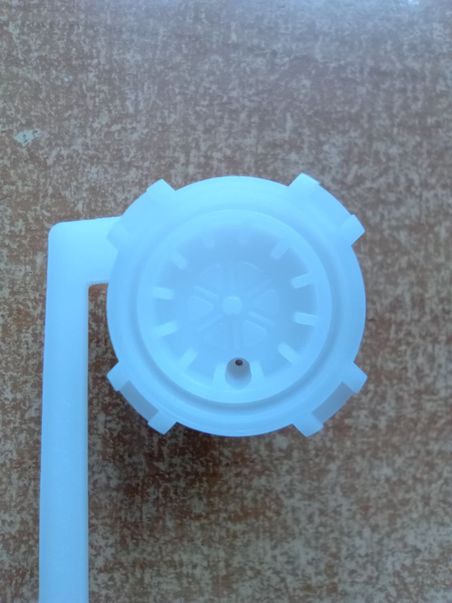

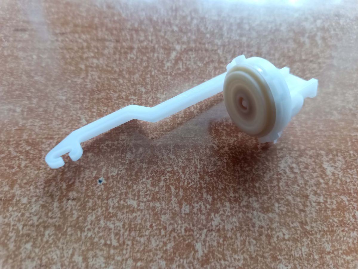

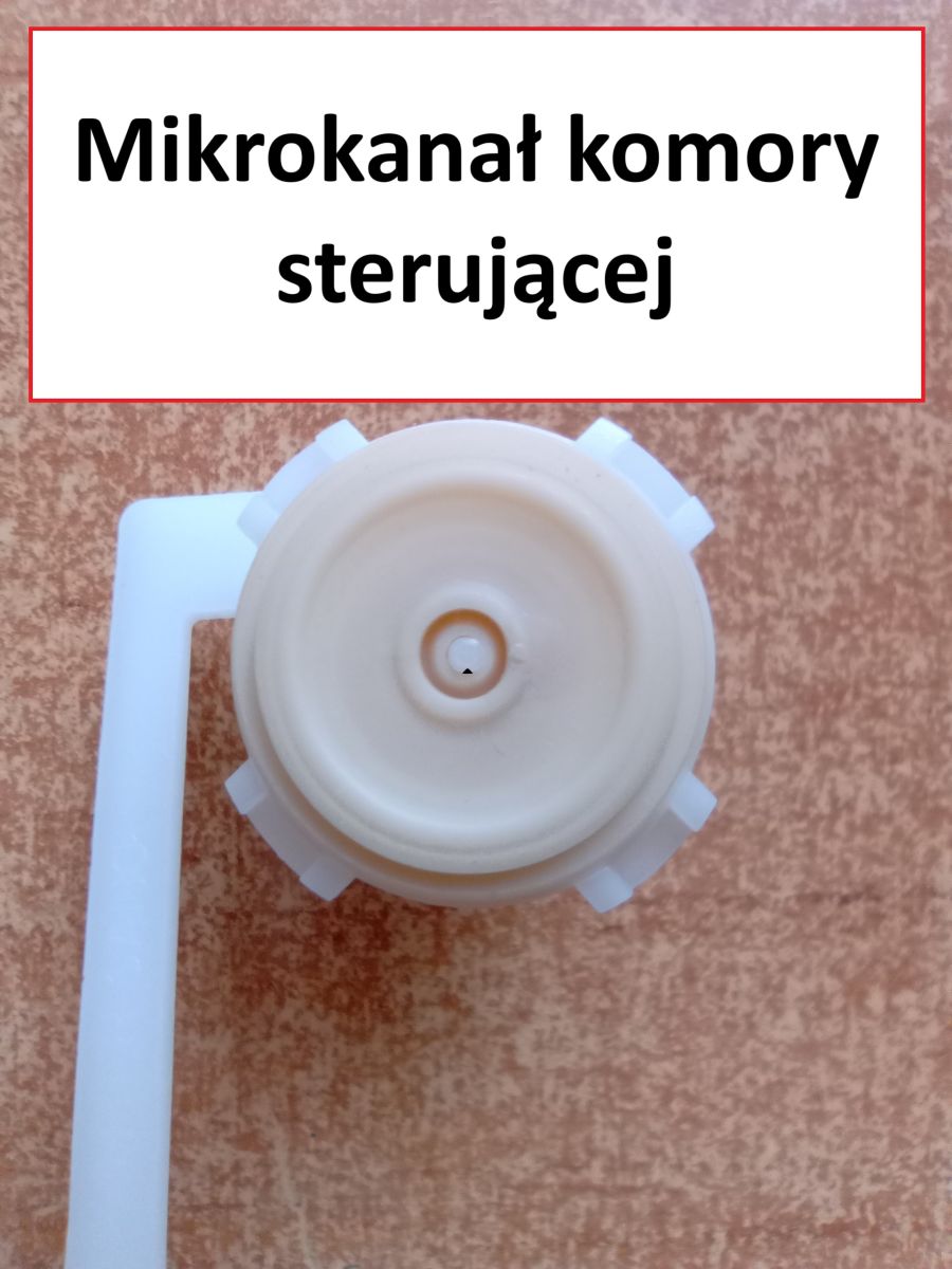

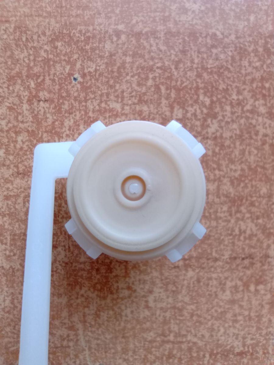

    My cistern has developed a problem with a slow Inter-Sano fill valve,

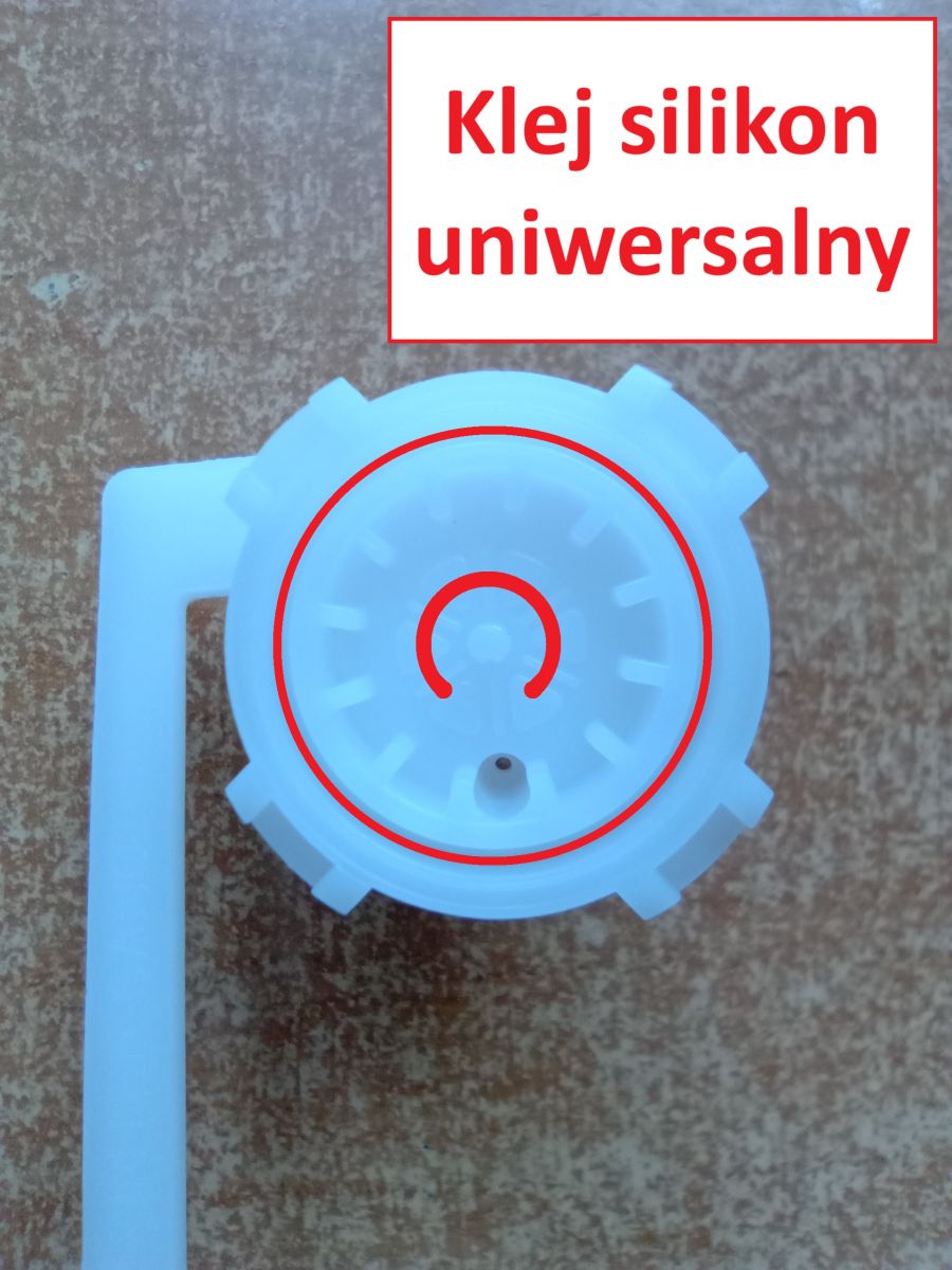

    resulting from insufficient pressure of the diaphragm against the plastic part of the control chamber. The cause appeared to be a loosening/unsealing of the connection between the two components.
    For the repair I used 100% silicone universal clear glue No. S-072 (20 mL) brand Technicqll . The glue was spot applied to the arc of the circle and the outer circle marked in red,
    excluding the section (arc of the circle) located directly under the microchannel of the control chamber,
    so as not to disrupt its hydraulic function.
    After the adhesive application, the diaphragm and plastic component assembly was compressed with LUX-TOOLS spring compressors.
    Compression with LUX-TOOLS 50 mm spring compressors is recommended.
    or 85 mm
    using a 1 zloty coin between the clamp jaw and the diaphragm for even pressure distribution, stabilisation of the components during curing, avoidance of diaphragm crushing and precision without specialised tools.
    The components were left in the clamp for 24 hours at room temperature to cure the adhesive. After reassembly, the valve has been working properly for a month now.
    I hope this method will help other forum users to solve a similar problem - in my case it proved completely successful 😁.
