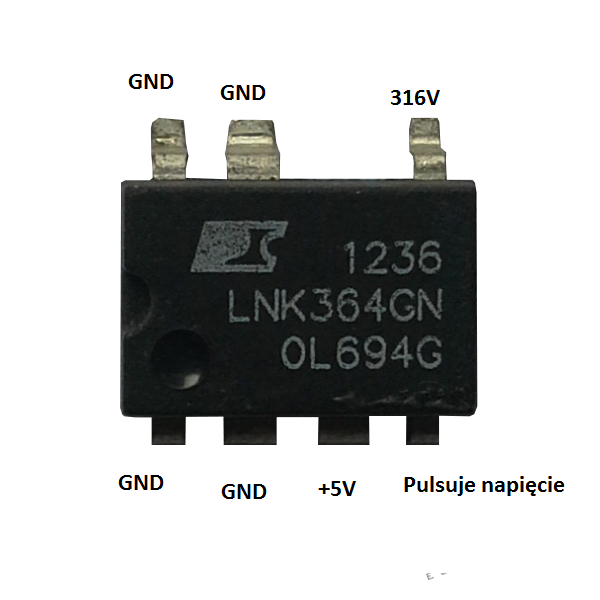

    There is 316V at the input of the converter, at the output at the capacitors, the voltage of 1.6V is pulsating and disappears, etc. It seems to me that the converter is not working properly, as a rule, when the converter is working, you can hear a slight "hiss", and here it is silence.
    As for the intricate connection of resistors, everything is well connected. At the very beginning, I read that it was in place R118 there should be a 22? resistor, but after plugging it into the system and connecting the board, you could hear the relay switching on and off, so I found that something was wrong. Then I found a post that 56k? should be there. By the way, I also replaced the resistor next to the SMD with a regular one because it seemed suspicious.

    Like the rest of the items in the LNK364 application? Capacitors and diodes, and see how many elements are included in a similar repair kit. Link

    Other elements checked, no disturbing measurements.
    When measuring the voltage on the converter, it looks like in the photo.
