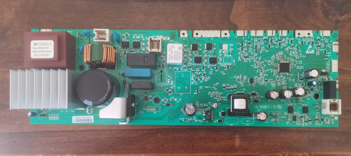

    Hi everyone, I have this board from an Electrolux EDH3787GKW dryer, I have error E50, the motor doesn't turn, but I don't think it's the culprit, has anyone had the same problem?
    AI: Have you tried any troubleshooting steps so far, such as checking the motor connections or testing other components?
    yes
    AI: Are there any other symptoms or unusual behaviors from the dryer besides the motor not turning and the error code?
    yes if left only on voltage, even without pressing the power button after a certain amount of time by pressing the on button it does not turn on.
    After a while it starts working again if disconnected from the voltage. New and working LNK

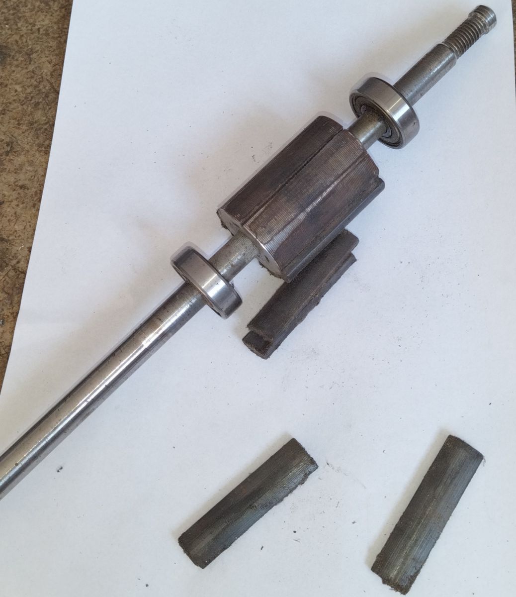

    In these dryers it often happened that it was the motor 8588072524024 that needed replacing. The magnets on the rotor were peeling off.
    Added after 2 [minutes]: .
    Rotor with detached magnets lying on a white surface. .

    Thanks, but I tested the motor externally and it works. I tried another board and the motor is fine. I start a drying program and it finishes well, then the next morning I find the dryer dead, that is, totally off, no LEDs etc. I unplug everything, wait an hour and it starts working again. This happens after various tests. I tested the board powered alone for 8 hours and it does not turn off and no heating present. Voltages present: 300 V, -18 V, 5 V, 3.3 V etc. I was thinking about the control board, could it be?

    There may be a defective module. To be sure, check the capacitors on the module and at the compressor, as well as the circuit breaker.

    Hi, is there any possibility to fix it, as far as magnets are not broken?
