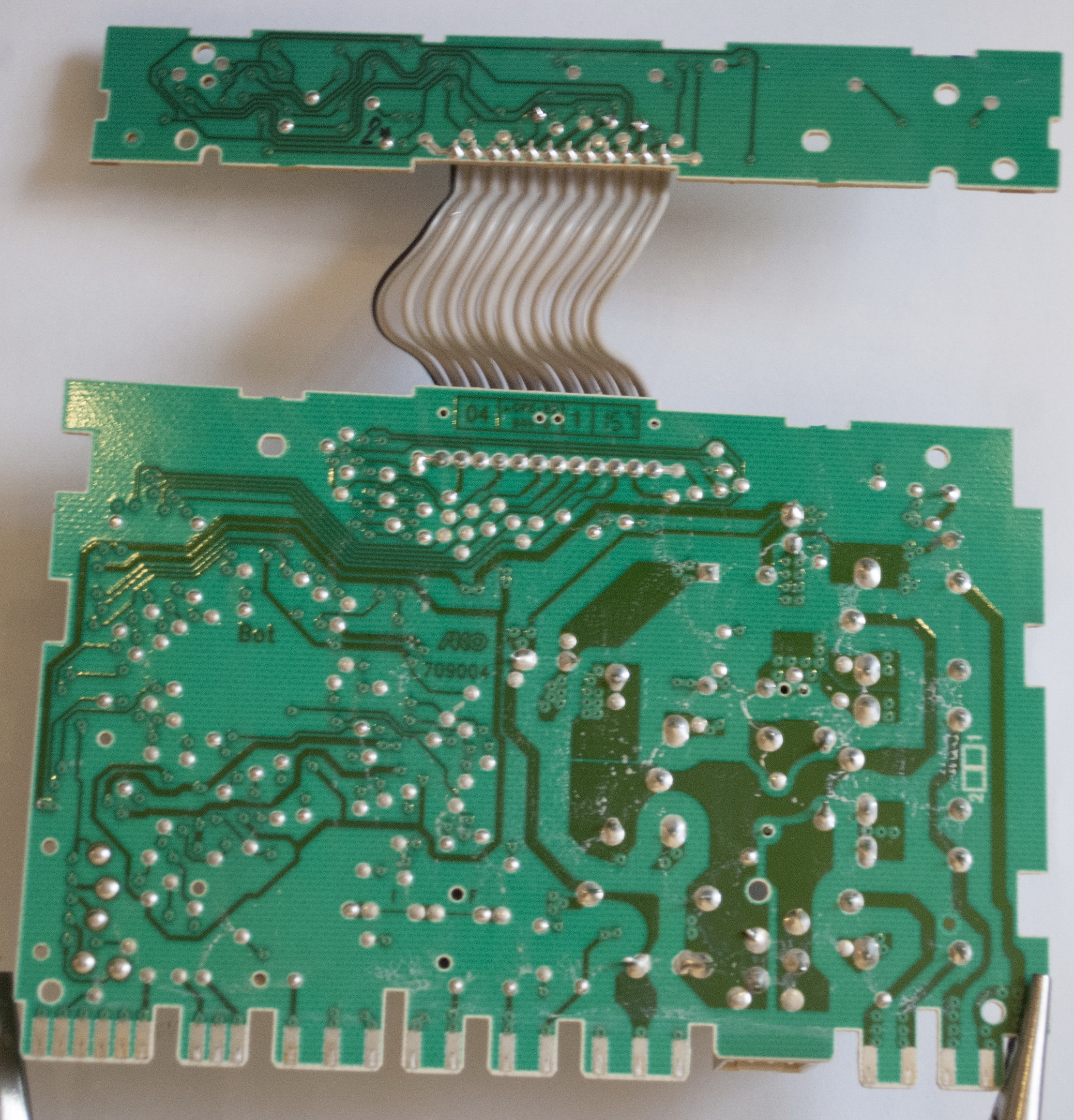

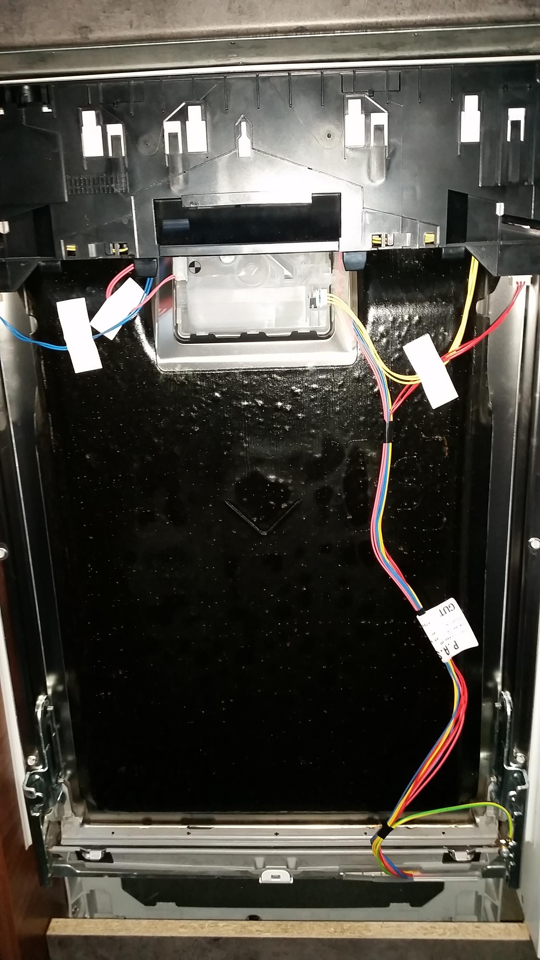

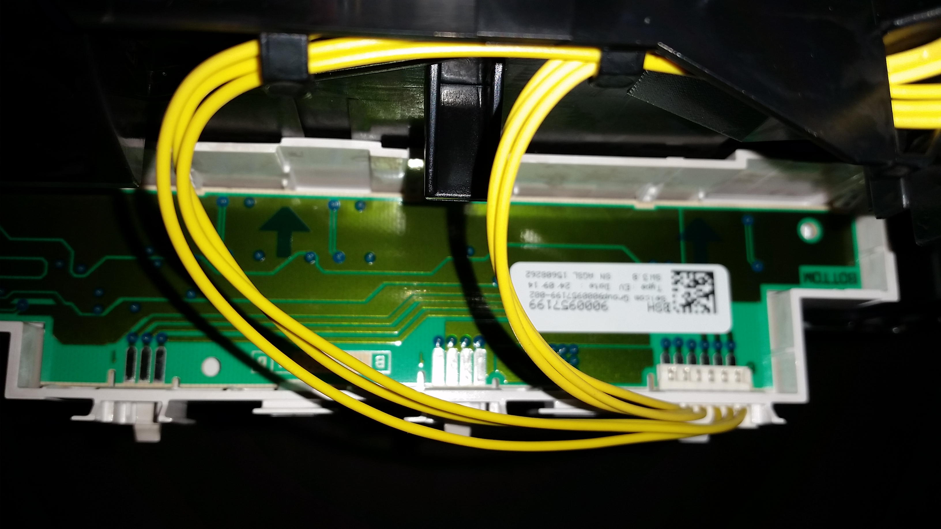

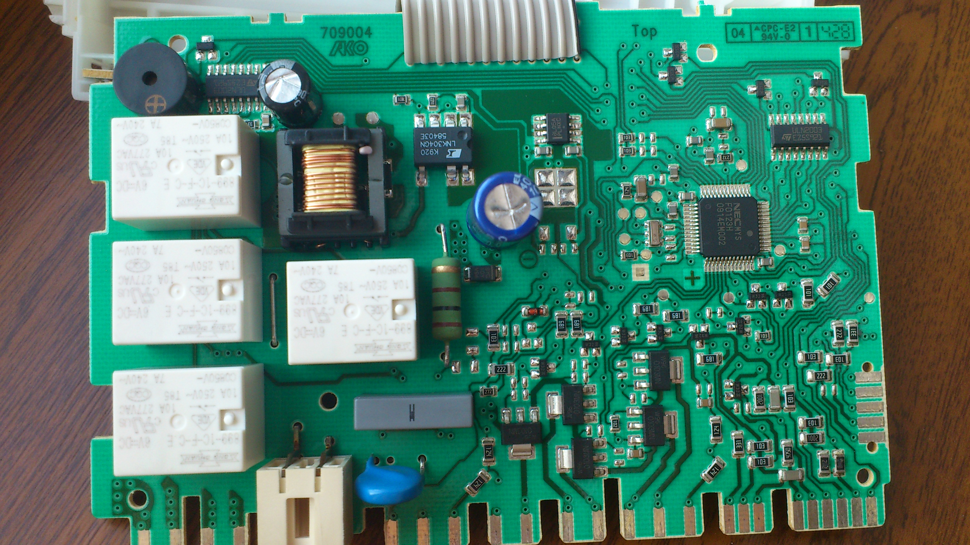

    I have a Bosch SPV50E00 dishwasher and I would like to do an InfoLight for it. Where can I connect? It would be enough to connect one or several LEDs. There are 2 additional outputs on the controller, but I have not found a schematic for what they could be used for.
    Bosch SPV50E00 Dishwasher: InfoLight Installation Guide - Connecting LEDs to Controller Outputs20170118_1..658.jpg (1.31 MB)You must be logged in to download this attachment.
    Possibly where in the course of work you can connect with constant voltage?
    Bosch SPV50E00 Dishwasher: InfoLight Installation Guide - Connecting LEDs to Controller Outputs20170118_1..937.jpg (515.4 kB)You must be logged in to download this attachment.

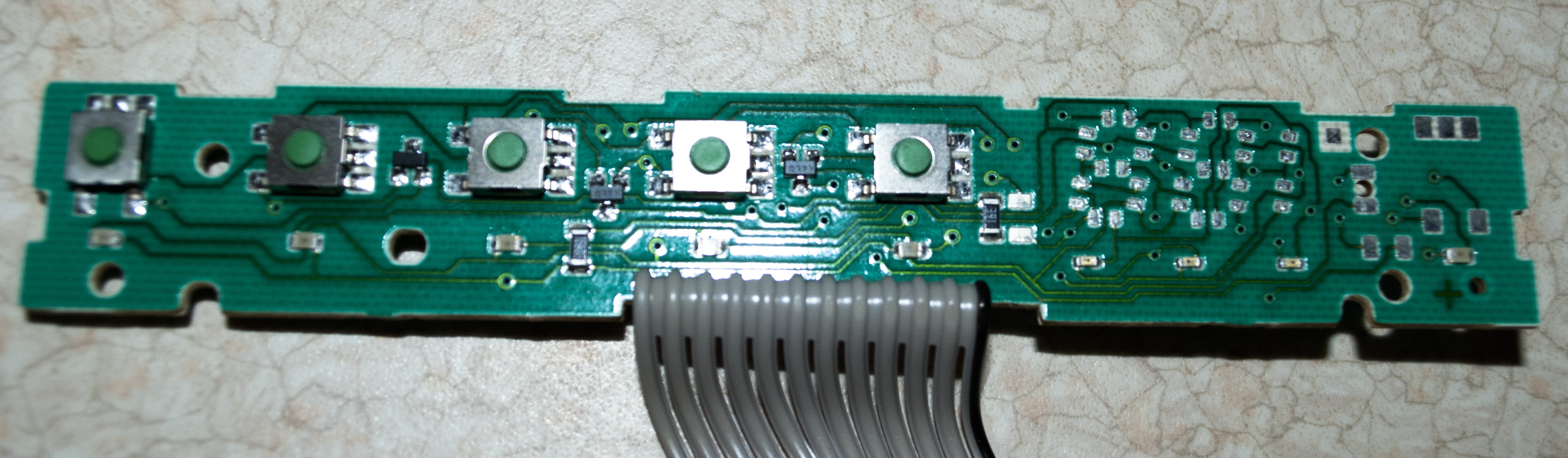

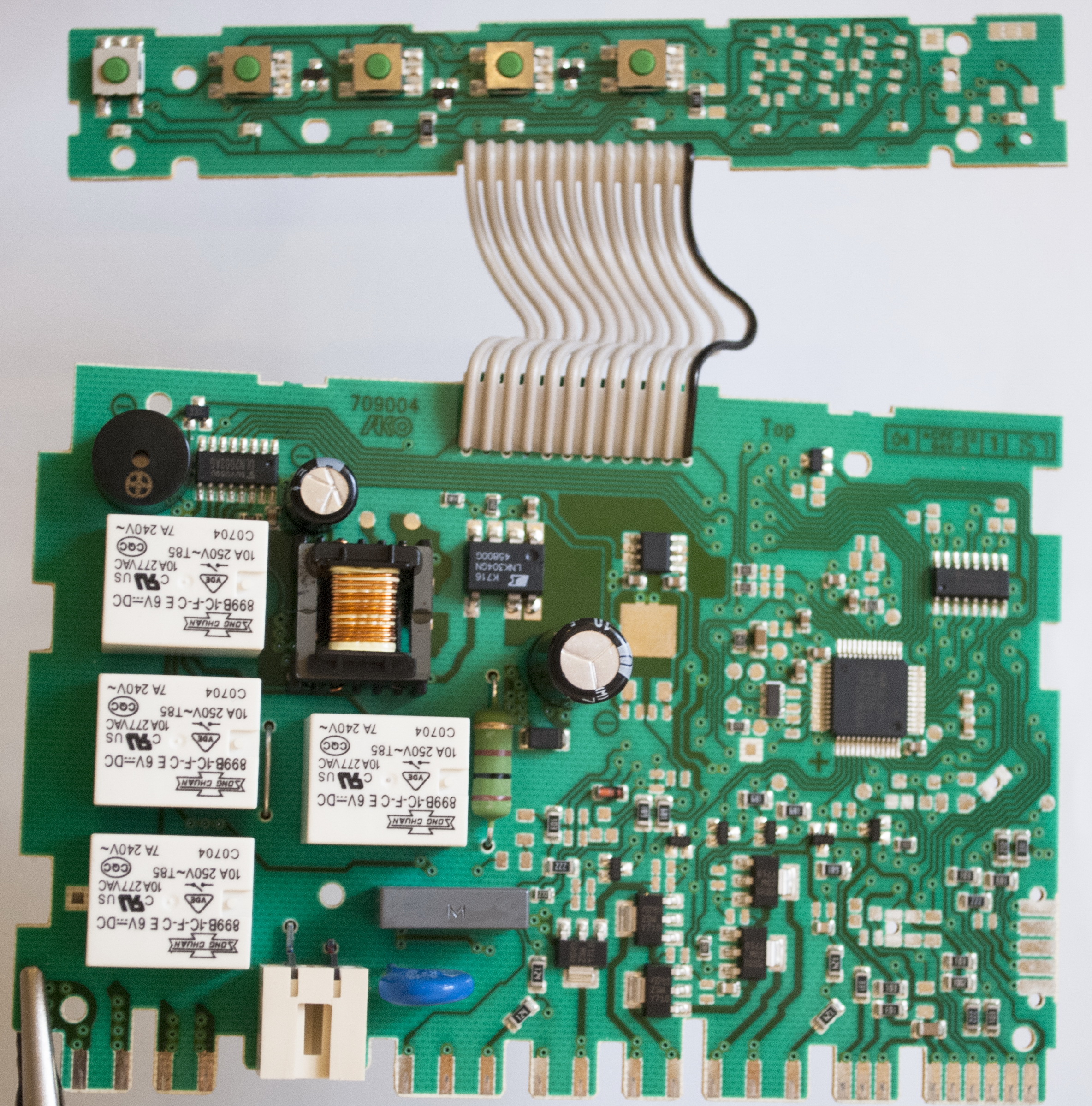

    Let me connect to the subject, although I have another Bosch SRV53M03 dishwasher and I also plan to install InfoLight.
    At first I thought that it would be possible to connect with a small amplifier to the "END" diode signaling the end of the washing and even drew a diagram of the control panel, but the problem arose. The "End" wash-off LED lights only when the door is open, after closing all signaling LEDs go out and there is no signal on the panel.
    Maybe someone knows where you can get the end of washing signal. Below is a diagram of my control panel, unfortunately this is just a diagram of the panel, not the entire programmer.
    greetings
    Bosch SPV50E00 Dishwasher: InfoLight Installation Guide - Connecting LEDs to Controller OutputsSRV53M03 -..nel.jpg (893.82 kB)You must be logged in to download this attachment.

    marion - give a photo of the power module or at least its designations.

    umbur - Unfortunately I will not help you, marion asks for other equipment.

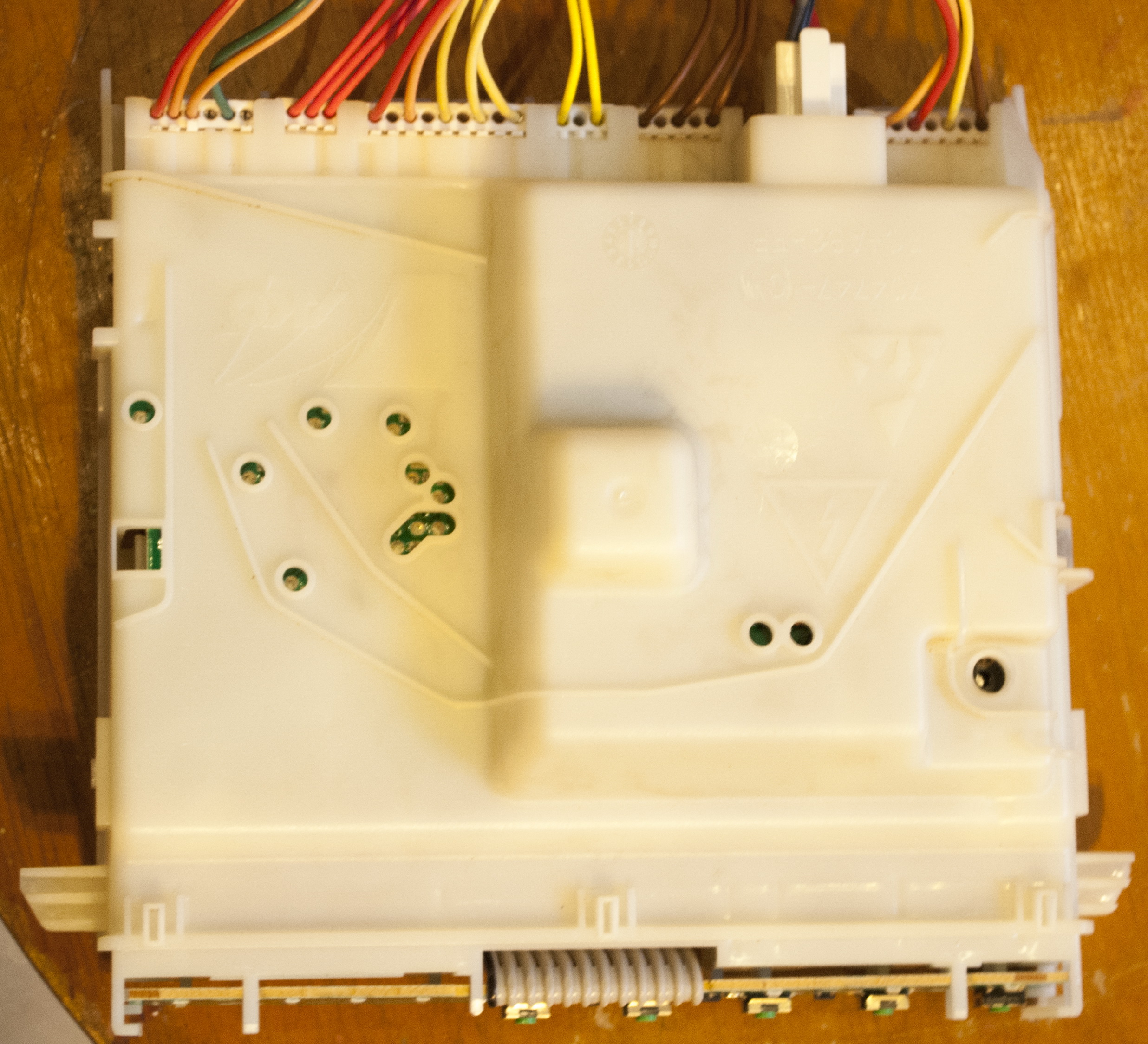

    Loker - I put photos
    Bosch SPV50E00 Dishwasher: InfoLight Installation Guide - Connecting LEDs to Controller Outputs Bosch SPV50E00 Dishwasher: InfoLight Installation Guide - Connecting LEDs to Controller Outputs Bosch SPV50E00 Dishwasher: InfoLight Installation Guide - Connecting LEDs to Controller Outputs Bosch SPV50E00 Dishwasher: InfoLight Installation Guide - Connecting LEDs to Controller Outputs Bosch SPV50E00 Dishwasher: InfoLight Installation Guide - Connecting LEDs to Controller Outputs

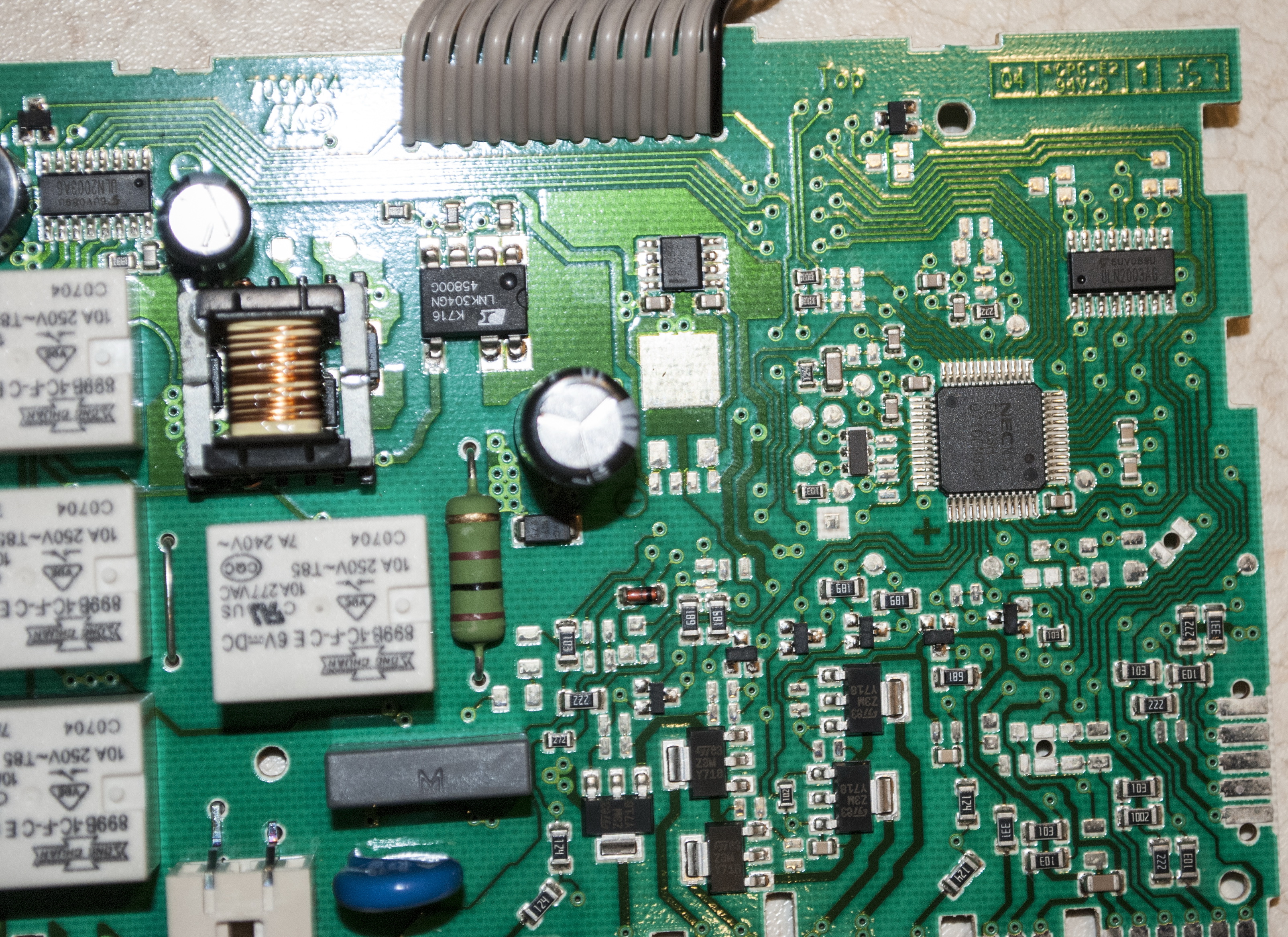

    In this dishwasher there is functionality "Info LED" (which would not mean it). The picture shows that the elements responsible for this are not mounted (blue frame), but there is a chance that the software supports it. Check what is happening on the testpoint marked with a red circle - the state should be high relative to the mass. Just beware during the game because the whole plate is on the potential of the mains.

    I found photos of the SRV-45T63EU dishwasher module on the web - the whole thing looks the same - only the missing ones have that and there is an InfoLight function, and there is also a display. Tonight I will check the status of the poincie test and I will definitely let you know.

    Unfortunately, I do not have any reaction on the testpoint marked with a red circle. Nothing happens at any time during the dishwasher's operation.
    After testing on testpoints, there are no changes at any point marked in yellow, whether during washing or after finishing the washing:
    1 - 0V 2 - 7,80V
    3 - 5V 4 - 2,6V
    5 - 5V 6 - 2.2V
    7 - WEIGHT 8 - 0V
    9 - 5V 10 - 5V
    11 - 0V 12 - 5V
    13 - 5V 14 - WEIGHT
    15 -5V
