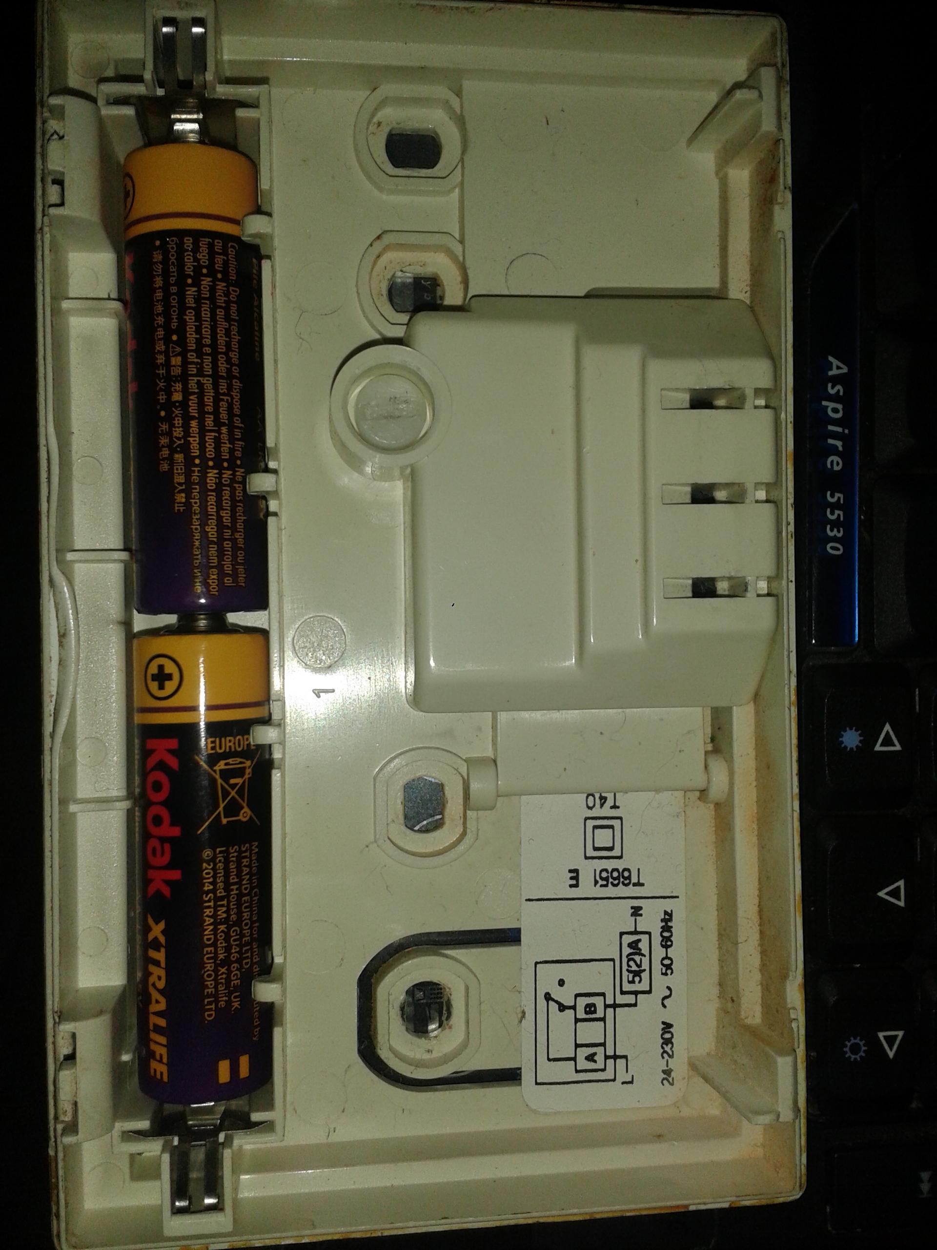

    Hello, I'm new here and I don't know what model it is and how to set the driver for the buderus stove, u004

  • #2 16216193
    antek1cza
    Posts: 1208
    Help: 182
    Rate: 199
    this information should be on the other side of the driver or after opening it.
    after identifying it, there should be no problem finding the instructions.

    Let a colleague spin it (if he can) and take an exact photo of the motherboard, especially the inscriptions printed on it, and post it here on the forum.

    • Setting Up the Driver for Buderus Stove Model U004: A Beginner's Query 20170121_122743.jpg (556.45 KB) You must be logged in to download this attachment.

    • Setting Up the Driver for Buderus Stove Model U004: A Beginner's Query 20170121_123156.jpg (408.5 KB) You must be logged in to download this attachment.

    It is a driver from Honeywell T6651 E CM27.
    Programming instructions (in Polish) and manual (in Czech) below.
    • cm27_montaz_obsluha.pdf (236.73 KB) You must be logged in to download this attachment.
    • CM27-(T6651E1011)_Pol_DTR.pdf (169.84 KB) You must be logged in to download this attachment.

    Hello. Again, how to set it to turn on at a given time and turn off at a given time from this manual, I do not understand anything Help
    how to set it to turn on at a given time and off at a given time
    I am enclosing an instruction which is more accurate than the previous one.
    There are probably problems because a colleague during programming does not change the slider switch (on the left side of the buttons) of work.
    Moreover, the basis for its proper operation is good battery condition + setting the current date, assuming that the technical condition of the programmer itself is good.
    • cm27 T6651E1227-instrukcja_osblugi-pl.pdf (47.85 KB) You must be logged in to download this attachment.
