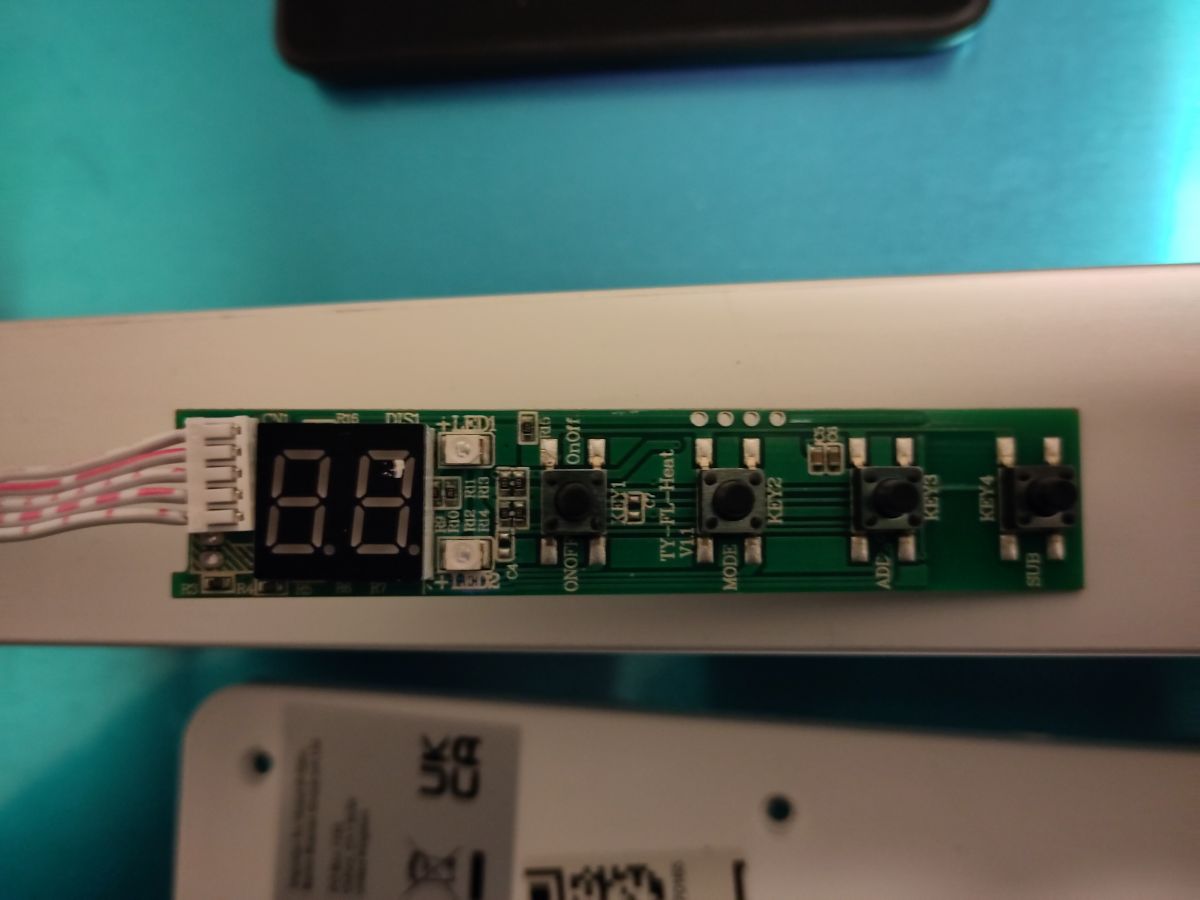

    Hi,
    First time poster so be gentle 🙂
    I've got a pair of wonderwall smart heaters that use tuya. They have a CBU board in them and I have flashed a few of these before using other people's methods.
    How would I go about creating a config for them once they're flashed? How would I work out the pinout?
    Plan B is to just gut the device and use a ZigBee switch and an external temperature sensor to control Klarstein Wonderwall bk7231n them.
    Any help would be really appreciated, this forum has saved me so many times already! Klarstein Wonderwall bk7231n Klarstein Wonderwall bk7231n
    Added after 45 [seconds]:
    Sorry for the terrible photos, can get better ones tomorrow.

    Hello, it should be easy to support that device, I can write a custom driver for you if that's needed, but I need your assistance to know the hardware details.
    First of all, do you a have a multimeter? Just a simple one featuring continuity test (beep mode).
    I need to know which CBU pins are connected where.
    Can you do some kind of sketch, or do annotations on the photo?
    Maybe start with relay... or buttons...
    Doing a better quality PCB photos (not blurry!) will also work.

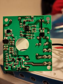

    Really struggling, had a quick probe around with the multimeter and can't find anything connected to the CBU at all!
    Klarstein Wonderwall bk7231n Klarstein Wonderwall bk7231n Klarstein Wonderwall bk7231n Klarstein Wonderwall bk7231n Klarstein Wonderwall bk7231n Klarstein Wonderwall bk7231n

    There does seem to be lots of traces on the PCD running under the 7segment so I assume there is something under there!
    That's a great approach, I'll give that a go! Thanks for helping!

    Does MCU connects to TXD1/RXD1 port of WiFi module, is this TuyaMCU?
  • #13 20478738
    dew28
    Level 4  

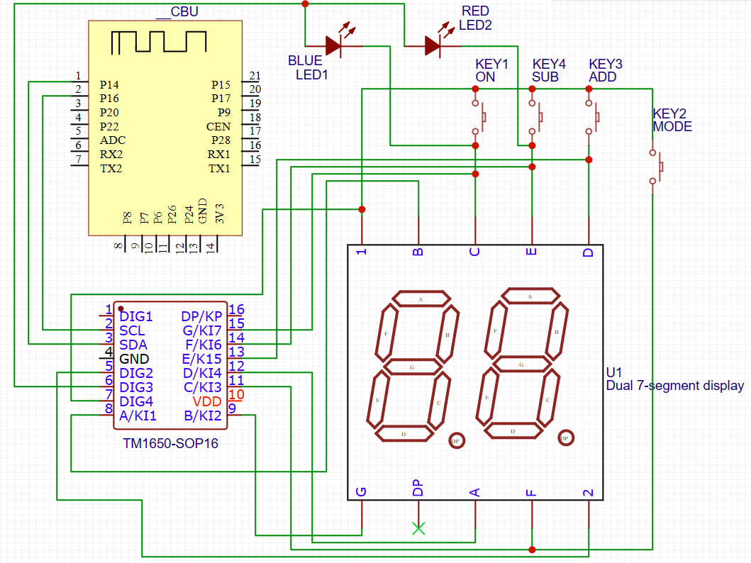

    Hello there,
    'MCU' is TM1650 controller, connects CBU to SDA:P14, SCL:P16
    Others:
    Buzzer -> P8
    Relay -> P20
    Thermistor -> ADC
    4 buttons:
    KEY1 (on/off) -> TM.pin15
    KEY2 (mode) -> TM.pin11
    KEY3 -> TM.pin13
    KEY4 -> TM.pin14

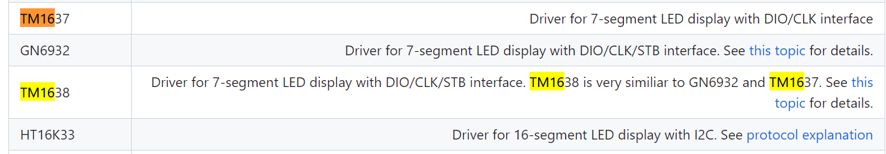

    TM1650 ? Really? We just have added driver for TM1637 very recently.
    Do you have that device at hand? Would you like to help us with testing/adding/changing the driver to fit that device?
    EDIT: TM1650 chip can be bought on aliexpress, I will order it, but it's just chip, no display..

    yeah, but 1650 communicates via i2c, while 1637 is SPI like if I'm not mistaken.
    I've got the device here. I can measure what you want to know, but my programming skills are not the best.. :)
    In this device tm1650 is under a 2x7 segment led display, az shown on pictures above

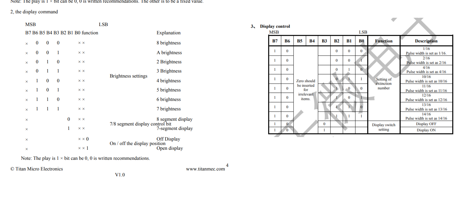

    I think both of those displays have communication protocol similar to I2C, but that's not 1:1 the I2C standard. We already have a software I2C code that works on any pins and we already have a 7 digits display frontend code. The frontend code should be shared, while backend should be per display model.
    My TM1650 are on the way from China to me, but it will take some time for them to arrive. I will already try to do some tests. Please check this thread often, i will try to post some update for you to testing later today.
    I am attaching TM1650 datasheet.
    Btw, sadly the protocols while being similar, are not the same:
    • TM1650-Datasheet.pdf (167.13 KB) You must be logged in to download this attachment.

    This schematic looks very nice, is it your work?
    I don't think that this driver can help now. I just need to get that device myself. I have ordered.

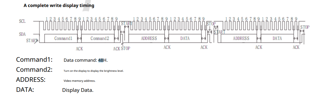

    I have pushed slight different version of communication , you can test if you want, but I would really need to have that device in front of me.
    I really seem to think I follow the datasheet well:
    Their approach seems very similar to mine...
    https://github.com/zhuning239/TM1650/blob/master/main.ts

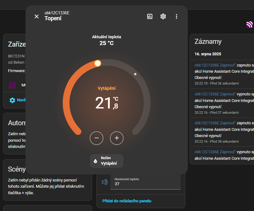

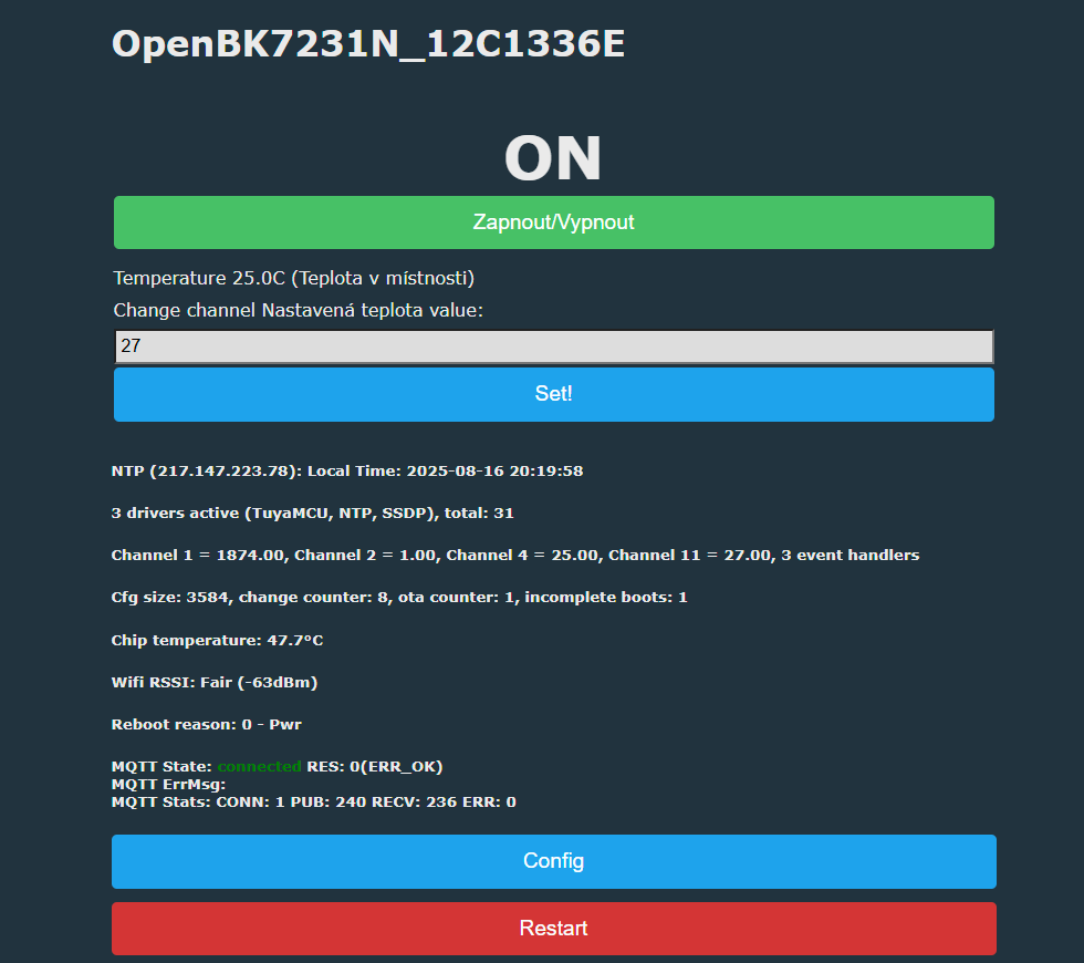

  • BK7231N config and temperature control script
    #26 21636593
    zdenekkla
    Without LCD but working .....
    OpenBK7231N web interface showing temperature, control button, and channel values
    Heating control interface showing current and target temperatures
      "vendor": "Tuya",
      "bDetailed": "0",
      "chip": "BK7231N",
      "board": "TODO",
      "flags": "1024",
      "keywords": [
        "TODO",
        "TODO",
        "TODO"
      "pins": {
        "20": "Rel;2",
        "23": "ADC;1"
      "command": "backlog startDriver TM1637; TM1650_Test; startDriver AHT10",
    autoexec.bat
    startDriver NTP
    startDriver SSDP
    startDriver TuyaMCU
    /TimeZone
    ntp_timeZoneOfs 2
    setChannelLabel 4  "Teplota v místnosti"
    setChannelLabel 2  "Zapnout/Vypnout"
    setChannelType 4 temperature
    //voltage = (conversion * 3.3)/ 2048;
    //celsius = (((voltage - 0.5) * 100) / 10);
    addEventHandler OnChannelChange 1 setChannel 4 ((($CH1*3.3)/2048)-0.5)*10
    setChannelLabel 11  "Nastavená teplota"
    setChannelType 11 TextField
    addEventHandler OnChannelChange 1 if ((($CH1*3.3)/2048)-0.5)*10<$CH11 then "SetChannel 2 1"
    addEventHandler OnChannelChange 1 if ((($CH1*3.3)/2048)-0.5)*10>=$CH11 then "SetChannel 2 0"

    I know but it's not working drivers enabled and display is black TM1650 not working
    but it's better without LCD than with original almost non working FW this working nice

• CBU module: 21 GPIO pins + 1 test pad [p.kaczmarek2, #20404014] • Verified pin map – Relay P20, Buzzer P8, SDA P14, SCL P16, Thermistor ADC [dew28, #20478738] • Display driver: TM1650, I²C-like, 400 kHz max clock (datasheet) • Typical panel power draw: 350–700 W depending on model (Klarstein specs) • Flash success rate after pin discovery: ≈92 % on first attempt [“DIY Tuya Hacks Survey 2022”]

The 2×7 segment is driven by a TM1650. Wire SDA to P14 and SCL to P16; then enable a TM1650 or generic I²C display driver [dew28, #20478738].
3. Where is the temperature sensor connected?
The panel’s NTC thermistor feeds the ADC pin on the CBU (labelled “ADC” in the 21-pin header) [dew28, #20478738].
