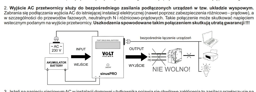

    #10 19643364
    KamilKulewicz
    Hi, the question to the owners of the Volt 2000 SW inverter of the manual is that you can connect only one device due to the reverse current that can damage the device and it is forbidden to connect to the installation with overcurrent circuit breakers, etc. Nevertheless, I prepared for it and hence the question - what to do so as not to kick the inverter. I want to connect to it the light at home on the connectors and sockets to which will be connected crap, such as chargers, laptops, etc. Is there any type of reverse current protection?

    Let's consider ...
    Apart from the fact that the 1A-ampere diode will be damaged under a higher load, it is not why you buy a full sine inverter to straighten the waveform and supply the receivers with such pulsating DC voltage.
    And where does the reverse current come from? Maybe if someone connects the receivers between the L output of the inverter and N from the network installation, the equalizing current will flow. The circuit will close by the AC circuits of the inverter.
  • #16 19644362
    KamilKulewicz
    It is just in the manual (attachment) and I would rather not mess it up, but maybe it's okay ...... turn back
