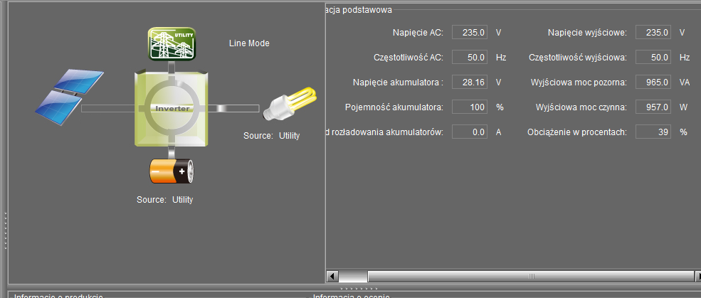

    Tell me if you can, of course, did you measure the current consumption from the battery without load?
    No, I haven't done it yet, but I'm going to check it out.
    • Easun ESB 3kW 24V - opinions and experiences of Off-Grid inverter users sought 1.PNG (77.85 KB) You must be logged in to download this attachment.
    • Easun ESB 3kW 24V - opinions and experiences of Off-Grid inverter users sought 20220102_204118[1].jpg (454.71 KB) You must be logged in to download this attachment.

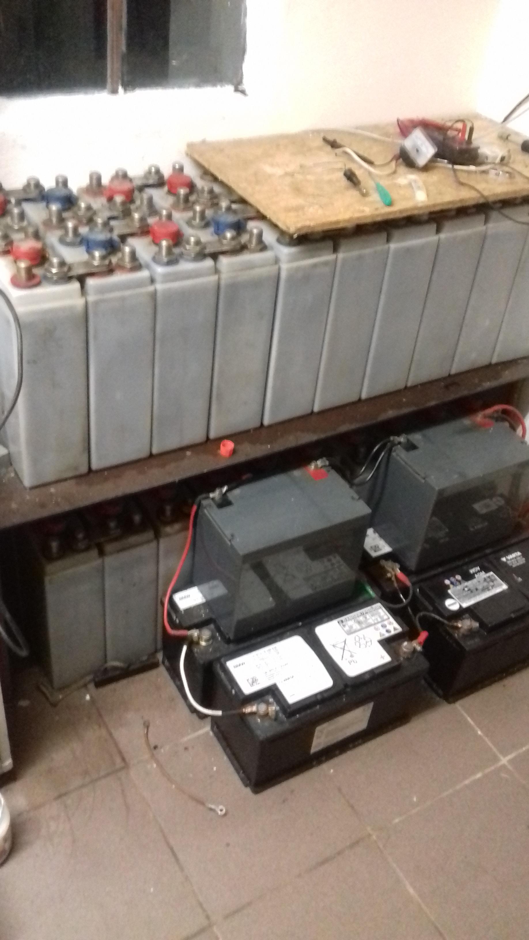

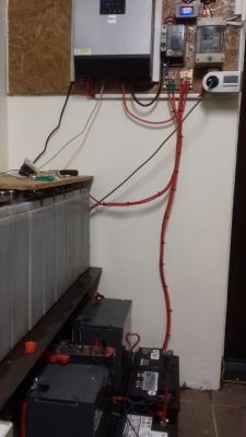

    Everything was measured and connected. AGM and Ni-Cd, nickel-cadmium batteries have been working for 7 years and were connected to the UPS. AGMs from 3-year-old BMWs hold well.
