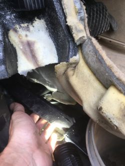

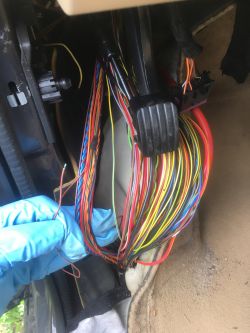

    Touareg 5.0 TDI 05r - No communication with the box, ABS, suspension Which is a bundle, is it this one?
  • #16 19492724
    london2004
    Level 19  
    Posts: 580
    Rate: 392
    I found. Touareg 5.0 TDI 05r - No communication with the box, ABS, suspension

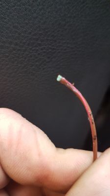

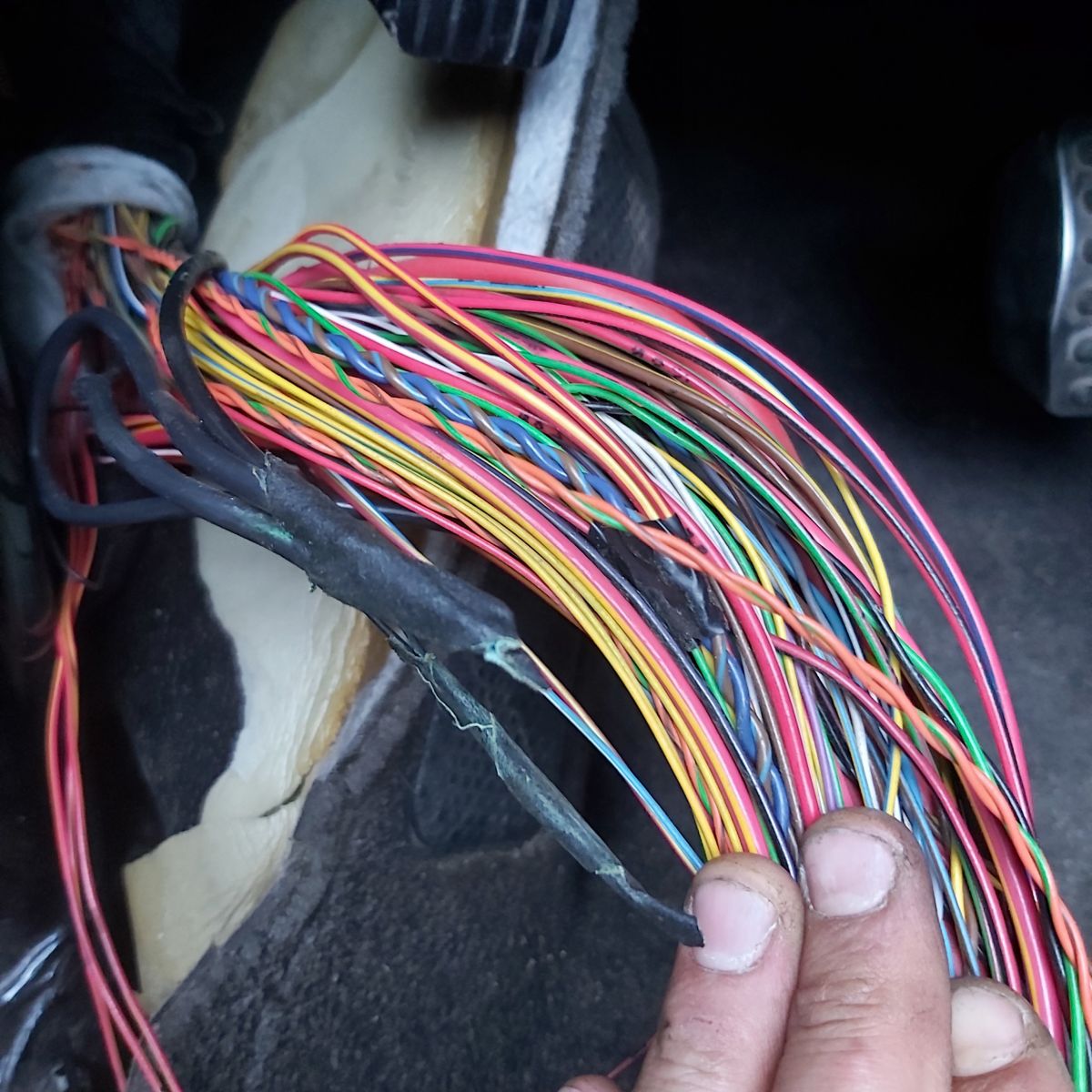

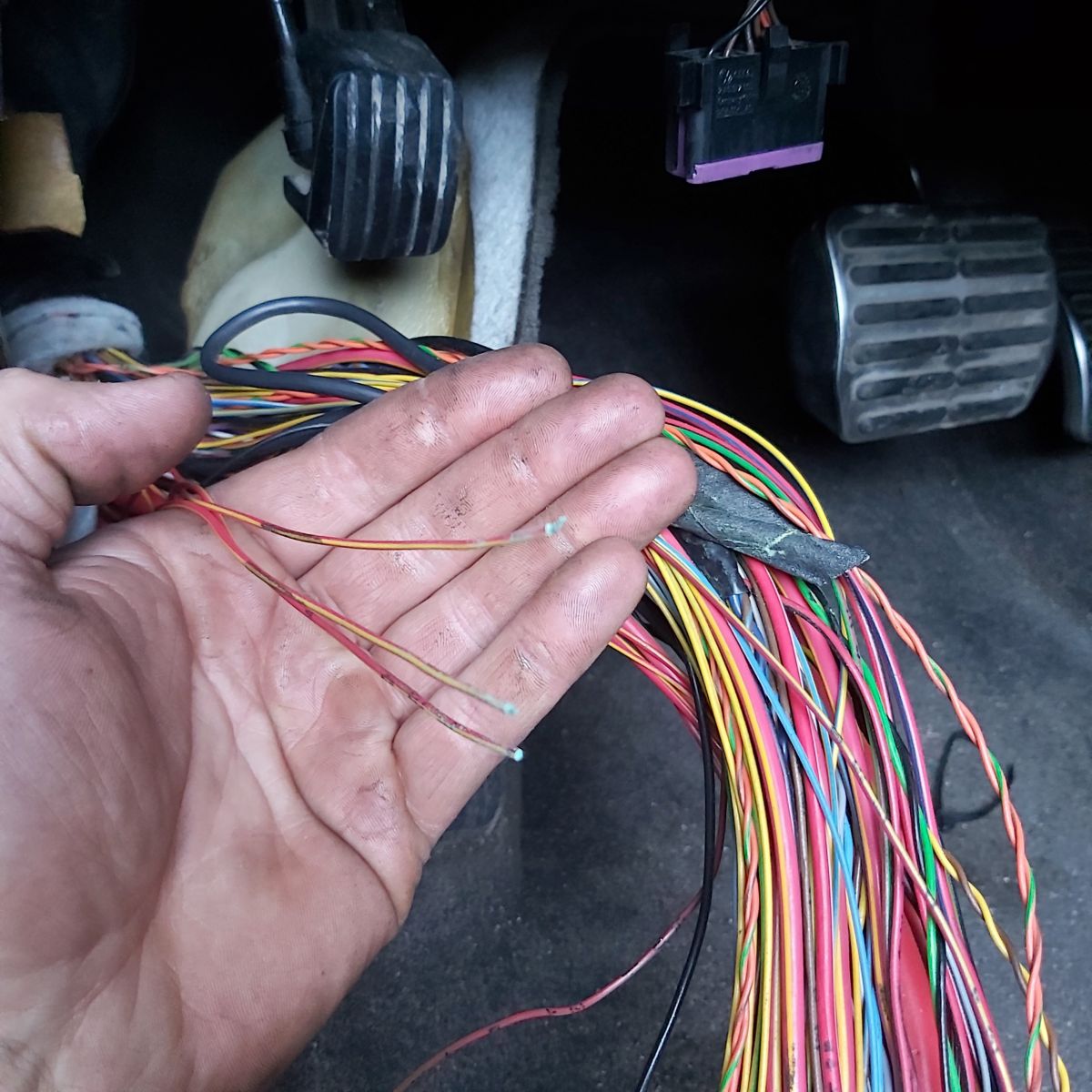

    #17 19636930
    HubertV10TDI
    Gentlemen, or someone will tell you what the other cables are or has a schematic? I have been fighting for a long time, I have a long water and I found this cable on the bundle, but you can see that someone has already cut it off. At the moment the cables are cut and I don't know what to do with what. Touareg 5.0 TDI 05r - No communication with the box, ABS, suspension Touareg 5.0 TDI 05r - No communication with the box, ABS, suspension
  • #18 19637132
    einstein albert
    Posts: 162
    Help: 27
    Rate: 73
    They are not cut open, only oxidized (rotten).
    Connect them all together, look under the insulation shown in the photo (black tape) there will probably be green too. Desire to clean and match colors.
    regards
