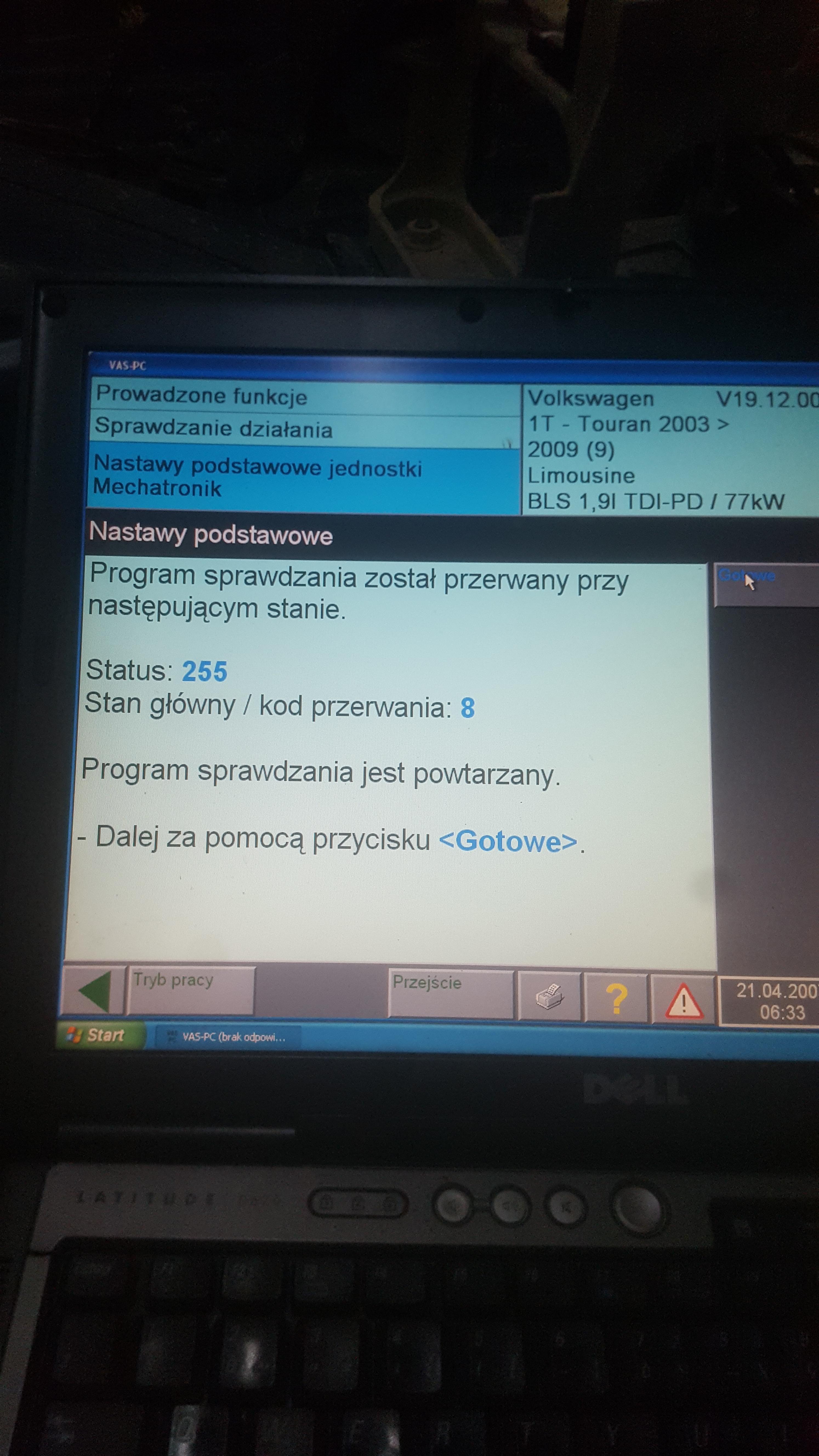

  • #9 16707147
    markus-wielki
    Posts: 459
    Rate: 175
    Oki sockets are there. When I do the basic settings, there is zero reaction silence.
