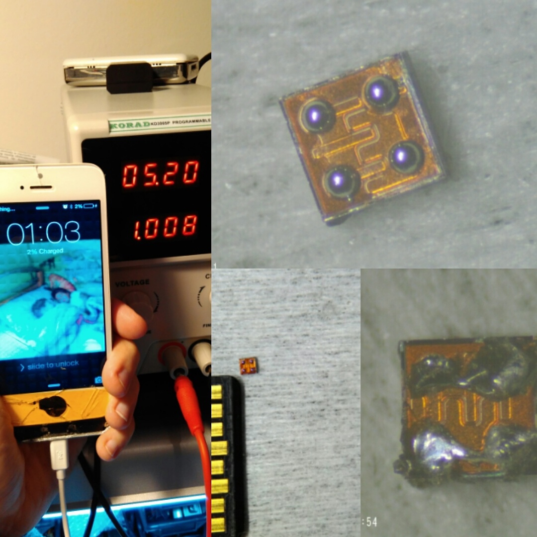

    While the phone is running, the phone is rechargeable. However, when it turns off (discharges), it does not charge carbon. There is zero power consumption, no charging voltage at the battery connector. Doc and battery are ok. Any idea? Could it be U2? Or Q2? Only if Q2 were released, there would be no charging even on the phone on, right? I am asking for some advice, if someone met with it, it is already 3 pcs. This week for the same.
    How do you verify loading? Maybe there is something to it.

    Through a laboratory power supply or a USB meter that is connected to the charger.
    When the battery voltage drops below 3.5-3.3 V, the charger cannot be charged anymore, you need to charge the battery under a power supply with a current limitation.

    Hello! U2 to be replaced and it will be after the problem

    5 pcs. With the same symptom, 4 will return to the world of the living. 1 something else is biting

    You mentioned U2 and Q2 in the latter? Did you give a new battery? What current does the phone draw through the charger? Give the reading of the AC adapter if you plug it in instead of the battery and plug in the charger. What is the electricity consumed by the phone when it is in sleep mode? - power supply as a battery.

    U2 replaced new battery. Under the power supply, it normally starts, while the charger is connected, the power consumption on the charger is close to zero (exactly 0.01 A), without the power supply on the battery, the same power consumption on the charger. After losing the voltage on the power supply, the current consumption on the carbon charger. does not change. Q2 not exchanged.

    Replace Q2 or make a jumper temporarily and see if it will be ok, sometimes Q2 does not charge either.

    Gentlemen, art (iphone 5c) that does not charge carbon on the turned on or off phone. zero current consumption, focus more on Q2 or U2. previous post helped problem solved.

    It would be good if you could verify the current consumption of the motherboard, U2 fault (Tristar) can be diagnosed by the overcurrent consumption, specifying the exact cause.
