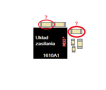

    After carefully looking at the disc under the microscope, I saw that there are two components missing (resistors?) Next to the A1 (power supply) system. As I do not have a CD scheme, I ask on the forum: what are the elements and what can be replaced with them (eg jumper)? Can the phone fail to behave incorrectly due to shortages of these elements? In the attachment I am suggesting how the layout of these elements around the system looks like.

    The scheme is available on google ;) At home I do not have ZXW, I will not show you exact values. Do not call anything because you blow it up.
    Replacing the battery, you can see it had a problem (bootloop?) Just from it (gets up on the power from the charger and turns off because there is no power (power) from the battery.
    This can break the file system in NAND.
