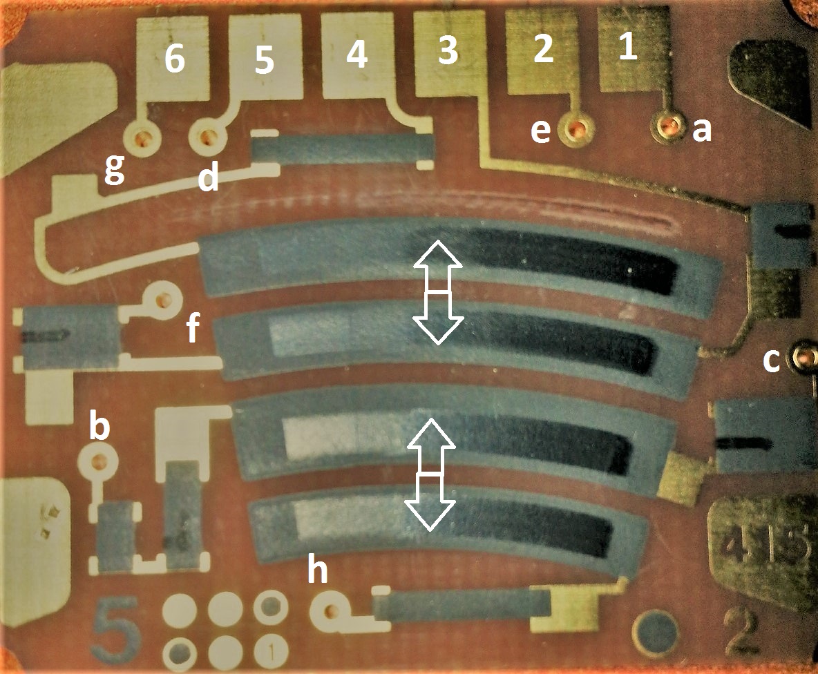

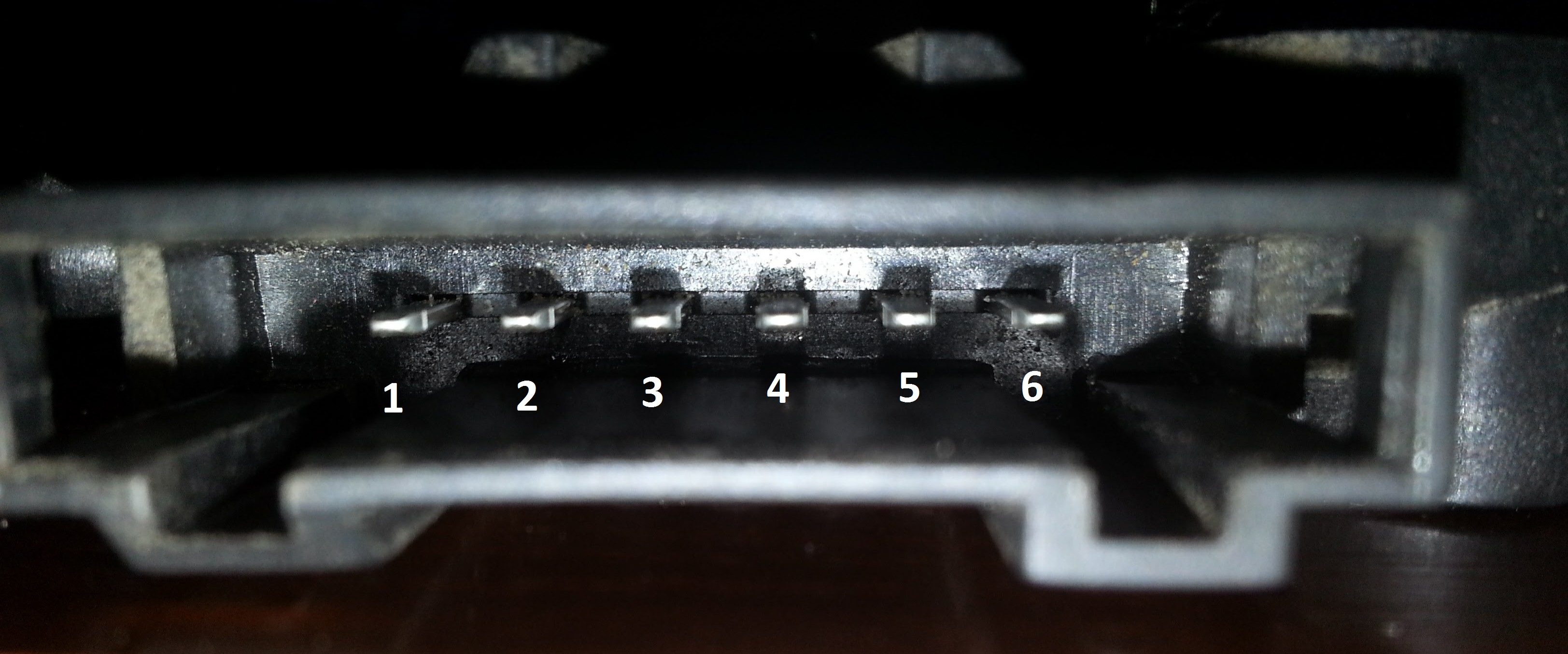

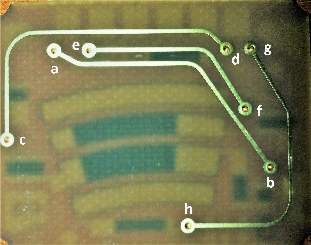

    polix0
    Posts: 11
    Fiat Ducato 244; 2.3 JTD; 2006 - Emergency mode, 1500 revs, does not respond to IMG_201702...111952.jpg (649.96 kB)You must be logged in to download this attachment.
    Which pins should I check for ankle tension?
    Fiat Ducato 244; 2.3 JTD; 2006 - Emergency mode, 1500 revs, does not respond to IMG_201702...111442.jpg (327.37 kB)You must be logged in to download this attachment.
    Fiat Ducato 244; 2.3 JTD; 2006 - Emergency mode, 1500 revs, does not respond to IMG_201702...111714.jpg (389.56 kB)You must be logged in to download this attachment.
    It turns out that three pins are walking on the paths.

  • #15 16265837
    grala1
    VAG group specialist
    Posts: 9823
    Help: 1495
    Rate: 5052
    These second measurements are correct.
    Now connect the accelerator pedal, press it and measure again just like the second measurement, i.e. to the ground.
    Measure the resistance on the pedal when the plug is disconnected.
    Measure between
    6-1
    4-2
    6-5
    4-3
    Press the pedal and see if it changes nicely between 6-5 and between 4-3.

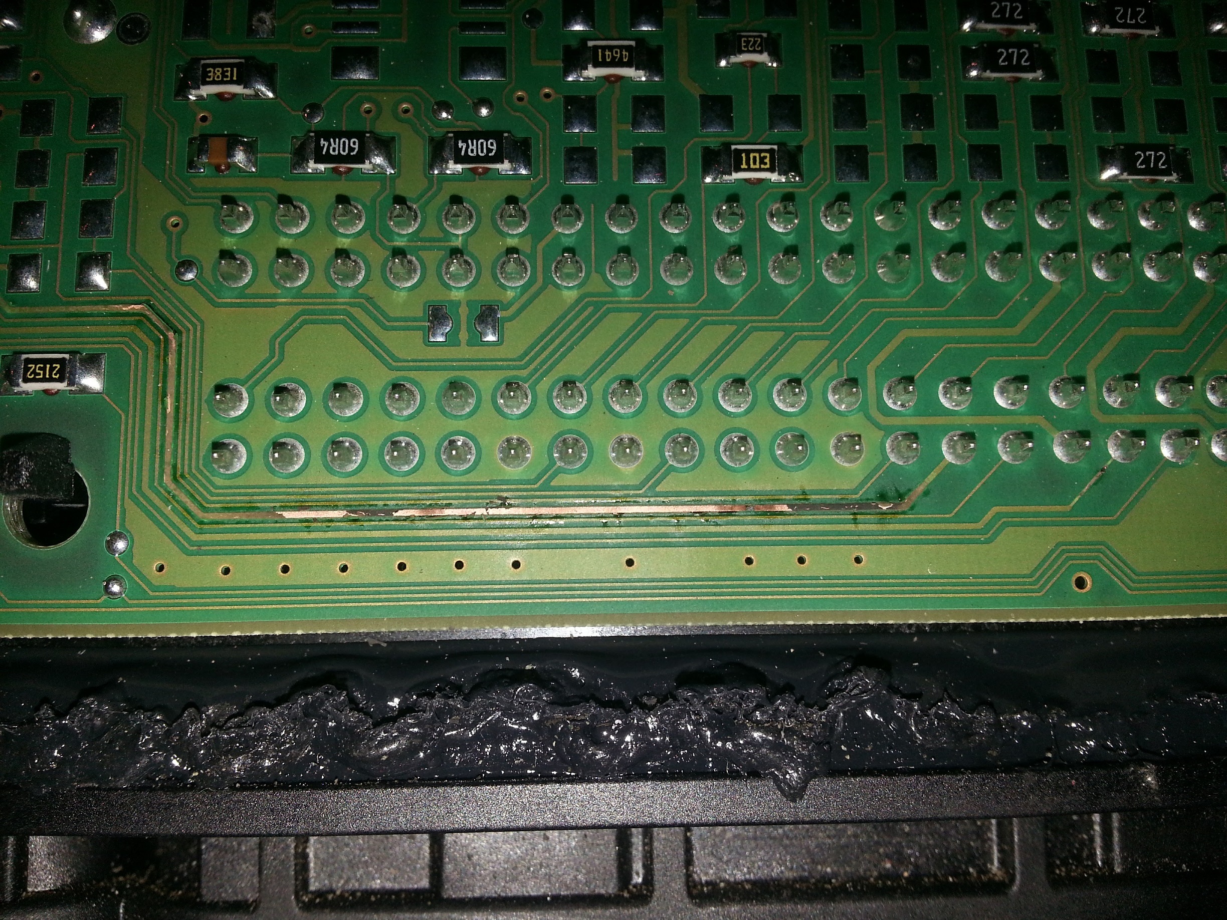

    #16 16288759
    polix0
    Posts: 11
    I connected both pedals to the ankle and after connecting the second cable to ground, it showed approx. 4.9V on all inputs / outputs
    I measured the resistance on the pedals and it changed nicely everywhere
    I was at a car electrician, he had a pedal from another car with the same entrance. Same situation, identical errors.
    He didn't want to take the car to the workshop.
    I decided to spin the computer and it turned out that one of the paths on the board has burned out.
    Fiat Ducato 244; 2.3 JTD; 2006 - Emergency mode, 1500 revs, does not respond to IMG_201702...205128.jpg (1.75 MB)You must be logged in to download this attachment.
    Fiat Ducato 244; 2.3 JTD; 2006 - Emergency mode, 1500 revs, does not respond to IMG_201702...205148.jpg (1.87 MB)You must be logged in to download this attachment.
    A friend of electronics soldered a wire shortly to work around the path and now everything is fine.
    The car is functional and responds nicely to gas.
