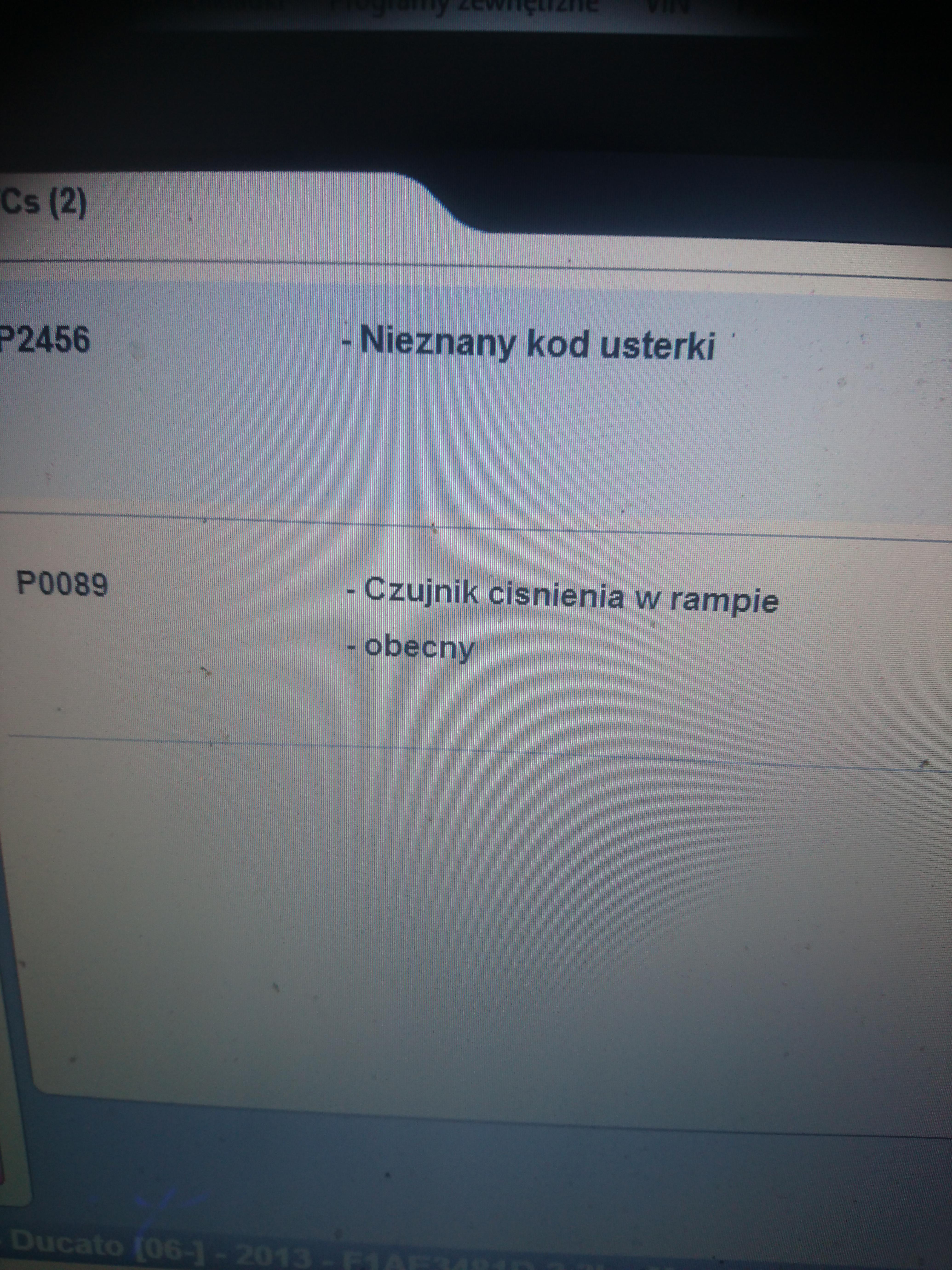

    Now, after driving about 500 km since buying the car, it is impossible to drive normally. No power . The message "check engine" is displayed all the time.
    The errors are:
    After clearing the error pops up almost immediately.

    according to AD P2456 - dpf exhaust gas pressure sensor, electric circuit.

    What is the pressure on the CR rail that the ECU sees?
    There may be a problem with the CR pump or with the wiring, rarely with the sensor itself.
    P2456 is a problem with the DPF differential pressure sensor.
    Usually filter clogging.
    The sensor could have died, the beams were wiped, the tubes from the sensor to the DPF were clogged.
    The DPF is supposedly cut ... So he should not report it at all if the soft ECU is reworked correctly.
    You have purchased an interesting car...
    I would start with the regeneration of the injections, because they are in very bad condition looking at the transfers. And not one but all. At least submit them all for thorough verification. Because adjustments by what and transfers (although not as different as with you) are a bit relative. And the failed injections will sooner or later drive you into huge engine overhaul costs.
    How long they are dead is unknown. But probably a long time. Hence the DPF cut because it was constantly clogged. If you give him a blowtorch while driving, you don't drag a black cloud behind you? ;)
    In the meantime, he carefully checked the bundles. ECU-engine (mainly abrasions in the tray on the engine), but also fuses-ECU to be sure. These are their sensitive points.
    Then I would give the ECU to someone trusted who will convert the soft to DPF OFF correctly.
    Unfortunately, a few zlotys will be ... Even more than a few.
    You will do as you like...
    And I wouldn't run on fuel for cutters... Maybe the camera is lying, maybe my monitor... But some kind of blue oil ;)
