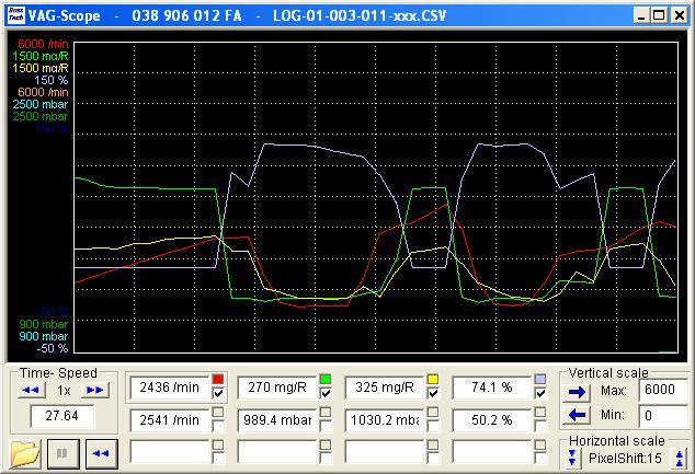

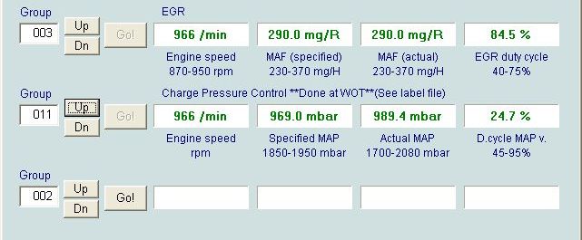

    I took a screenshot and added as an attachment.
    MAF (specified) - 290.0
    MAF (measured) - 290
    RPM - 966
    EGR Duty CYCLE 84,5%
    Regarding air flow:
    on a cold engine because I did not get warm by driving to work.
    2988RPM, 1897 plotted, measured 1009,
    the second attached file
    reading the codes gave such a cass:
    17664 - Engine Coolant Temp Sensor (G62): Open or Short to Plus
    P1256 - 35-10 - - - Intermittent
    17964 - Shareware Version. To Decode all DTCs
    P1556 - 35-00 - Please Register / Activate

  • #9 16228966
    tom_bart1
    Posts: 99
    Help: 5
    Rate: 46
    If you have flooded an ordinary ON, check / replace the fuel filter.
  • #10 16228994
    robokop
    Posts: 29412
    Help: 1763
    Rate: 6373
    P1556 - does not load a turbine. EGR inlet / open hole / N75 valve defective. We'll find out in the end what this engine is?
