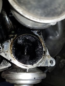

    1. Power drop, check engine and after a few km total power drop - the mechanic diagnosed a damaged turbine. They regenerated and power returned for a month.
    2. After a month, again check engine and a decrease in power, I returned to the turbine mechanics, they kept the car for a week, checked the turbo, eliminated the N75 valve, cleaned the EGR - it did nothing, they sent me to an electromechanic. Additionally, sometimes when driving or stopping on a fired engine you can feel the exhaust fumes inside the car
    3. The electromechanic replaced the bundle of cables and the power returned ... for two weeks. I returned to the electromechanic who said that this time it is an EGR failure and it needs to be replaced, the logs show the failures of the exhaust gas recirculation system. He checked the tightness of the hoses, blinded the vacuum hose and ordered to replace the EGR. Unfortunately, the car still has no power, in low gears it accelerates as normal, the turbo switches on, above, unfortunately, no power.
    4. I unscrewed the EGR today and of course it has never been cleaned, it is saggy and locked in a closed position so it probably has no effect on engine power. I suspect that the vacuum pump is damaged and gives too low a vacuum, the connector is slightly loose, maybe there is a way to seal it without dismantling the pump?
    Below the pump connector:

    At the beginning check the vacuum pressure of the tandem pump and 0.7 bar at all outlets of the vacuum hoses.

  • #4 17052382
    macoss
    Posts: 29
    I gave the car to another mechanic, it turned out that the vacuum pump was all right, EGR to be replaced - it could not be regenerated, the mechanic diagnosed a problem with the camshaft sensor that caused the engine to go into service mode.

  • #6 17121906
    macoss
    Posts: 29
    Summarizing:
    1. The fuel pump disassembled and cleaned did not affect the lack of power, just a coincidence. You can do it yourself, nothing difficult.
    2. Turbine returned under warranty after regeneration, dismantled, cleaned and adjusted again. In addition, a leak was found in the tube exiting the turbine to the EGR. The tube replaced but it still did not solve the problem.
    3. Replacement set of vacuum control valves which finally solved the turbine disconnection problem.
