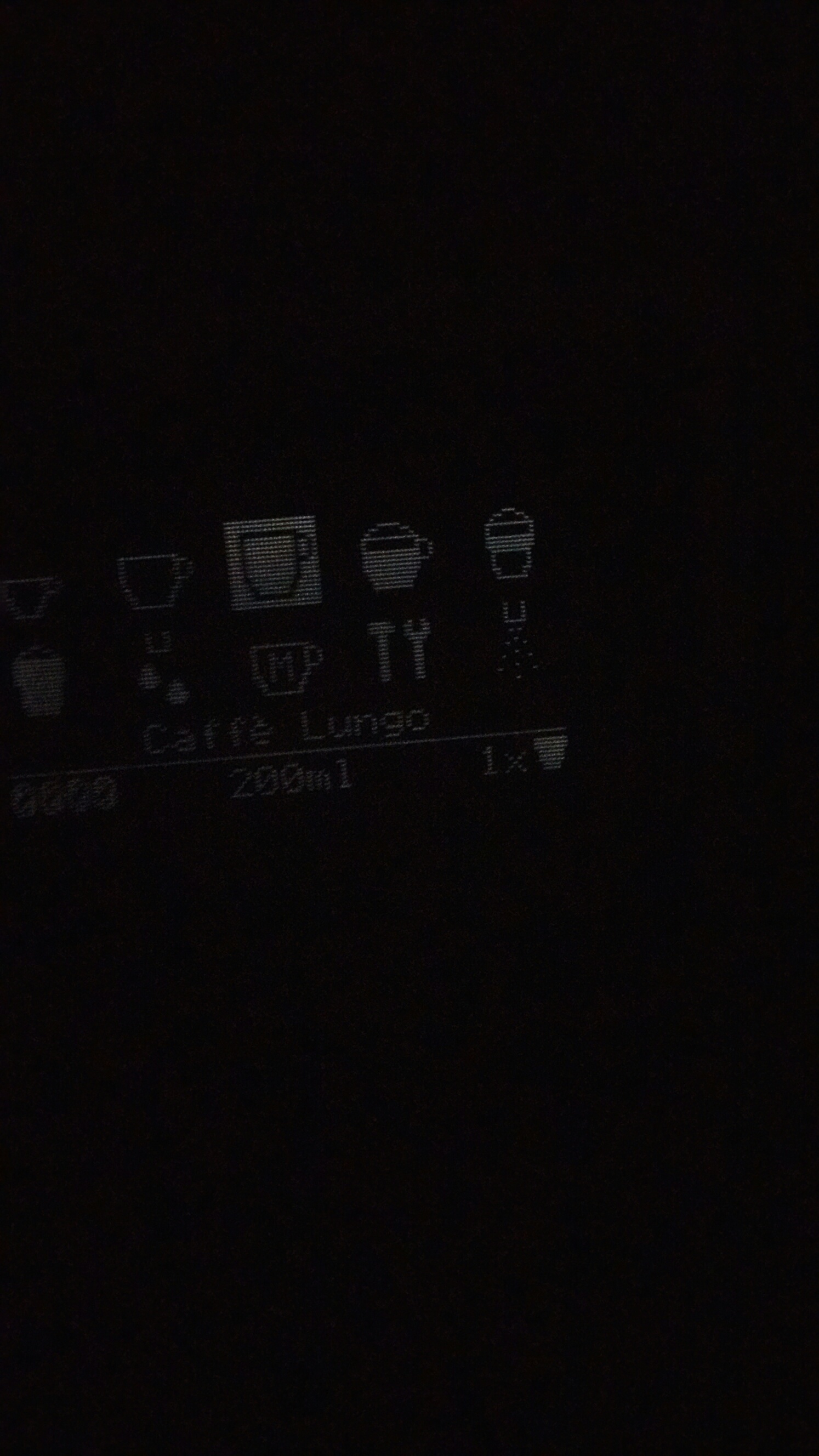

    Good day.
    I have had a coffee machine for some time and everything has been ok. For several days the letters on the display in normal light are invisible. In the dark or in the evening you can see quite well. Anyone know whether it is a matter of changing the display or maybe some backlight diode? Where in Warsaw or in the area to fix it so that it does not drain the pocket because it is under warranty))

    It's hard to tell by the description itself, a clear picture would say a lot more ;)
    Display prices usually slow down, so it's worth trying to resuscitate.
    Maybe it is enough to improve the February display, maybe it was just the diode that fell.
    Naturally, I can only recommend my website :)
    But seriously, whatever you choose, please avoid authorized services that only replace the main modules, because they actually have such a top-down order from manufacturers and I suspect that replacing the entire display module will exceed half the value of the machine ..

    This is how it looks in total darkness. In daylight, even an obscure does nothing ... I see that it is very close to me (Piasts). What can be the approximate cost of repair?

    Did you manage to do something about this display? The same problem met me, the display was getting darker and darker and I could see nothing after about a month. The display is unfortunately with the entire control panel, the cost of repair at an authorized service PLN 950.

    Unfortunately, my personal attempt at resuscitation ended in failure.
    The manufacturer used amoled displays here, which generate backlight themselves.
    At stake is only the replacement of the display and that this is a typical invention of the manufacturer of replacements for the same displays on the market.
    Kawa i Naprawa - Serwis AGD
    Powstańców Śląskich 63, Warszawa, 01-355 | Company Website: https://www.kawainaprawa.eu
  • Display replacement costs about 1000 PLN
