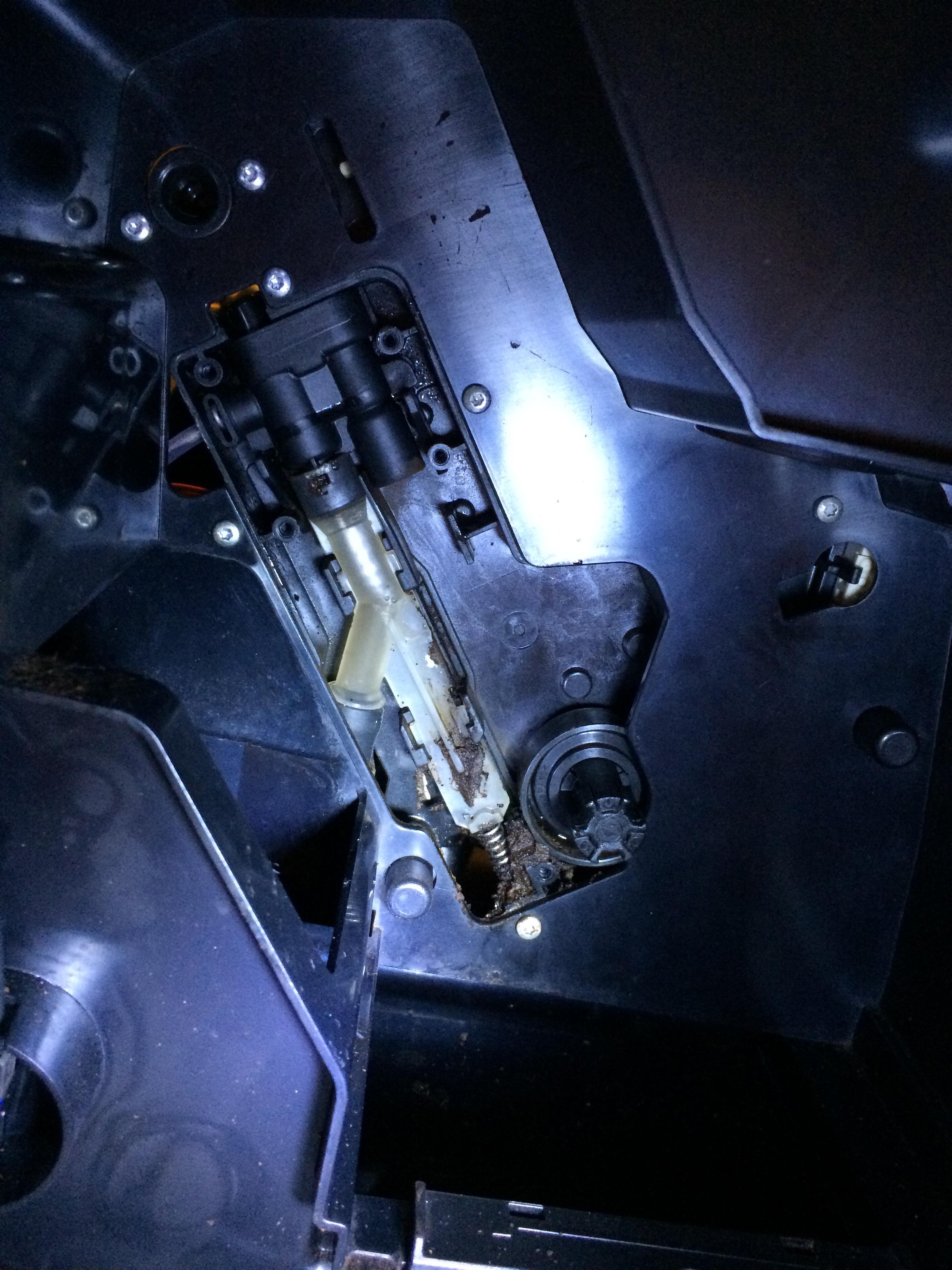

    After observing, I think the drain valve is fine. Nothing is leaking.
    I don't know where it is coming from - definitely not from the brewer. The rest is built-in with nothing visible when the machine is working.
    Thank you very much for your help and answers to my problem. You must, however, look for a website.

    Although I do not see the operation of the machine, after removing it, I see that the drainage valve is in a terrible condition ...
    elimination of leakage from the espresso machine, however, forces you to unscrew the casing, it is difficult to locate any fault without it

    I unscrewed the whole case. I can't locate the leak. I can only see that the rinse water is poured into the condensate tank. After removing the brew unit quickly, no leakage can be seen anywhere.
    If I may ask - how do you know that he is in a terrible condition? I cleaned the remnants of coffee that were there and is now like new - of course from the outside. so what can be broken? I look at the upper plastic and lower rubber part and everything looks correct ...
    Yes, it's true, I got a job in the USA and took the espresso machine with me, Well, I will try to take it to my suitcase, properly protecting clothes, foams, etc.
    I found a service in Miami near me, authorized saeco but I don't know if it makes sense. It is true that I can order this part from Germany through eBay but how to properly spin and replace. That is the question ... Besides, if I can transport it to Poland, I will replace the seals, etc. and use it for the next 8 years.

    This valve has a certain operating time, it is an operating element that can withstand a certain number of coffees and can be replaced .. I determined its consumption based on sealed coffee ..
    It does not accumulate after two three coffees .. Such a valve lasts on average about 5 years.
    Naturally, I do not recommend replacing it for those who do not have a DIY knack, because although theoretically it is very easy to replace it, but every few days I receive express after trying to replace the valve and although I am surprised by the damage is unbelievably much ...

    Thanks again for the answers. I attach a photo of how it looks after cleaning. I note that after the initial flushing of the system there is no leak in this place.
