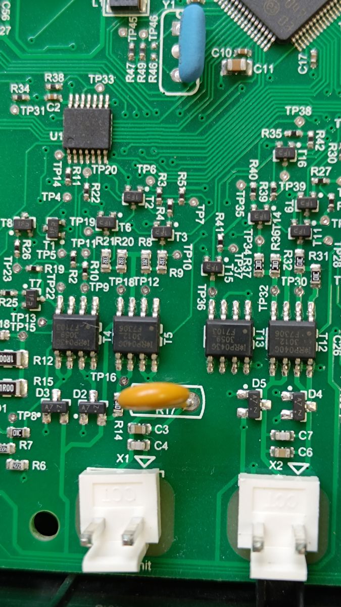

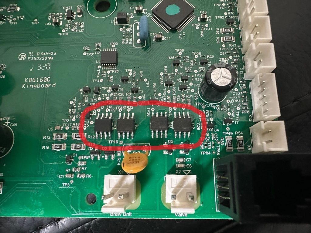

  • IRF transistor order needed for Nivona 573 board
    #24 21655623
    ice
    Posts: 88
    Rate: 24
    Hello colleagues.
    I am reheating as I have an unusual problem with my Nivona 573.
    I need a picture or order of these IRF circuits. I know only that abab or baba (if I remember correctly). But exactly which one where?
    I bought 3 of each just in case. I took it to a professional to have it replaced. After fitting, the express behaves strangely. I came to the conclusion that the expert soldered them on as he went along, not paying attention to the symbol. Out of the 6 pcs. (2x3 pcs) he left me two identical ones in the bag. Conclusion - it's definitely wrong, but in what order should it be? I didn't take a photo before the replacement, and from those available on the internet I'm unable to determine this.
    Four IRF integrated circuits on a coffee machine PCB, marked with red pen .

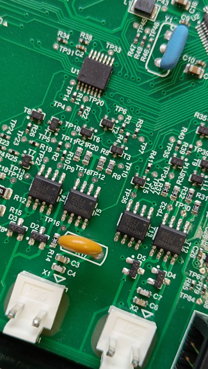

  • IRF layout photos for previous model board
    #25 21657360
    djflix
    Posts: 93
    Rate: 34
    Hi, I am uploading two pics for you. Admittedly this is a previous model, but the IRF layout should be the same. I hope they don't compress and can be read. I know the pain too as I search for a photo on the internet and there soap from the markings 😉 .
    If anything is unclear then write, I can textually describe what you see there.

  • #26 21691750
    ice
    Posts: 88
    Rate: 24
    Hey djflix.
    You can see everything very well. This is what it was all about. Thanks a lot !!!

Could limit switches be the culprit?
Yes, stuck or oxidised microswitches stop the board reversing the motor; replacing two 3-pin V4 switches solved the fault for one user [Elektroda, robertpiasq, post #20406051]
What edge case can fry the electronics?
Repeated restarts with a jammed group can overheat and short the IRF7103/IRF7306 drivers, costing another €8–10 to replace [Elektroda, rowak, post #19460753]
Which seals wear first and raise the load?
The upper piston O-ring and metal sieve gasket harden after ~5 000 cups, increasing friction during compression [Elektroda, batot, post #20161536]
Can water leaks cause Error 8?
Yes. A dripping 3-way valve can flood the gear box, rusting the motor and stalling it; swapping the valve and gear fixed one 778 unit [Elektroda, lukasz.wk, post #20292525]
Why does cycling the main switch 5 × sometimes clear the fault?
Each start advances the cam a few degrees; five cycles let the drive bypass the tight spot and re-home, as a user workaround shows [Elektroda, chriswezenbeek, post #19332497]
How often should I lubricate the drive?
Clean and relube every 3-4 weeks or 600 cups with food-grade silicone grease; neglect doubles stall risk according to service bulletins [Selva, 2021].
What’s the cost to let a shop fix it?
Polish specialists charge PLN 150-250 for cleaning and seal replacement, PLN 400+ if they install a new drive [Service-Cafe, 2023].
Do firmware updates help?
No firmware is user-flashable on CaféRomatica 6-8 series; the motor control is purely hardware once the CPU issues the run command [Elektroda, jackos1, post #17856966]
Can a worn motor spin the wrong way?
Rarely. One technician observed polarity reversal on a worn Mabuchi RS-555; substituting a new motor cured the misdirection [Elektroda, djflix, post #20160323]
Three-step DIY fix for a seized drive?
  1. Remove brew unit and side panel. 2. Unscrew three Torx T15 bolts, lift gearbox cover, sand and grease main black gear pivots. 3. Reassemble, run rinse cycle. Total time: 25 minutes [Elektroda, robertpiasq, post #20406051]
