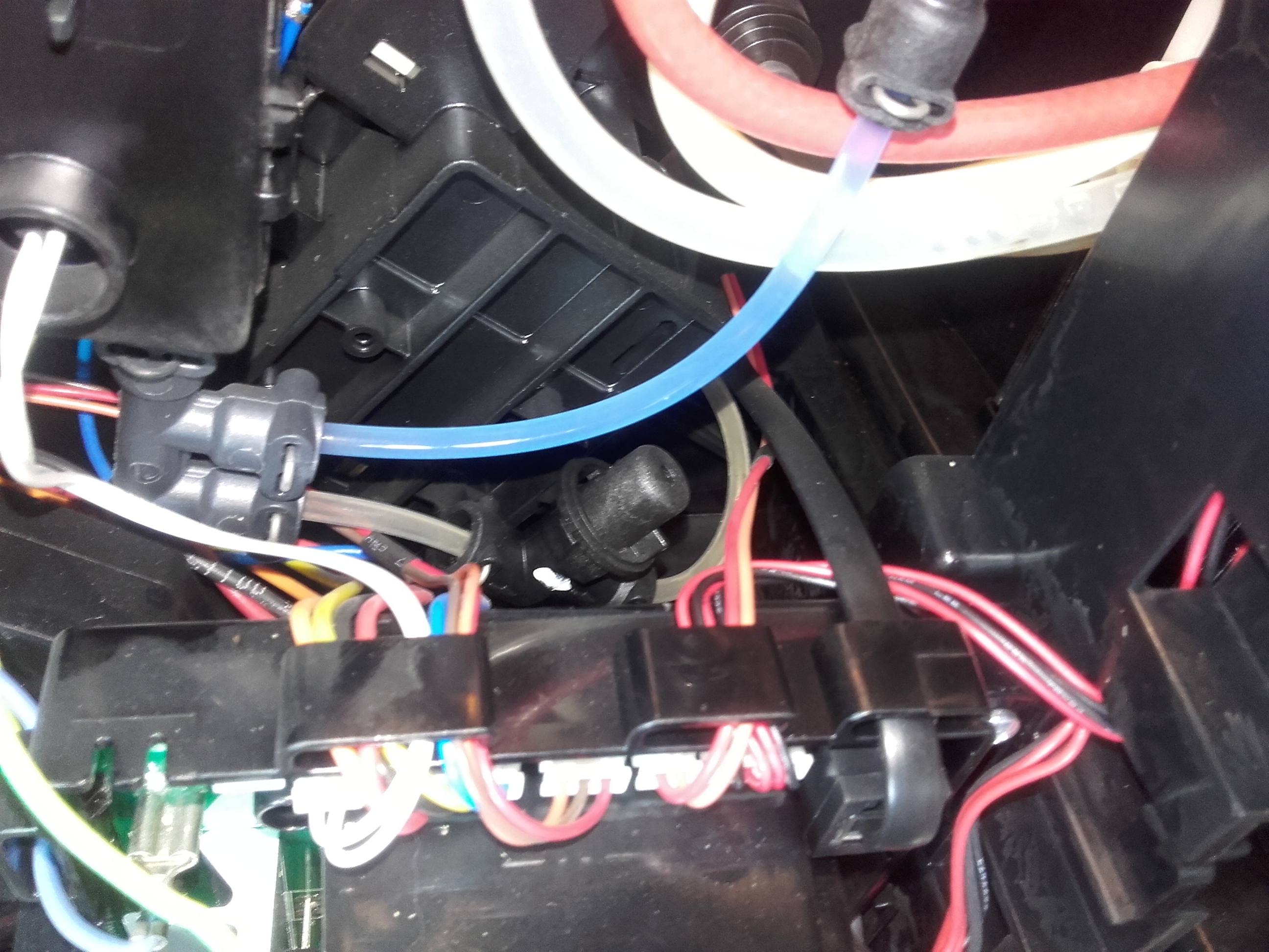

  • #6 16431399
    luka5151
    The reason for the failure was the valve that hung, just undress clean attached photos

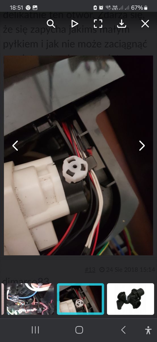

    Which valves did you clean? I clean the valve as a friend above took pictures, but it does nothing. Exchange?

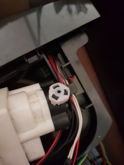

    In your place I would mention first of all the charge in the valve. Conical rubber alone, although it looks good, does not always fulfill its task. The second thing is the valve / hole / aeration. Located on a ceramic valve. This is the element in the attached picture. Remove this white plastic cap slightly pry up and there is rubber under it. This gum has a small hole. The rubber can be removed. Take a pin or needle and gently push the hole. It happens that it is clogged with some small pollen and if it cannot draw in air it will not air the milk.

    The valve will buy a whole new one. And this "hat" has one broken leg for me. He only holds two and I can't get it anywhere.

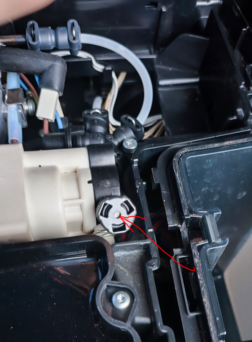

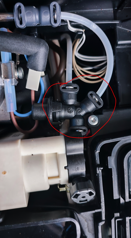

  • #20 20894913
    plipski
    Please clean the valve Close-up view of a valve with a plastic knob and wires..

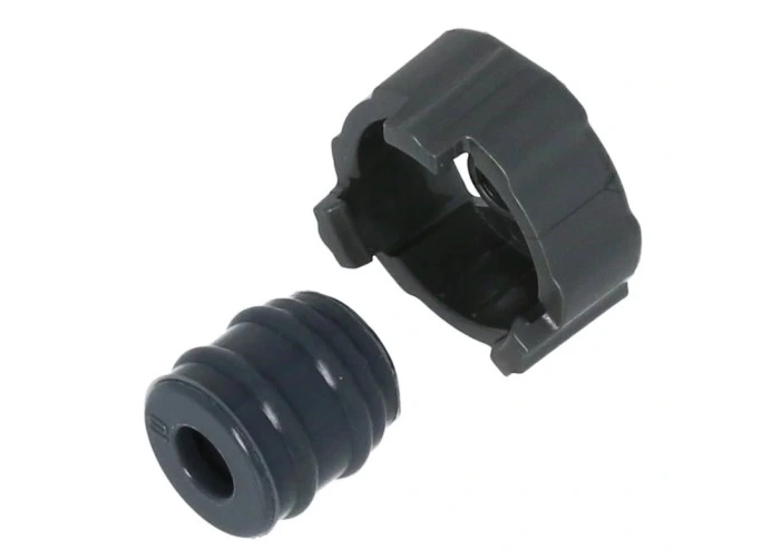

    Majkub
    Posts: 8
    I had the same problem. Everything great, I cleaned it, it improved. I ordered an aerator gasket with this sheet metal because it's not money, and I'll sleep better. One thing just doesn't give me peace of mind. There are two hoses going into the frother head from the ceramic valve manifold: red - steam and white - air. Is something supposed to blow from the white one, or does it work on the principle of vacuum, that when the coffee machine feeds steam, the head selects air with it?
