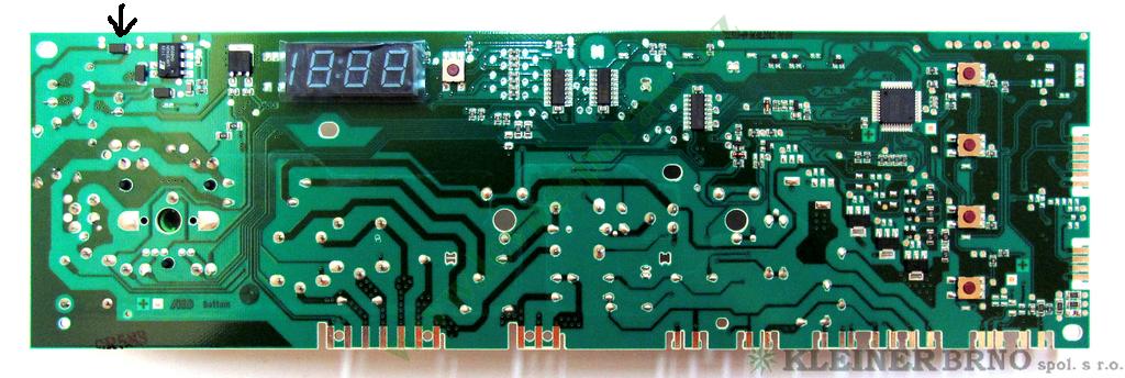

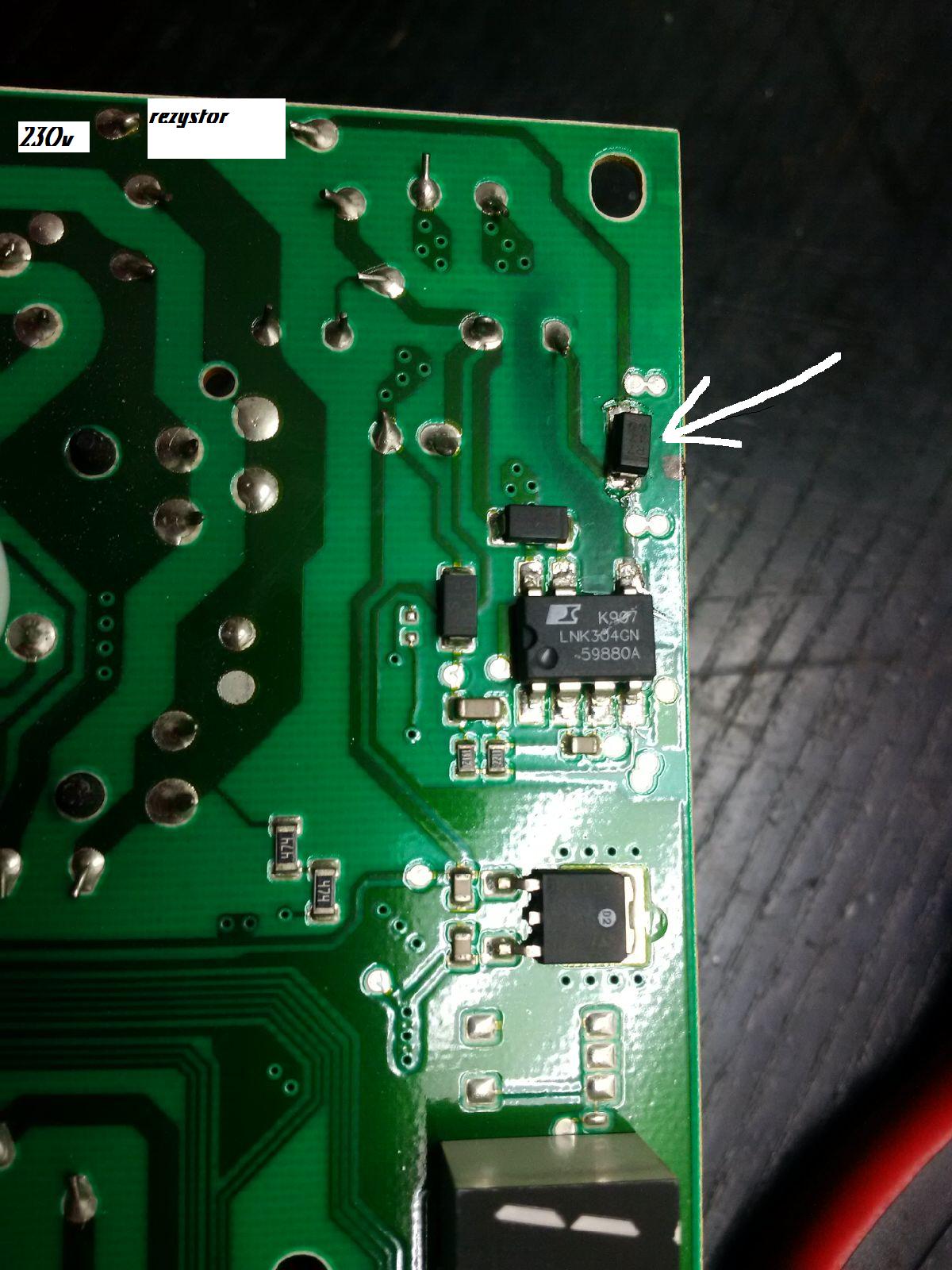

    I have a problem with identifying this element marked in the picture, the voltage from the network goes through the protection resistor, it has the R7 47 W marking on it, maybe someone has such a module on the table, has a round-trip of about 25? So I think it is damaged because it looks like a diode.

    Unfortunately, it does not work, I replaced the 1N4007 diode and I have already released two LNK304, the fuse is lit and LNK304, the capacitors are working, the other two diodes are also working on the meter. I will add that I turn it on without the washing machine cables connected.

    What is the plate marking / what is on the sticker?
  • #5 16230011
    mario151515
    Posts: 56
    Rate: 24
    code: 192583, if 722170-10, prg 722376-10, burning 182244

    mario151515 wrote:
    unfortunately it does not work, I replaced the 1n4007 diode and I have already released two lnk304, the fuse and lnk are lit, the capacitors are working, the other two diodes are also working on the meter
    And you soldered this diode correctly (it's about polarity).

    Well, a line to lnk.
    Miracles do not have to be short-circuited somewhere, and you checked the other LEDs at LNK304GN for reverse leakage?

    I confirm - rectifying diode 1A / 1000V - specifically S1M or BYG10M; 1N4007 can also be. If LNK304GN is on fire, I would check GR2 (the one below, cathode up) - ES1J . Choke short circuit rather unlikely.
    With overvoltage, these diodes can be damaged strangely, you will not check it on the meter.

    I put the US1M (ultrafast) on and it started, I don't know why the 1N4007 didn't work and it burned LNK304GN, thanks for the advice.
