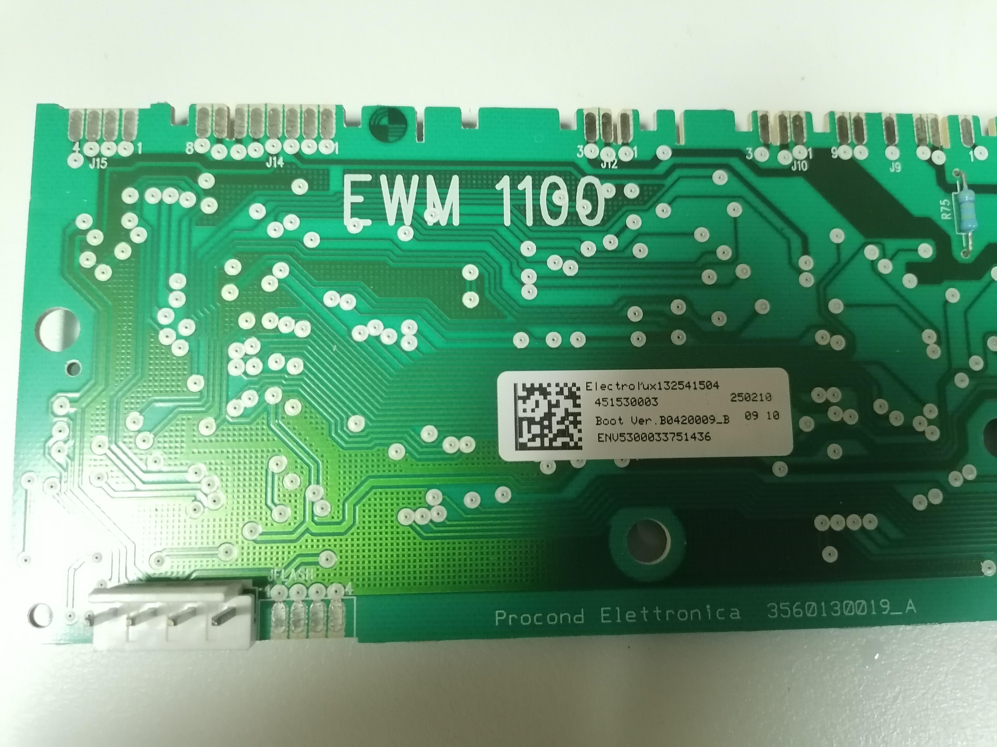

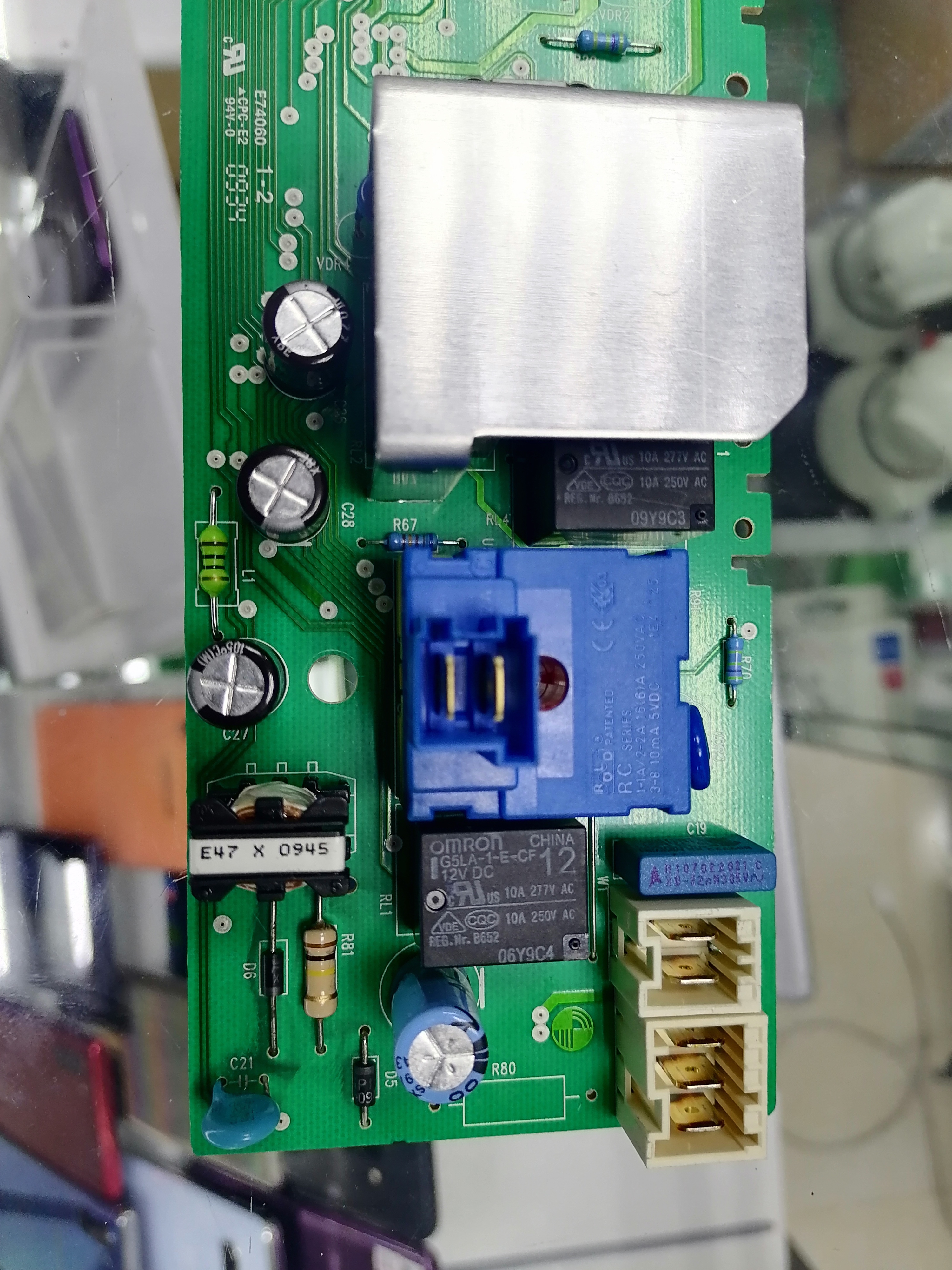

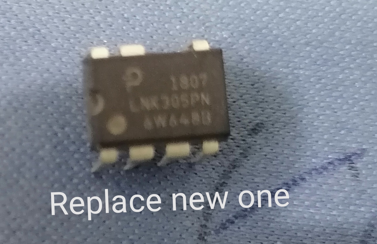

    rehan7867
    Hello sir my pcb burn LNK304GN IC AND 47OHM resistance any one suggest me which ic I can fix it I can't get same ic I already fix LNK305PN IC BUT MACHINE NOT recycling all function one time if i start auto it's continuously running not stopping plz suggest me machine modul number is AEG LAVAMAT 52840 and how to reset
    • EWM1100 PCB Repair: Replace LNK304GN IC & 47OHM Resistor in AEG LAVAMAT 52840 (90 chars) IMG_20220202_164557.jpg (3.05 MB) You must be logged in to download this attachment.
    • EWM1100 PCB Repair: Replace LNK304GN IC & 47OHM Resistor in AEG LAVAMAT 52840 (90 chars) IMG_20220202_190943.jpg (2.96 MB) You must be logged in to download this attachment.
    • EWM1100 PCB Repair: Replace LNK304GN IC & 47OHM Resistor in AEG LAVAMAT 52840 (90 chars) IMG_20220211_080116.jpg (1.94 MB) You must be logged in to download this attachment.
    • EWM1100 PCB Repair: Replace LNK304GN IC & 47OHM Resistor in AEG LAVAMAT 52840 (90 chars) IMG_20220211_080228.jpg (396.47 KB) You must be logged in to download this attachment.

    rehan7867 wrote:
    will someone suggest a replacement for this system?
    The replacement for the integrated circuit is LNK305PN and it must work properly as long as the chip itself is not partially damaged, which happens quite often with new ICs. The rest of your inquiries are so imprecise and given only in general terms, and that's not enough to know what you mean and what you mean ...

    rehan7867 wrote:
    I replaced the LNK305PN chip, but it does not have all the functions ... But if I start the car, it still works and does not stop.
    It is not the fault of LNK
