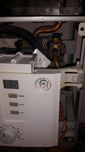

    Hello, low pressure on the clock, the needle is already entering the red field, use the valve to allow water to the correct pressure.

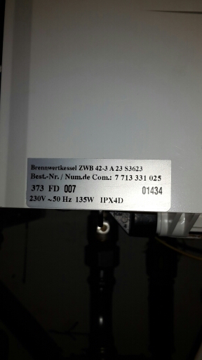

  • #6 16233350
    tp1974
    Posts: 8
    Hello, this is the furnace in Belgium, hit the 10th. I am sending a photo.

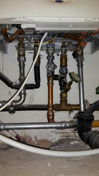

  • #8 16233739
    serwisszulborski.pl
    Heating systems specialist
    Posts: 1846
    Help: 360
    Rate: 1448
    The Polish version of this ZWBR35-3E boiler has a water inlet. On the other hand, in this version of ZWB42-3A, you should look for a regulation for free, because there is no. You have to look for an external valve or valves (sometimes there are two or a separable hose) that are permanently closed. If you can, take a photo of the external valves that are not included in this photo. The chilled water enters the Junkers fourth from left to right with this angled twist valve. Follow the water route if there is no valve that would allow connection to the central heating system or combine a hose, e.g. a park hose, which you could add water to. The pressure on the pressure gauge is actually too low.
  • #9 16237788
    tp1974
    Posts: 8
    Hello, I'm sending a photo, Junkers Cerapur smart -3 - low pressure, use the valve to add water
    second photo
    second photo
    • Junkers Cerapur smart -3 - low pressure, use the valve to add water osp.1.jpg (127.12 KB) You must be logged in to download this attachment.
  • Identifying the filling loop and preventing backflow contamination
    #10 16237983
    serwisszulborski.pl
    Posts: 1846
    Help: 360
    Rate: 1448
    It is difficult to clearly determine what to turn on to replenish the water to the system. I wonder if this is not the route connected with a flexible armored hose, the valve on the route is open at the top and at the bottom? Further to the brass manifolds on the left some valves are closed, why? Further on the wall on the left there is a closed valve without connection with an external thread, it is not known whether it is a water drain or the possibility of connecting a hose? .. You need to recognize the cold water route to determine how to make a connection with the system ... free valve with thread. Such a solution where the system is filled outside the boiler, the valves should be described, because water is allowed sporadically, and secondly, instead of pouring water into the system, we can accidentally drain it. Further, without a non-return valve, water that may enter the drinking water.

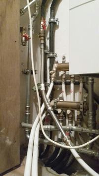

  • #11 16238603
    tp1974
    Posts: 8
    Hello, this soft conduit is connected (power) to the geberit in the toilet, I took a picture from the top, first No. 1 next to the stove, and the second No. 2 are the wires on the second wall next to it, maybe now you will see something better. Greetings.
    • Junkers Cerapur smart -3 - low pressure, use the valve to add water zdj2.jpg (103.17 KB) You must be logged in to download this attachment.
    • Junkers Cerapur smart -3 - low pressure, use the valve to add water zdj1.jpg (115.12 KB) You must be logged in to download this attachment.
  • #12 16238759
    serwisszulborski.pl
    Posts: 1846
    Help: 360
    Rate: 1448
    In photo 2 you can see the connection with the hose on the left side there is a valve along the pipe open and on the right side closed across. Try to gently open the valve while observing the pressure on the junker. If the pointer does not move up, close it.
  • #13 16240614
    tp1974
    Posts: 8
    Hello, after trying, unfortunately, nothing happens on the clockwork, but I have such a thought when I look at this valve with a soft hose and I would connect it to the threaded valve and open the water, because the soft hose is cold and the one with the thread is hot, now I would just need a hint whether to add water while the stove is off, or if I can add water while it is running. Greetings.
    #14 16240872
    serwisszulborski.pl
    Posts: 1846
    Help: 360
    Rate: 1448
    Turn the water valve in front of the hose, unfasten it and try to move the hose to the threaded valve, do not tighten it for good yet. After connecting, remove air from the hose, then tighten the nut. Let the boiler work and gently unscrew one of the valves and dose with the other one, carefully observing the pressure on the pressure gauge. Should increase if the idea is hit. If the needle twitched down, turn and return to the starting point.
  • #15 16243423
    tp1974
    Posts: 8
    Hello, the action was successful, I raised the pressure, but for a long time it was really going, the tip didn't even twitch, it just rose slightly, the most important thing is that the problem is solved. Thank you very much for your help and best regards. I'm sending a photo of the clock.
    • Junkers Cerapur smart -3 - low pressure, use the valve to add water zegar.jpg (73.18 KB) You must be logged in to download this attachment.
