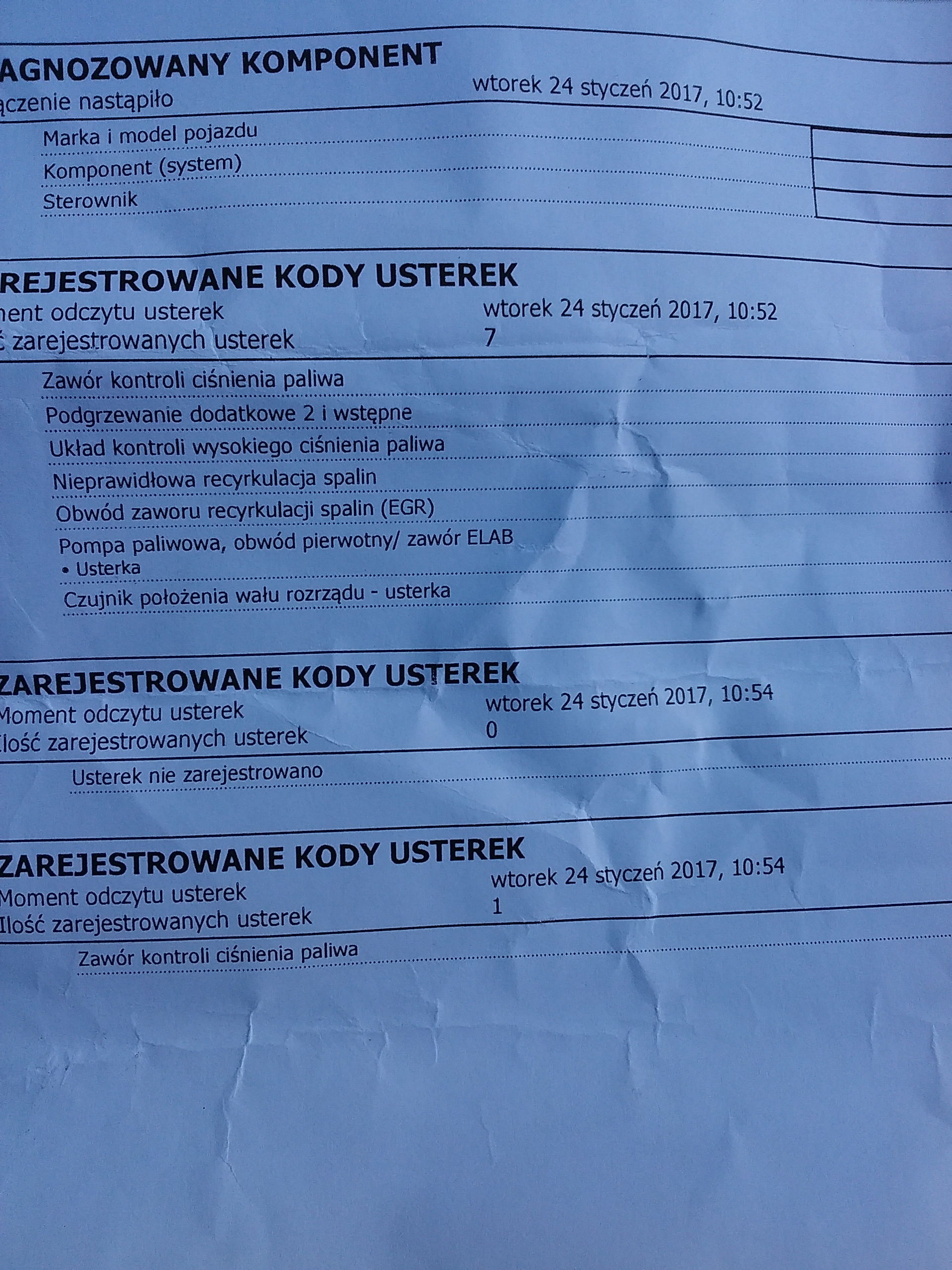

    Hello. I have a problem with Peugeot 306 2.0 hdi. The car went normally until it got cold. Namely, it stood in the garage (not insulated) 3 days in the cold and was not fired. After these three days, the car was fired because of the weak battery. After starting the car went out at idle as well as after adding gas, also went out while driving. And the engine walked a while after turning off the ignition. In the evening of the same day the check engine light came on. The car was brought to the Citroen service, where the solenoid valve at the fuel pump was replaced, a new fuel filter, and the entire fuel system was cleaned. The car drove normally for 1 day because the engine light came on again, the car turned up to max. revolutions and there were still moments after turning off the ignition. And another visit to the website where the car was connected to the computer and showed errors (in the attachment diagnostic report), errors were removed and the car was normal again, i.e. it had power and did not go on after switching off the ignition but one day after visiting the website the problem appeared again. Or maybe some of the forum users had a similar problem and knows how to solve it ??

    Give them the car since you paid and they didn't fix it.
    If it works up to 2.5 thousand turns, the computer has gone into safe mode.
    Working for a few seconds after switching off the ignition is a typical symptom for the fuel pressure regulator on the toilet pump. But the regulator can be undamaged, and the pump that can peel and kills the strainer that is in the regulator.
    You paid for a mechanic, let them fix it.
    In my opinion, paraffin has precipitated from the fuel and the toilet pump is flaking.

    The car returned to the mechanic. They checked the injection and it turned out that one pouring heavily and the other three are also to be replaced or regenerated. Injections have been changed to efficient used and the car still does not go as it should. Sensors have also been checked and look functional. It looks like it could be something with a pump like a colleague wrote.

    It turned out that the fuel regulator at the pump is to be replaced and the high pressure pump needles because there were a lot of swarf in the place of the regulator. After connecting the second regulator, everything is fine except that the engine sometimes gently waves with revolutions and the mechanic is in the process of determining the cause of this wave. That is to say, the high pressure pump and regulator need to be replaced, and the whole system will probably be cleaned. And I will add that the injections have been checked and have correct transfers.
