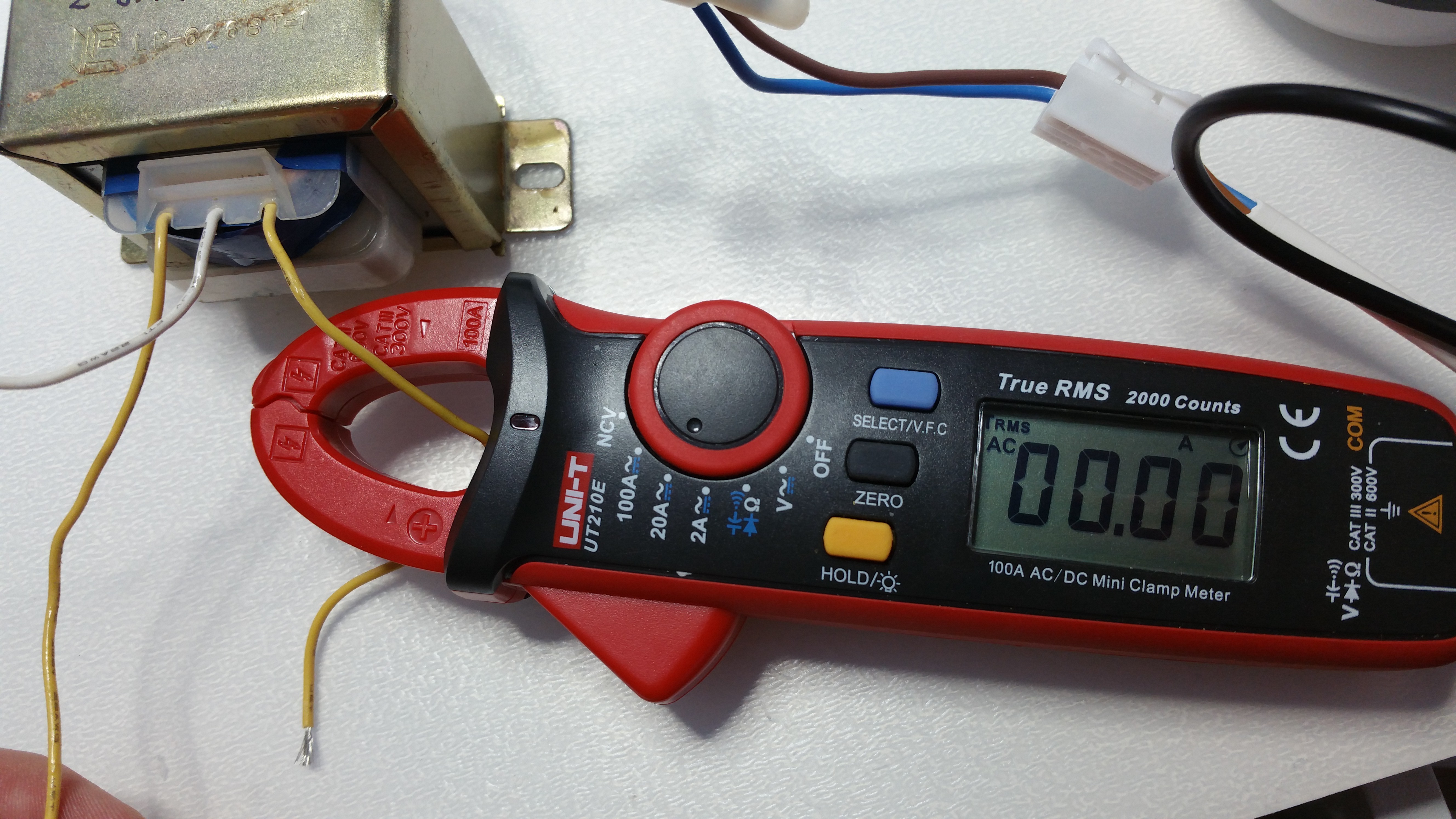

    None of my cheap multimeters measure AC current through wires. I have such a UNI-T UT210E, but connecting it like this:
     Measuring AC Current & Calculating Power of a Transformer: UNI-T UT210E & H1 55W Bulb
    obviously with a glowing bulb, it shows 0.002.
    - How to connect this multimeter to measure the current?
    - Is it possible to calculate its power on the basis of these measurements?
    You probably turned something during the measurement because the reading is 2mA.
    This, I know, just don't know what, that's why I gave a picture of the meter.

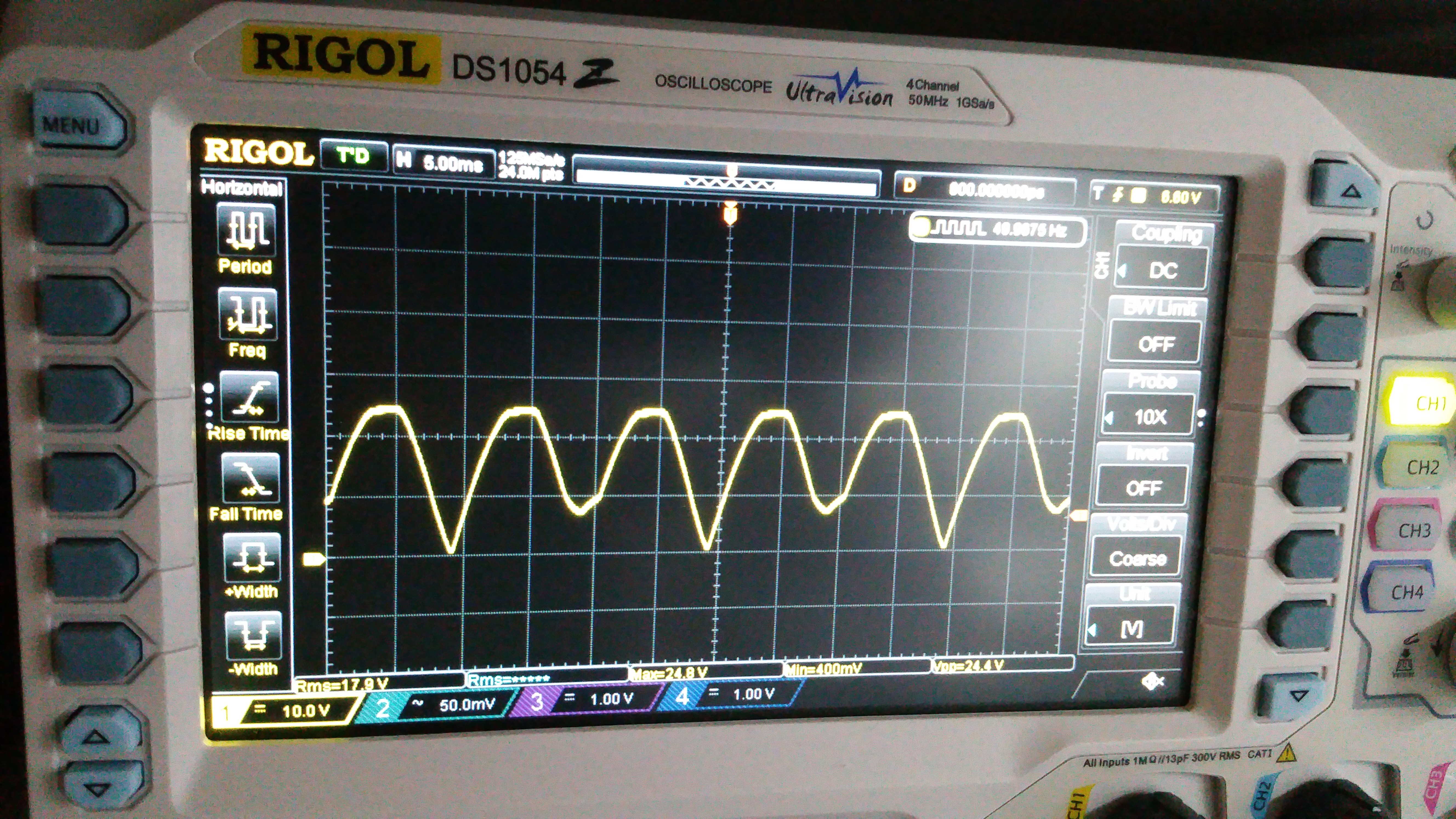

    And someone could explain to me why after straightening the waveform looks like this:
    ? Why are the "halves" of a sine wave different? The bridge is S4VB20, no load.
