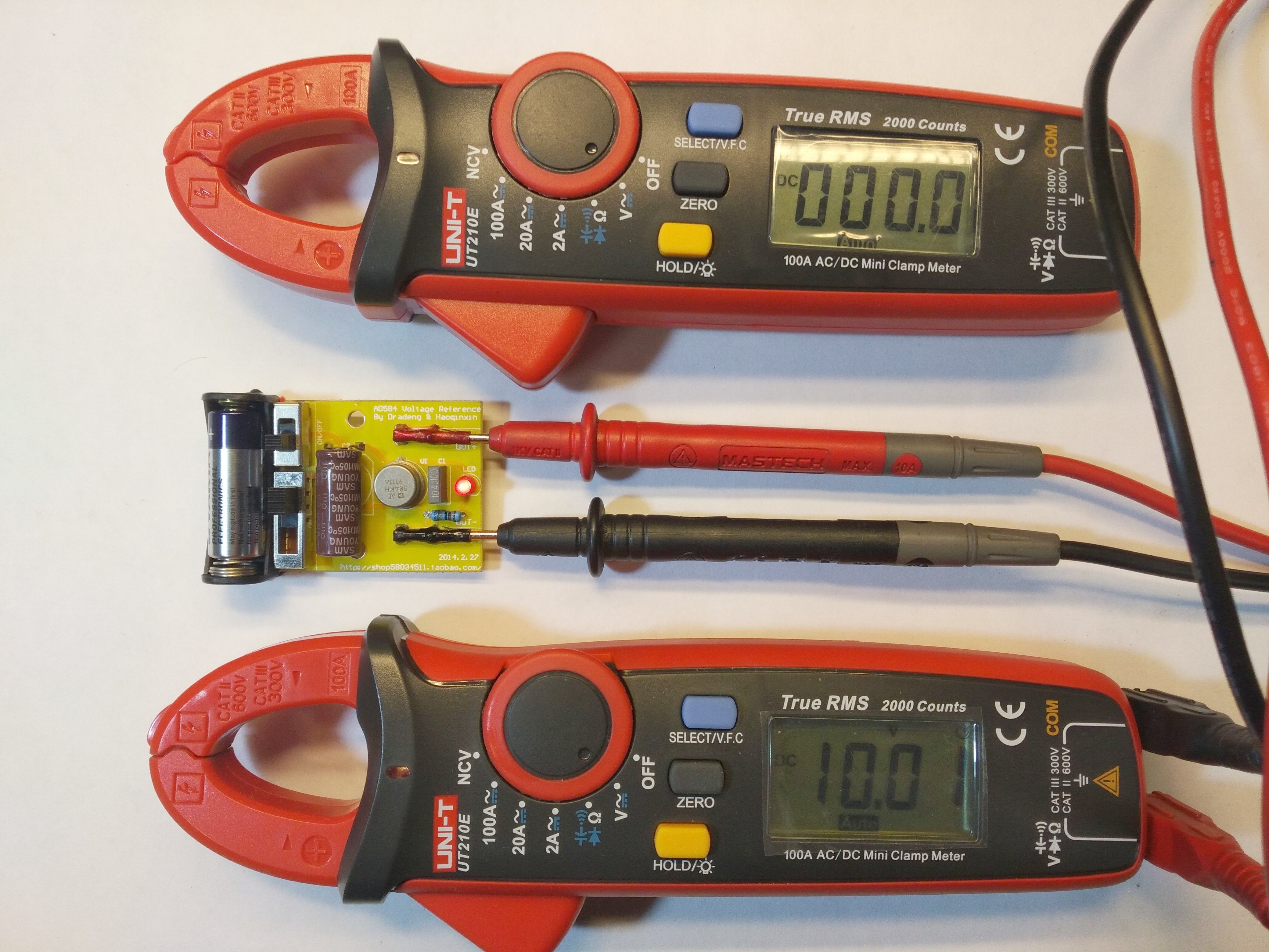

    As I bought it mainly for non-contact current measurement, we will start with such tests. In the first phase, a well-known current source was used as the load. In the second, a 12V 21W bulb, scrolled to almost 17V, and a piece of "computer herring", because I did not have a suitable resistor at hand :) . Stage three is an old iron and an autotransformer.
    So let's start the photo stories:
    UNI-T UT210E True RMS clamp meter - Test / Review / Description UNI-T UT210E True RMS clamp meter - Test / Review / Description UNI-T UT210E True RMS clamp meter - Test / Review / Description
    The readings below 10mA were "random", so to speak, as you can see in the first three photos.
    You can see, however, that the measure is simply stunningly accurate. However, I would like to point out that before each measurement I pressed the "zero" key, otherwise the device could show total nonsense.
    We increase the current a little and check the correctness of the readings, compared to the higher class multimer - Sanwa.
    Here you have 0.5A in turn; 1A; 2A and how much the power supply could handle (on a piece of sheet metal called the herring, as a load).

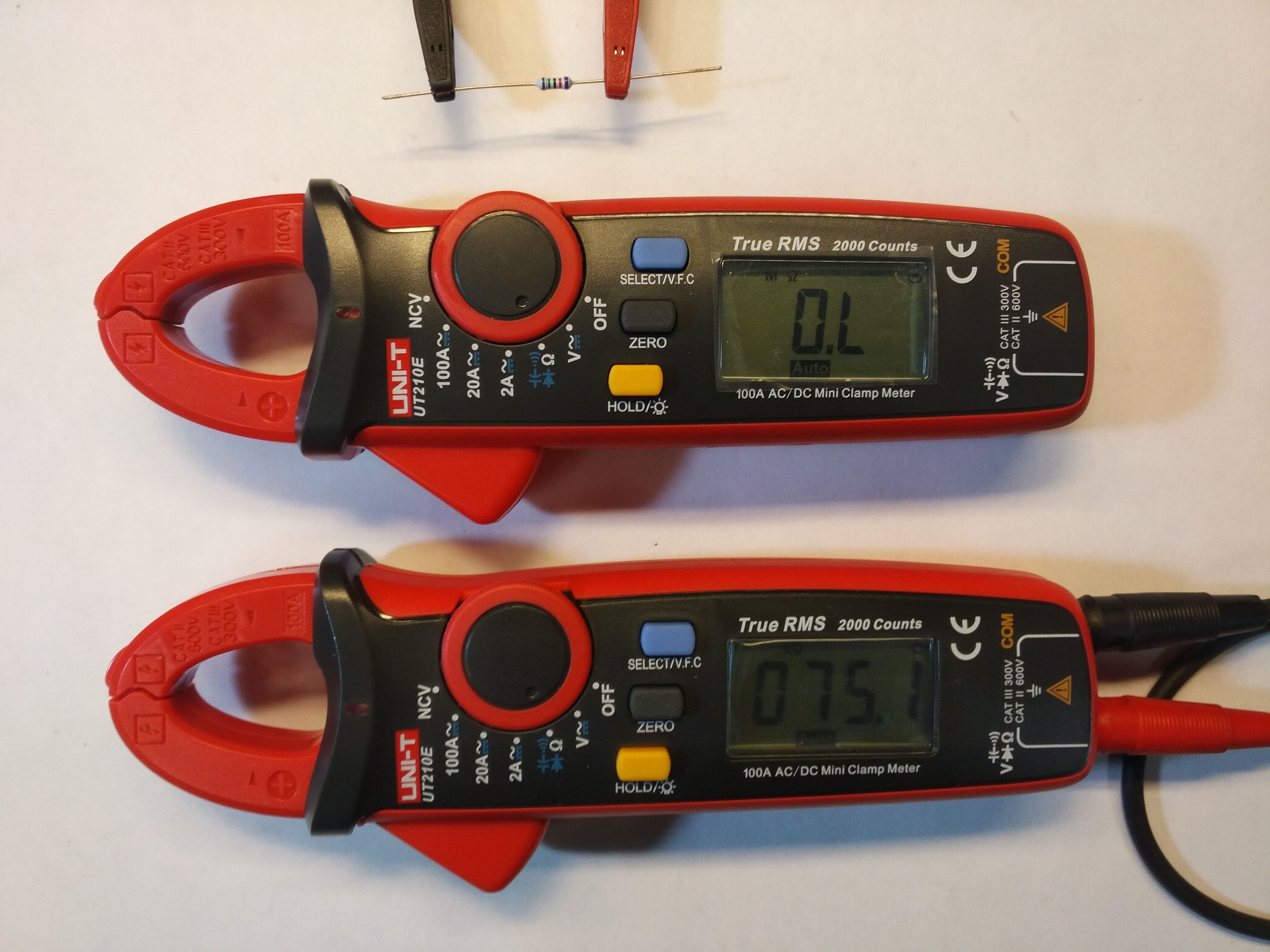

    A few more tests remain. I bought nine resistors with a tolerance of 0.1% and with reasonable values. So let's see how the resistance measurement works.

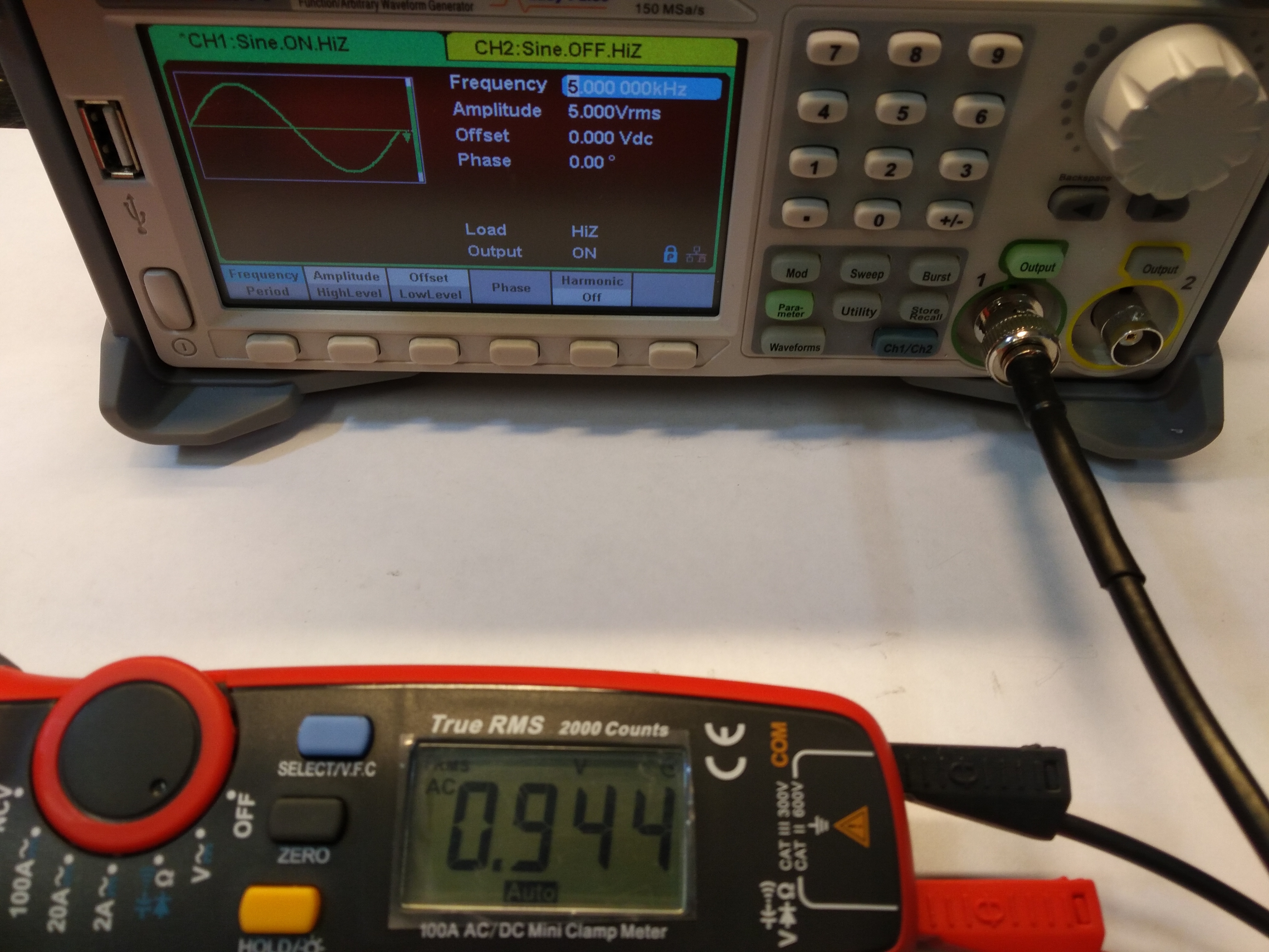

    Finally, using the courtesy Arthur 'and k who lent me a decent generator, we will check how True RMS works and whether this function is actually implemented, or is it just an inscription on the housing.
    So far, the gauges are doing very well, but it can't be that rosy, not for that little money. So what made me suddenly not fit something after such successful attempts? You'll see for yourself ...

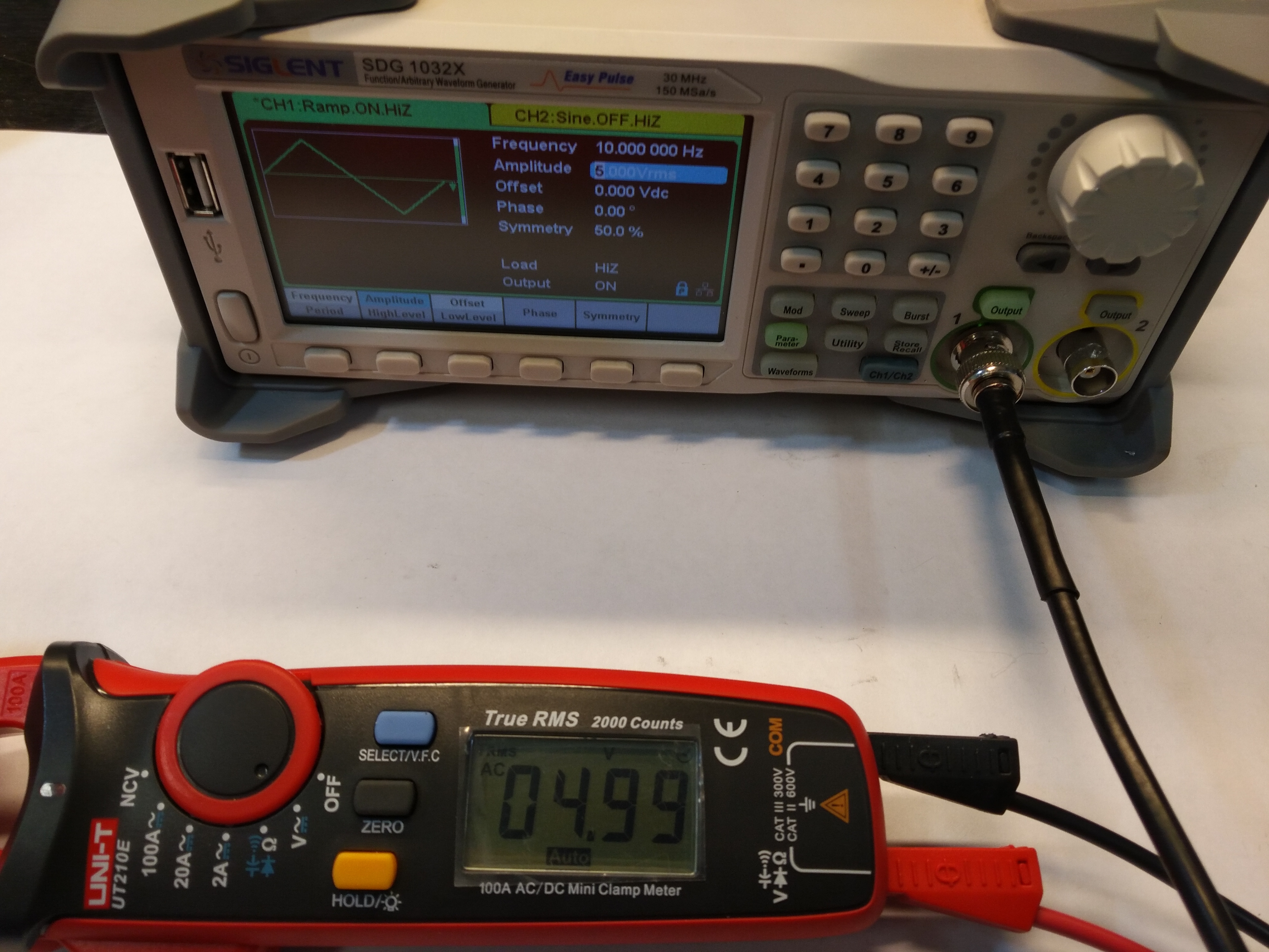

    As the last one, I will present you the TRUE RMS test. In the photos below you can see that T-RMS actually works, but only in a fairly narrow frequency range. But there is nothing to write home about, see for yourself.
    UNI-T UT210E True RMS clamp meter - Test / Review / Description UNI-T UT210E True RMS clamp meter - Test / Review / Description UNI-T UT210E True RMS clamp meter - Test / Review / Description UNI-T UT210E True RMS clamp meter - Test / Review / Description
    As you can see in the photo story above, this meter has something like T-RMS, but it only works in a certain frequency range. As we do not know what to expect when measuring frequently, the reading can be very misleading. However, for my needs, the "pincers" are more than enough.

  • #28 17764457
    1996arek
    Level 20  
    Posts: 770
    Help: 16
    Rate: 311
    Board Language: polish
    CMS wrote:
    Szyszkownik Kilkujadek wrote:
    Have you ever checked this Sanwa with a generator when T-RMS flies?
    No.
    @CMS Check Sanwa if you can. Because Unit is criticized, and nobody knows what with a better meter :) I have a Unit and a very nice meter.
