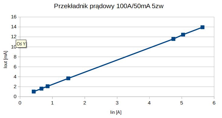

    The split-core current transformer shown in the photo is available at a low price on many auction portals and online stores. The transformer has the parameters of 100A / 50mA. So when 100A alternating current flows through the cable through the transformer, the AC milliammeter at the transformer output will show 50mA. The current ratio of the transformer is 2000. The output signal is led out on a mini jack connector. The transformer casing enables the core to be opened and the conductor to be measured is enclosed.
    To begin with, we connect a 140W 230V bulb, a current of 0.66A flows in the circuit, the milliammeter shows 0.31mA.
    According to the transmission 2000, a current of 0.62A should flow in the tested circuit. The multimeter shows 0.66A, however the measuring range is very large (100A) and measurement errors will always occur. Here more about the transformers and available models:

    Cheap current transformers - tests and applications
    By checking the measurement results at several points, you can see the linear characteristics of the transformer:

    For the measurement of smaller currents, it is worth using a transformer with a smaller measuring range. For the test, we put 5 turns on the transformer core, which changes the ratio and output currents,
    Iin [A] Iout [mA] x400
    0.42 1.03 0.41
    0.66 1.61 0.64
    0.85 2.09 0.84
    1.49 3.68 1.47
    4.74 11.59 4.64
    5.04 12.46 4.98
    5.64 13.94 5.58

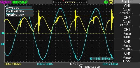

    I did some transformer measurements comparing to the waveform from the I-prober 520 probe.
    In a word of introduction, the measurements are illustrative and it seems to me that I plugged in with the probe badly, but unfortunately I do not have time to repeat the measurements.
    The transformer I test is the CS1050L:
    http://pl.farnell.com/coilcraft/cs1050l/transformer-current-sense-1-50/dp/2457937
    terminated resistor 15ohm 1% LR2F15R:
    http://pl.farnell.com/te-connectivity/lr2f15r/resistor-metal-15r-0-75w-1/dp/2330274
    Measuring system:
    As you can see from the diagram, the CS1050L transformer has a rectified signal, I had such a circuit at hand, so I used it.
    And now the meat, i.e. the measurement results:
    inverter supply voltage 10V
    I run a series of 8 periods for an RLC chip with a frequency of 80kHz
    legend:
    yellow - CS1050L
    blue - I-prober 520
    calibration:
    I-prober - 520 1v / A = Imax = 1.86A
    CS1050L - 300mV / A = Imax = 2.10A
    Second measurement:
    inverter voltage 20V, the rest unchanged
    Results:
    I-prober 520 1v / A = Imax = 3.48A
    CS1050L - 300mV / A = Imax = 3.93A
    measurement error = around 12%
    Such a large error could result from incorrect calibration of the current probe, unfortunately this is a new purchase and I have not read the manual well and suspect that I set the offset incorrectly.
    All anomalies result from the lack of any filter on the measuring resistor, and the I-prober 520 probe has only a 5Mhz band, so it is possible that it cuts out all disturbances.
    Sorry to be so quick and a bit careless, but sometimes better than not.
