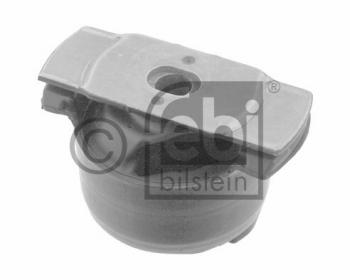

    Why is the right and left bushing in a Laguna II car different from each other?
    This is what the law looks like:
    Laguna II - The difference in the construction of the right and left rear beam b
    And so left:
    They differ in the screw hole, one round and the other ovoid.
    By accident (they were not described) I installed these sleeves in the opposite way, i.e. right instead of the left and left instead of the right, does it matter?
    I can't find out if the reverse assembly of the sleeves will affect their durability or only if they were made in this way to facilitate the assembly of the beam.
    I am asking for advice.
    Thank you

    the difference is that the two matching holes could cause Stresses when you put it together.
    This is the margin of error, each beam and each lagoon differ from each other by some minimum dimensions, so one sleeve is oval so that there is no stress :)

    That's how I thought it came from.
    So it makes no difference whether the one with the oval hole is on the right or left?

    I think that this also allows you to adjust the drift angle.

    Red polyurethane bushings were installed.
    And do you think it matters which sleeve is on which side?
    I can't find the answer to this question and from what I see from the pictures on the web, people have it mounted completely differently.

    I admit that I don't understand what the problem is, I put the right one on the right and the left one on the left, as it is supposed to be. Any other alpine combinations only at the request of the customer, you will start to combine something wrong, the sleeve will not survive re-assembly and especially welded flat bar elements require care not to fall off.

    You should go to check the geometry. If you set it correctly, you forget about the topic.
    I don't know if polyurethane is a good choice. It is durable but not comfortable.
    Some time ago I was assembling a cushion for the engine under a polyurethane engine and had it replaced with another one because everything was moving to the body.

    In this problem, that everyone claims that these sleeves should be the other way around, in one of the books I repair myself, I found that the right with a round hole, and some manufacturers write that the left with a round, etc.
    There is nothing to look at the pictures because everyone could wear them the other way around.
    All in all, it doesn't make any difference what I found out, also the topic finished.
