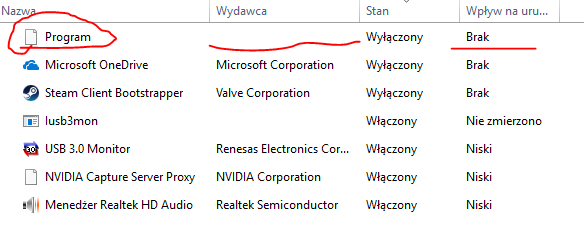

How can I remove an empty disabled startup entry called "Program" from msconfig in Windows 10 when its properties and file location are unavailable?
You can delete the empty startup entry in the registry, or simply ignore it because it is only an empty disabled entry [#16234584] [#16234881] Open regedit and go to HKEY_LOCAL_MACHINE\SOFTWARE\Microsoft\Shared Tools\MSConfig\startupreg, then delete the empty entry there [#16234584] If you do not find that key, check HKEY_LOCAL_MACHINE\SOFTWARE\Wow6432Node\Software\Microsoft\Shared Tools\MsConfig [#16234728]

    Well, there is a situation like in the attachment that I have an empty program in the startup tab in msconfig. I scanned PC Norton and showed no problems (with the license so rather sure that there is nothing). But I still have suspicions about this file. By clicking "right mouse button" the "properties" option is selected in gray and "open file location", which means I can't check these things. Does anyone know how to remove this item from the autostart?
    • Win 10 startup - In the startup tab I have "Program" with the icon. bershgber.PNG (15.71 KB) You must be logged in to download this attachment.

    The entry is disabled, if you want to delete it, run regedit, go to HKEY_LOCAL_MACHINE \ SOFTWARE \ Microsoft \ Shared Tools \ MSConfig \ startupreg and there delete this empty entry.

    Win 10 startup - In the startup tab I have "Program" with the icon. in HKEY_LOCAL_MACHINE \ SOFTWARE \ Microsoft \ Shared Tools \ MSConfig I don't have a startupreg - is that bad?

    Check in HKEY_LOCAL_MACHINE \ SOFTWARE \ Wow6432Node \ Software \ Microsoft \ Shared Tools \ MsConfig

    Win 10 startup - In the startup tab I have "Program" with the icon. I was looking for the address you provided and I do not have "Software" after Wow6432Node. I also searched through the "Find ..." function and nothing like it came out. Is it supposed to be this way or is something wrong here?

    Maybe they changed something in W10.
    Look for another entry, e.g. lusb3mon, and check if it finds the key from msconfig.

    So in general, I can add: How do I turn on msconfig and click the "Run" tab, and there it says: "To manage startup items, use the Run section in the Task Manager." and below is the hyperlink that opens that manager. Only from here I can see programs launched when the computer starts. That is, if there is such a possibility that the startup items may be hidden somewhere in the regedit in the task manager?

    It is not harmful, you cannot see this entry in the logs either.
    Look as I said earlier:
    > Search for another entry, e.g. lusb3mon, and check if it finds the key from msconfig.

    Well, I did what you said and some of the items are, but each in a different folder, e.g. OneDrive is somewhere in microsoft and uninstall, and Iusb3 is in intel-> uninstall, and more interestingly both the Steam Client Bootstrapper and the phrase "Program" does not find

    You can ignore this, it's just an empty entry. It is not even included in this.
