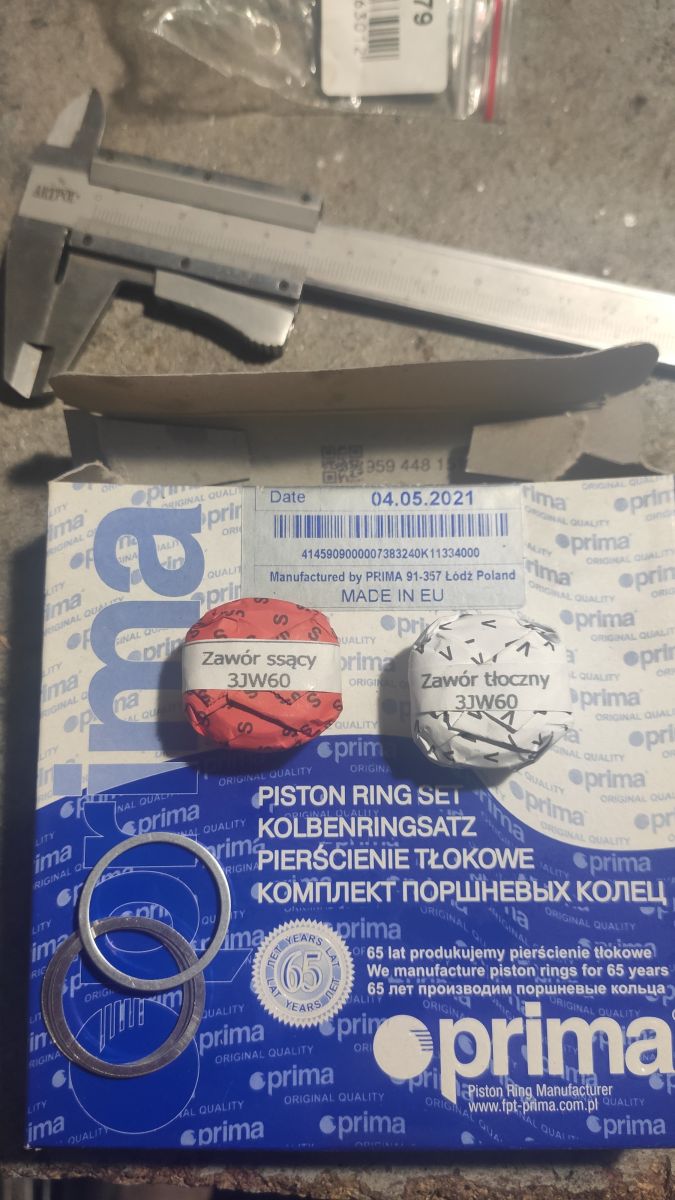

  • 3jw60 rings and valves fit ASPA 1js60

    vcc wrote:
    Głowiczka is definitely different, the rings will fit. I have one somewhere in my stocks, but I didn't even touch it, because it is efficient only for pumping balls.
    Thanks for the info. According to sellers on Allegro, both rings and valves from 3jw60 fit. I have traveled both and ordered them, for me the rings are 3x2.5 and 1x3.5mm. It will come out ;) As for the compressor ... it all depends on your needs. In my home workshop I have a Stanley 10bar 2HP 30l with a vertical cylinder and for small needlework with an orbital sander or an air wrench it is enough. He unscrews the bolts 21 at the wheels, and experts have argued that it is not suitable ;) And Aspa is much quieter than Stanley and it's a plot design, so that the compressor is at hand if necessary :)

    @ balcerowicz79 I bought rings online, where the description is:
    PISTON RINGS 1 SET [for 1 cylinder]
    FOR 3JW60 (ASPA) COMPRESSOR MOTOR
    MANUFACTURER PRIMA ŁÓDŹ
    Dimensions:
    - piston diameter (mm): 60
    - thickness of the rings (mm): 2.5 / 2.5 / 2.5 / 3.5
    And the valves also from 3JW60, but I do not recommend them, because it hits a maximum of 7 bar (as described in the auction, so you need to read carefully) and then the pressure gauge does not budge. I put on the old ones again and blows to the pressure switch sections, i.e. 8 bars :) After replacing the rings, it no longer blows oil through the breather hole in the sight glass.
    ASPA 1js60 Compressor: Oil Types, Quantities, Sight Glasses, Rotation Direction & Assembly
