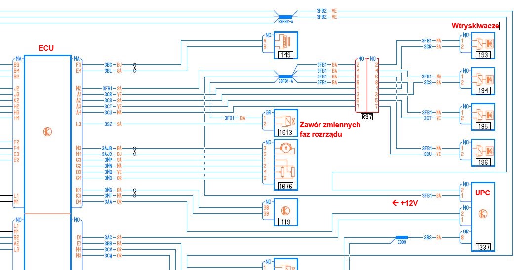

    I wanted to ask how it is with the control of the above. solenoid valve, from what I've learned, is controlled by mass. One I do not understand, because after ignition, when I measure with an electronic meter it is 12V, and when I connect the removed solenoid valve, it does not move, when I connect the light bulb, it is not lit either, the plug is 12V, and the solenoid valve does not work, nor the bulb. For my mind this should be how it is and it is clear to me how in the power pressure sensor, through its pins the mass is passed (-) to say some pin in the sagem controller, and here it is like 12V and I can't connect anything - like this is ?

    + 12V is given from UPC, the mass is controlled by the controller. As on the meter you have 12V and the connected bulb does not light up, the poor contact in the plug or the wire has rotted.

    Everything is correct, you think well, but probably not quite in your opinion, even if there was a 12 ignition position, the solenoid valve would be open all the time, which means that the control is done otherwise.

    + 12V you have always given (after ignition) and the controller closes the circuit to ground. I don't remember if this valve is normally closed or open. If you connect a light bulb between pin 1 in the plug of this valve and the ground it is to shine. Schemacik

    If you check the voltage with a multimeter that has an internal resistance in the tens of MΩ, it will show the voltage, but no current will flow because the wire or connection has corroded and has a resistance of, say, 1 kΩ, therefore, to be sure, you should always check the voltage and continuity of the wires using a light bulb – at least a 21W one.

    Check that you have a correct +12 V supply on one of the pins relative to earth, but with a light bulb connected as a load. If the light bulb does not come on, there is likely to be a corroded wire at the junction point hidden inside the wiring harness.
    On the other hand, a 2.5 V reading on the wire coming from the ECU does not indicate that the engine control unit or the connection is functioning correctly.
    The solenoid valve is controlled by a PWM signal. At a fixed camshaft angle, the duty cycle is 50% and the valve should stop in a position between opening and closing, i.e. in the ‘stop’ position.
    The ECU monitors the voltage at the control output to determine, during self-diagnostics, whether the solenoid valve is connected (12 V) or disconnected (0 V), or to check the response when the solenoid valve is activated (12 V when not activated, 0 V when activated).
