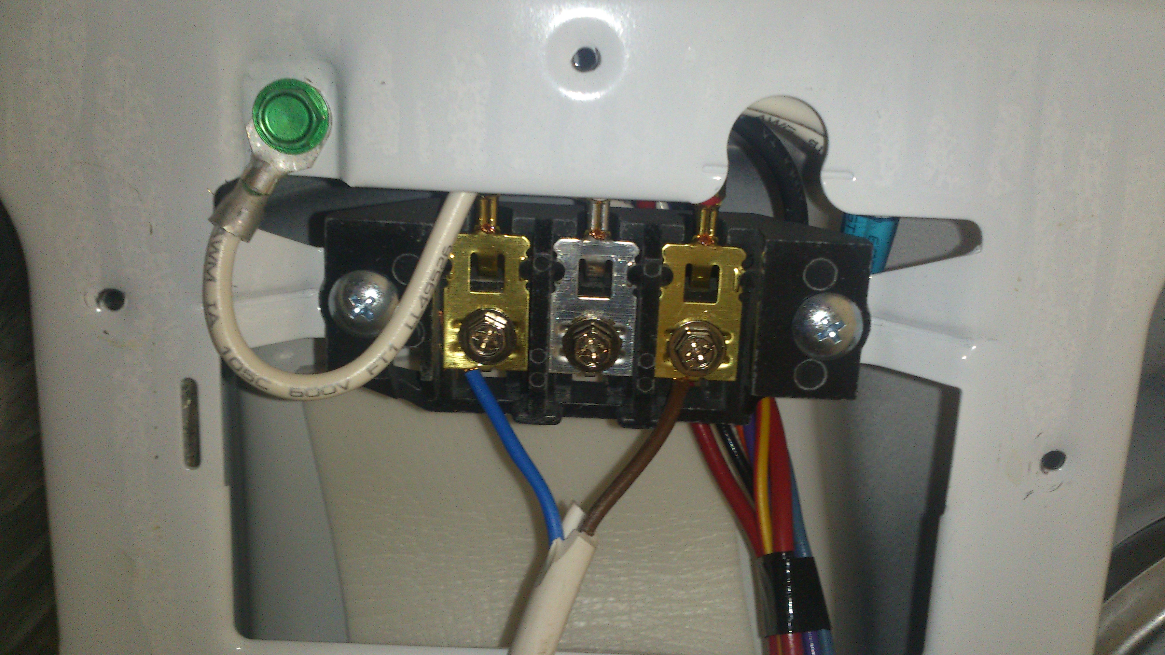

    A friend brought a brand new Whirlpool clothes dryer from the USA. model WED5000DW2, dedicated to those voltages.
    Connection types according to the nameplate. 3 wire and 4 wire POWER SUPPLY.
    The original cables are not there (someone disassembled it before me), I managed to find a diagram of the device and one page of the manual. Unfortunately, I don't think I know exactly what it is like with these tensions in the USA. Is the standard connection of such devices with a 2-phase voltage 120V + grounded neutral? (3wire) and 2phase + N + PE (4wire)?
    In this topic https://www.elektroda.pl/rtvforum/topic1653522.html#8017571
    describe "There are no two phase home installations in America. It is a single phase installation with a middle ground connection." And here I have a spouse.
    Is it possible to connect the above dryer without changing the whole thing?
    A 230V-110V 5kw transformer is available.
    Someone in front of me connected so that spinning the drum and control worked (the entire programmer and other wonders are mechanical so they do not mind changing the frequency) unfortunately, when the equipment comes to heating, it is silent, so I understand that it lacks phase-to-phase voltage (diagram)?
    In the building, the closest force is 2 floors up, so bad. And 2 transformers would have to work.
    I attach a plate, a diagram for this device, a manual page and a socket in the dryer (currently there are remains of something that you should not suggest). The socket has a neutral white connected to the housing.
    • Whirlpool dryer - USA dryer and Polish network standards, how to connect tabliczka suszarka.jpg (758.53 KB) You must be logged in to download this attachment.
    • Whirlpool dryer - USA dryer and Polish network standards, how to connect schemat suszarka.jpg (1.7 MB) You must be logged in to download this attachment.
    • Whirlpool dryer - USA dryer and Polish network standards, how to connect gniazdo suszarka.jpg (1.93 MB) You must be logged in to download this attachment.
    • Whirlpool dryer - USA dryer and Polish network standards, how to connect 20170125_171138.jpg (3.08 MB) You must be logged in to download this attachment.

    If you want to run it somehow, in Europe you have to combine it with a "4-wire" connection.
    In the photo I can see that the white wire from the dryer is connected to the housing and this is the first error - this configuration is for 3-wire connection, i.e. for old American installations (common protective and neutral wire in the dryer circuit). This white wire must be unscrewed from the housing and put under the screw on the middle clamp.
    In the place where the white wire is now connected to the housing, you must connect the protective wire (green and yellow) from the power cord - you must crimp the ring terminal on it.
    The phase and neutral wires (brown and blue) from the power supply should go to L1 and L2 of the dryer - that is, the rest of the wire is connected as now.
    The diagram shows that the 120V part of the dryer requires such voltage only between L1 and N of the dryer, i.e. between the black and white wires coming from the dryer.
    The secondary winding of the transformer, which gives 120V, must therefore be connected to the black and white wires, the transformer itself should be supplied normally from the mains.
    It is only important that it is a classic transformer with separated windings, and not, for example, an autotransformer, because the autotransformer has a bridge as shown in the figure "included" and it must then be taken into account.
    Another thing - the dryer will consume about 25A at work - the power cord must have a cross-section of at least 4 mm ^ 2, from such a thin one as in the photo, the machine will simply burn down one day. You should also forget about powering it all from a standard socket - it is suitable for max. 16A. You need to separate a dedicated circuit in the installation from the switchgear with a protection of at least 25A and a cable with a suitable cross-section, a suitable socket and plug, eg IEC 32A 2P + E, or permanently connected in a box.
    The installation must also be able to make such a circuit - it is a pre-meter protection, which should have at least 32A in this situation. From the descriptions, I conclude that this dryer is to be used in an apartment with a single-phase power supply, so it is possible that there will be a problem with it, because with one phase in Poland they rarely give that much and it is probably at most 25A (although you can ask). If it is not possible on one phase, it is basically only the conversion of the connection to a three-phase one and the application for a connection power of 20kW to get 3x32A before the meter.
    Now let your friend think about how to lead the duct from the dryer outside the building, because 99% of it is an exhaust dryer (like almost all in the USA). He can do it at home, but there will be a big problem in the apartment.
    Importing large household appliances from the States is generally not a good idea, it is difficult to start it in European realities without combining, sometimes and with combining nothing will come of it ...

    My friend Michcio just drew you what it would look like. I wrote about the same connection.
