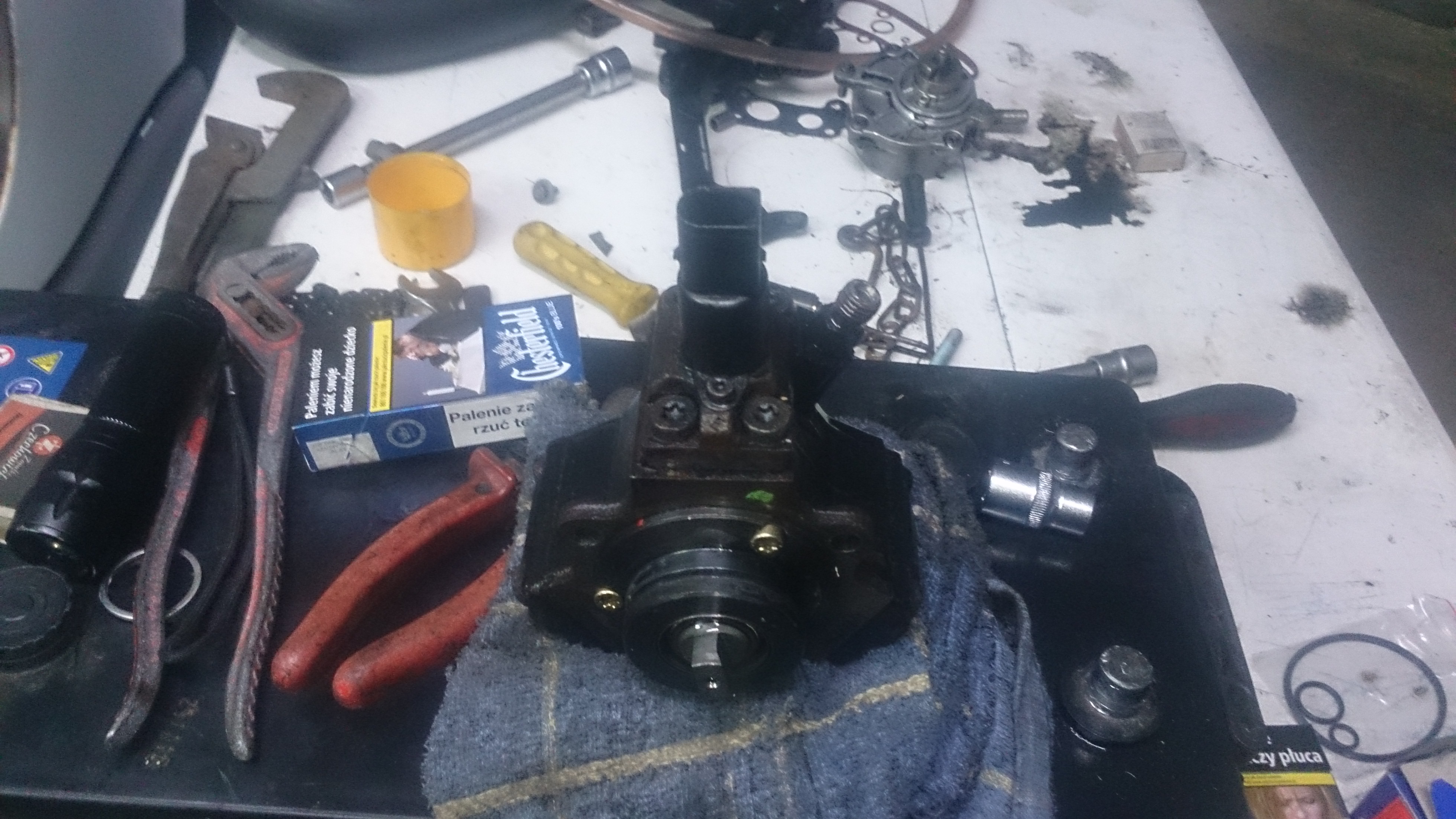

    I bought a Mercedes Sprinter with a damaged 2, 2 cdi. The whole post was completely renovated.
    I have a high pressure pump in the sprinter with the input of the two-pin pump A 612 070 01 01 pump (damaged pump, that is the shaft where the gearbox is mounted on the gear - it is very crushed and has a lot of looseness) After firing you can hear the chain loose, so far the timing I did not move because I bet on this option :-) ) I will add that when I dismantled the engine immediately after purchase, this meshed part of the pump was broken .... and found himself in the oil pan together with the broken gear as if it damaged the entire timing but this is only my speculation :-)

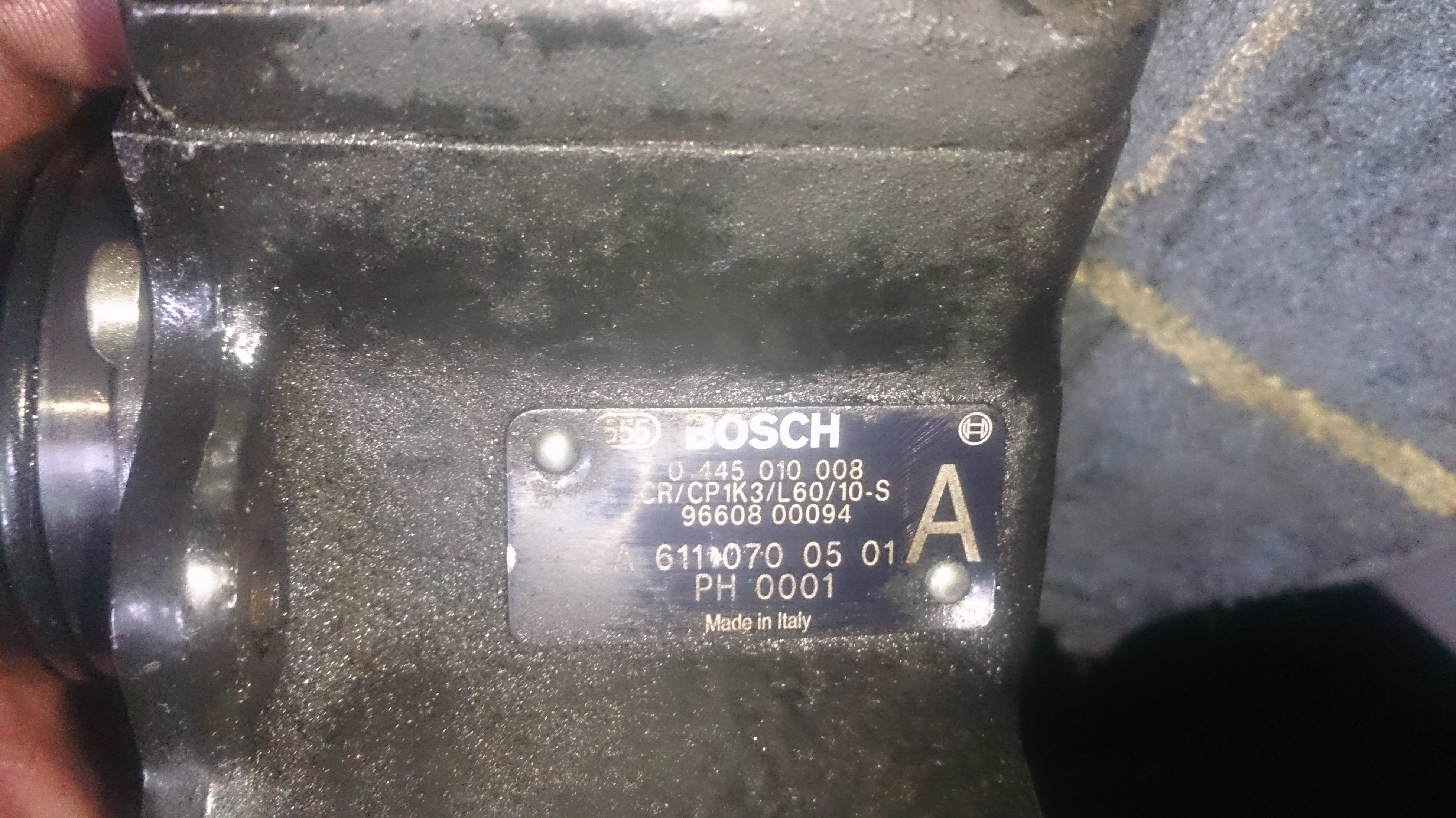

    I have a second pump from a friend from the engine who also went in the sprint - pump number A 611 070 05 01
    Everything would be okay, but there is no cube what we plug in for two pins ...?
    What would it matter if we missed and set up a pump without this pattern? What is the electronics on the pump for? will the motor normally walk?
    I do not want to make twice as unnecessary ... so I do not assume so far - I'm asking you even though I already had a headache cdi :-)
    On the auction portals, the numbers are all over the world - the number A 611 070 05 01 has a sensor .... maybe just turn it from my pump to the one with the higher number?
    Photos of the pumps below. I am asking for a quick response
    • Mercedes Sprinter 2.2 CDI - High Pressure Pump - Two different pumps DSC_0912.JPG (1.85 MB) You must be logged in to download this attachment.
    • Mercedes Sprinter 2.2 CDI - High Pressure Pump - Two different pumps DSC_0915.JPG (2.02 MB) You must be logged in to download this attachment.
    • Mercedes Sprinter 2.2 CDI - High Pressure Pump - Two different pumps DSC_0910.JPG (852.91 KB) You must be logged in to download this attachment.

    It is like a constitution that activates the third section of the pump as you push the gas more heavily, it causes an increase in fuel pressure, then it did not mount any more.

    would it go like I mounted a pump without this sensor of the third section?
    How would it work for the engine?

    You will start but you will not be able to drive the power and with errors.

    He will walk normally. This pump, without a connected sensor, works as standard, only when you plug the sensor's power supply, it cuts off the third section. If there was no one in yours, then there will be no mistakes. Another place for leaks. :D

    74, and for what purpose is this section cut off?
