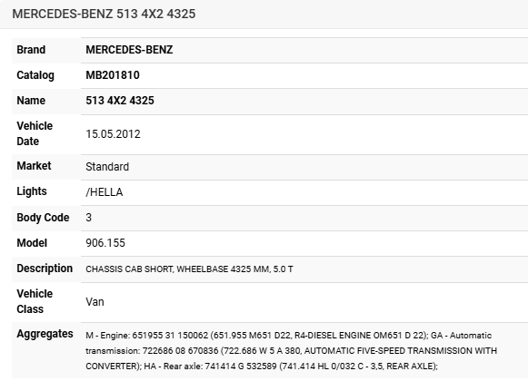

    Hi There,
    Did anyone get to the cause of the issue of P226300 under light to med acceleration in warmer ambient air temperatures?
    I am in New Zealand and have this exact issue and currently am yet to find a fix and anyone that has had these symptoms.
    So far I have replaced both vacuum transducers for the waste gate and boost control flap, vacuum tested the entire system, carried out a smoke test (slight leak from the EGR cooler bypass flap shaft, not yet repaired) no sign of leaking from the manifold. Smoke tested the vacuum system no leaks.
    I have ordered a boost pipe sealing ring for the RH pipe where it goes onto the turbo as it was damp around it.
    Complaint: Drive at 100kph slow for a township 70-80kph, go to speed back up to 100kph after the township light to med throttle or resuming the cruise control, emergency mode, MIL light flashing. P226300 is the only code.
    Any help would be appreciated.
    Vehicle specification for Mercedes-Benz 513 4X2 4325
