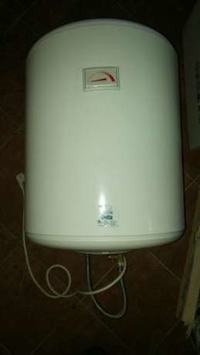

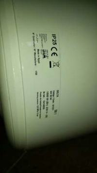

    I have a heater as in the title (it was already in the apartment we bought), I have no instructions for it. My point is whether these heaters have a magnesium anode that can be replaced, and if so, where to find it in the heater and where to buy it.
    Does this model require any periodic service? It looks like the one in the photo.

    The heaters do not require any maintenance, apart from making sure that the safety valve is operational. The efficiency is checked by turning or pressing the appropriate lever on the safety valve. Then water should drip. As for the anode, you can find out by looking inside from the bottom of the boiler, or on the manufacturer's website, if there is one.
