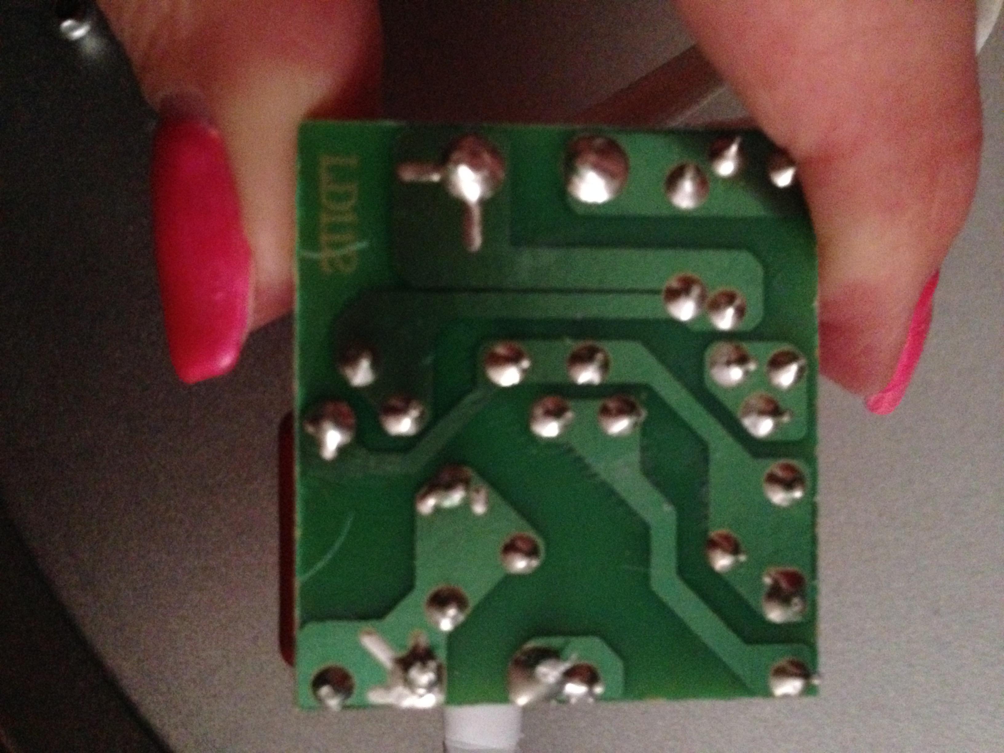

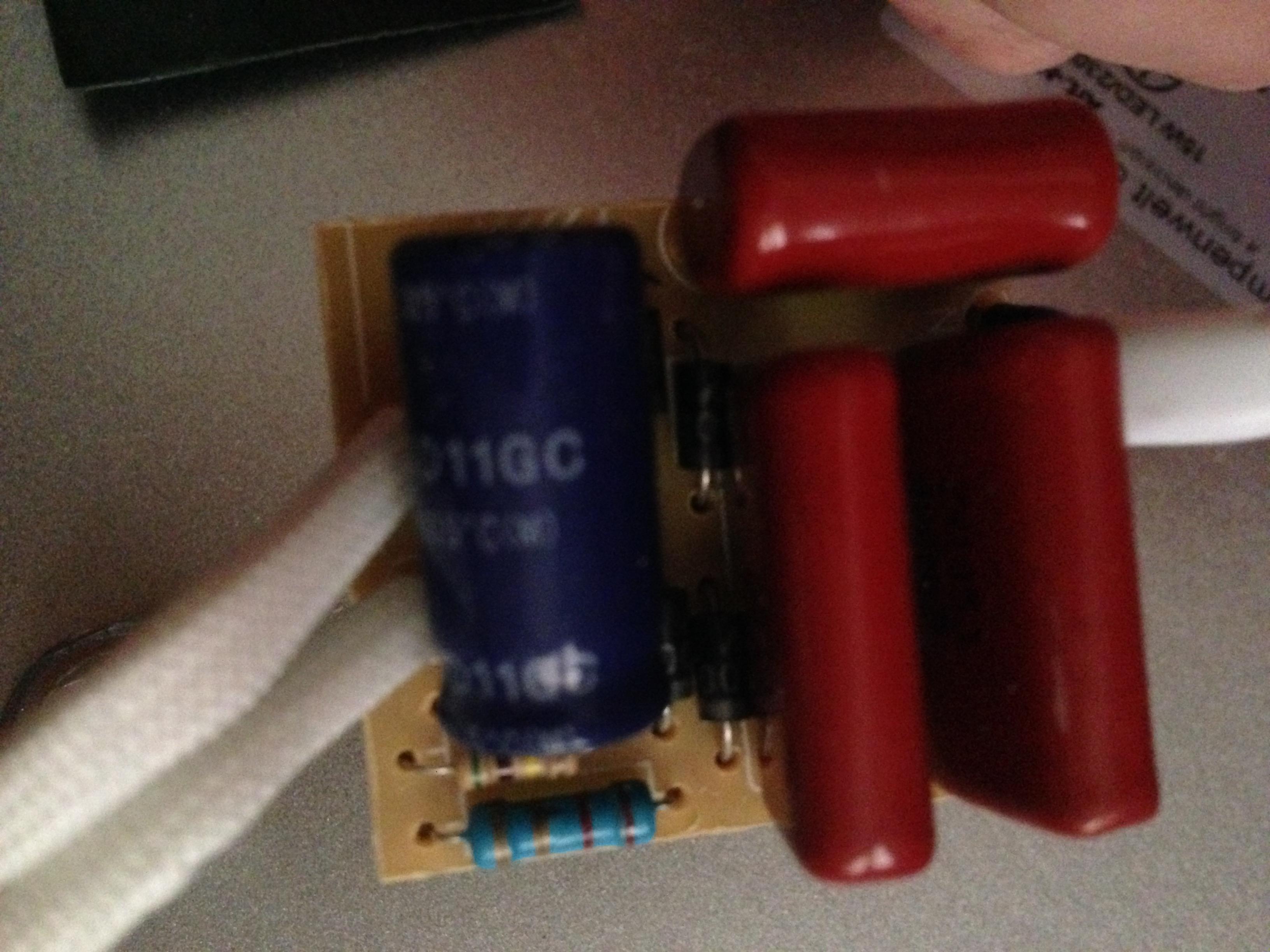

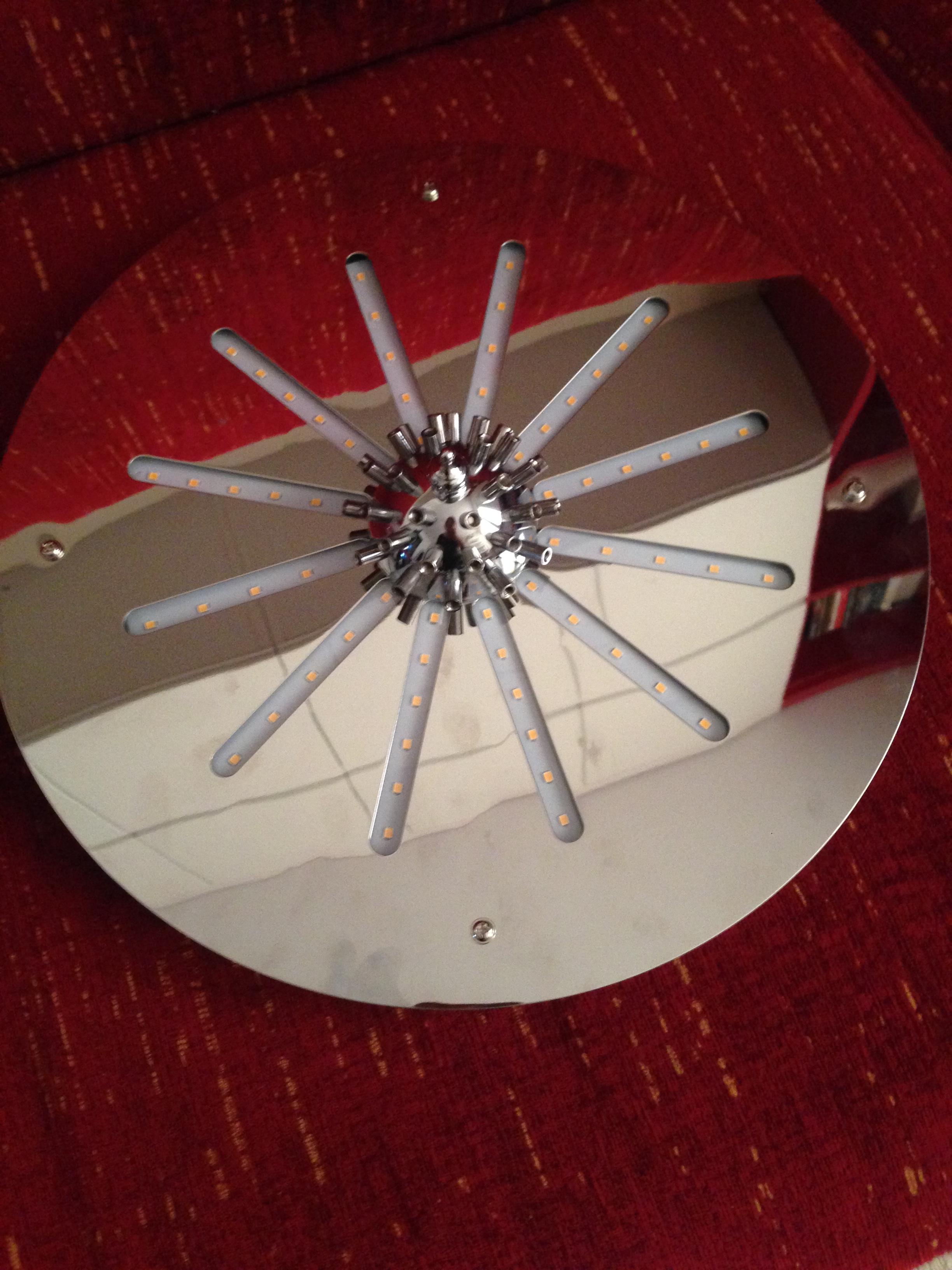

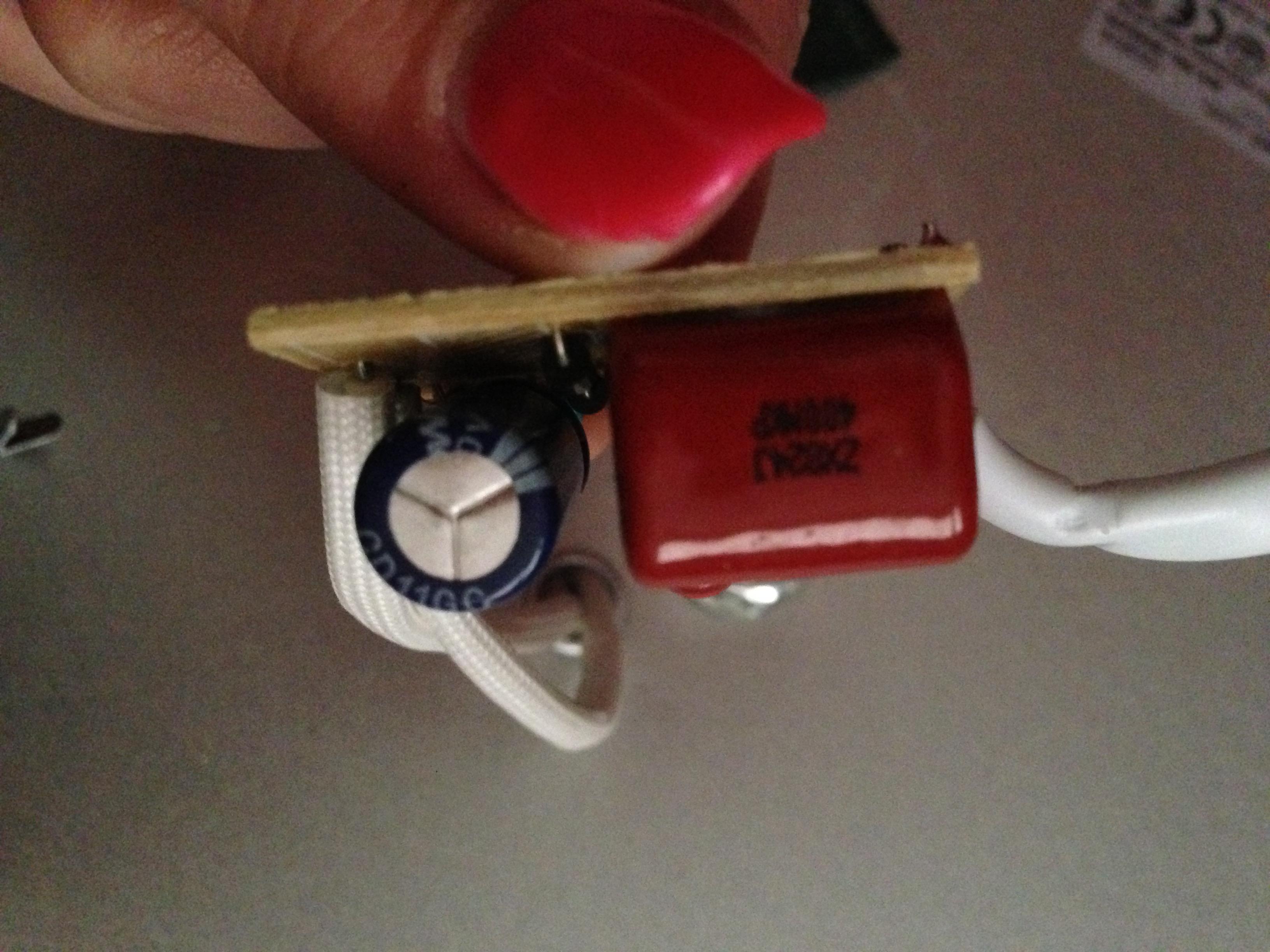

  • #8 16396335
    haniaw
    lamp pics
    Theodor LED Chandelier Not Shining: Lamp Failure Causes, Resuscitation Possibilities, PCB Issues Theodor LED Chandelier Not Shining: Lamp Failure Causes, Resuscitation Possibilities, PCB Issues Theodor LED Chandelier Not Shining: Lamp Failure Causes, Resuscitation Possibilities, PCB Issues Theodor LED Chandelier Not Shining: Lamp Failure Causes, Resuscitation Possibilities, PCB Issues Theodor LED Chandelier Not Shining: Lamp Failure Causes, Resuscitation Possibilities, PCB Issues Theodor LED Chandelier Not Shining: Lamp Failure Causes, Resuscitation Possibilities, PCB Issues

    Many electronic components are not there and the kumaty electronics should be able to handle this board.

    Modest electronics. Kumaty Kaziu can handle it. But these LED strips are also for review.

    It looks like a classic transformerless power supply. The most likely damage is one of the diodes, which is nothing special with this power solution.
    The truth is that measuring the voltage at the output of the power supply - if it is close to the maximum value, one of the diodes or the connection between them is damaged at 95%.

    A friend wrote and mentioned that she would try to advertise. In fact, this is the best solution, because if there are several dozen LEDs powered directly from a transformerless power supply, it will always break. All you need is overvoltage in the network.
    Apparently, for example, LNK304 is an expensive integrated circuit for a Chinese. :)

    I don't think there is much to watch. You can see the transformerless power supply, I suppose that apart from it there are only diodes connected in series - judging by the output voltage of the power supply - about 50 diodes.
    They make such inventions, and then unfortunately it breaks down. I have already seen chandeliers with current sources, e.g. 1500mA / 33-44V, I was almost sure that there were 5W LEDs - unfortunately, there were 10 strips connected in parallel and on each of them 14 LEDs connected in series. :)
    Why did they do that? Because it would not fit into the base of 10 power supplies, not to mention the cost. So they gave one power supply with greater efficiency than needed, but at the same time with a slightly lower voltage than would be required for the diodes to work with the nominal current. Everything works beautifully until one of the LEDs goes out or there is a break. Theoretically, nothing should happen because the voltage is lower, but it does.
