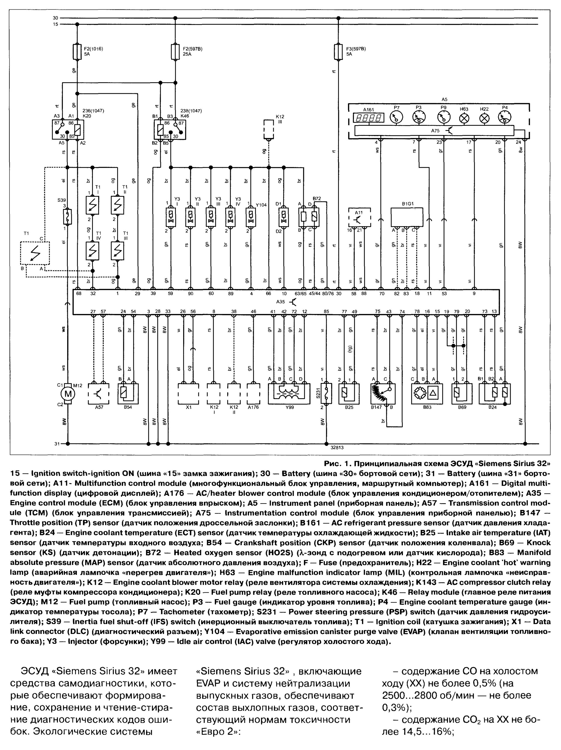

    Hello. I have a 1,6-16V scenario on the machine in the machine and with the Sirius 32 driver with the numbers S110010004 D. Unfortunately, he gave up the ghost, i.e. the 2nd and 3rd cylinder stopped walking. Well, the quick decision to buy and install the entire pledge only that the numbers S110030050 B. theoretically everything goes. You can connect with each component. The problem is that the box controller does not receive signals about: the engine speed and the position of the throttle sensor. Quick decision and refilling of the controller. Still the same. The important thing is that on the original one (where two cylinders do not work) it's OK. Therefore, no connections are dropped. Maybe someone has a diagram of the outputs of one and the other controller. I am thinking about connecting to the appropriate controller outputs with cables going to the box controller. I will be grateful for your help.

    automix wrote:
    Maybe someone has a diagram of exits
    Renault Megane/Scenic: Differences in Sirius 32 Driver S110010004 D and S110030050 B Outputs? Renault Megane/Scenic: Differences in Sirius 32 Driver S110010004 D and S110030050 B Outputs?
    Schedule "borrowed" from the subject: https://www.elektroda.pl/rtvforum/topic2828359.html
    http://reno-symbol.ru/html/sistema-vpryska.html

    thanks to my colleague CameR - he was the only one who gave me what I was looking for. Apart from stupid people who do not bring in the remaining posts (I think, resulting from the lack of knowledge on the given subject), nobody was able to answer my question. After tracing dozens of schemes, I already know everything about the ECU connection of the gearbox with the engine ECU. If this knowledge had a nickname STRUMIEŃ AWWOŚĆ would write that the connection is after CAN and finished the whole discussion. Well, unfortunately, I stopped using the electrode on the forum because it was once a treasure trove of knowledge and now it is the majority of "gówniarzy" who seem to know everything and know everything on everything. Embarrassment.
    By the way, Sirius 34 worked beautifully in which there are always exits to the crate, unused at the manual chest. I think that the topic is closed !!!!
