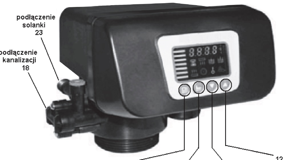

    I have blue water water softeners at home and for 3 months I do not need salt for regeneration. At the beginning (I threw the whole bag at once) it made a shell of salt on the bottom. I cleaned, scraped ... after switching on the filter manually, the water normally flows through the filter into the canalization, the processes are done, but I just threw in so that I can not see the water in the container and this is the 3rd month ...
    What could it be ? it is possible that something is still clogged up?
    This tube that goes on the days of the tank is unpolluted ...

    I have analyzed the driver because it is different than this one but I can not find its type
    Blue Water Softener B252701013: Salt Not Taken for Regeneration After 3 Months - Possible Clog?
    There is nothing about errors
    When manually switching to BRINE REFILL regeneration mode 4 it should fill the brine tank with water and there is nothing there. The water is somewhere in the head but nothing in the tank is happening
    The model is ECO DW20
    The only thing I found about the controller is the RX

    Strange, but it suggests a solenoid or electromagnetic pump for pumping NaCl solution for regeneration of the cation exchanger. Does not drop this solution, after manually pressing "regeneration" with the button on the controller?

    Well, I just looked at this tube with the tube through all modes and nothing happens there, neither when filling nor downloading. The head hisses tightly enough micno but in the tank nothing ...

    In which place is this pump in such heads? Can you look there without disconnecting from the network? after setting 4 regeneration cycle, the refine refill does not fill the well, so something must be with the element that releases the water ...
