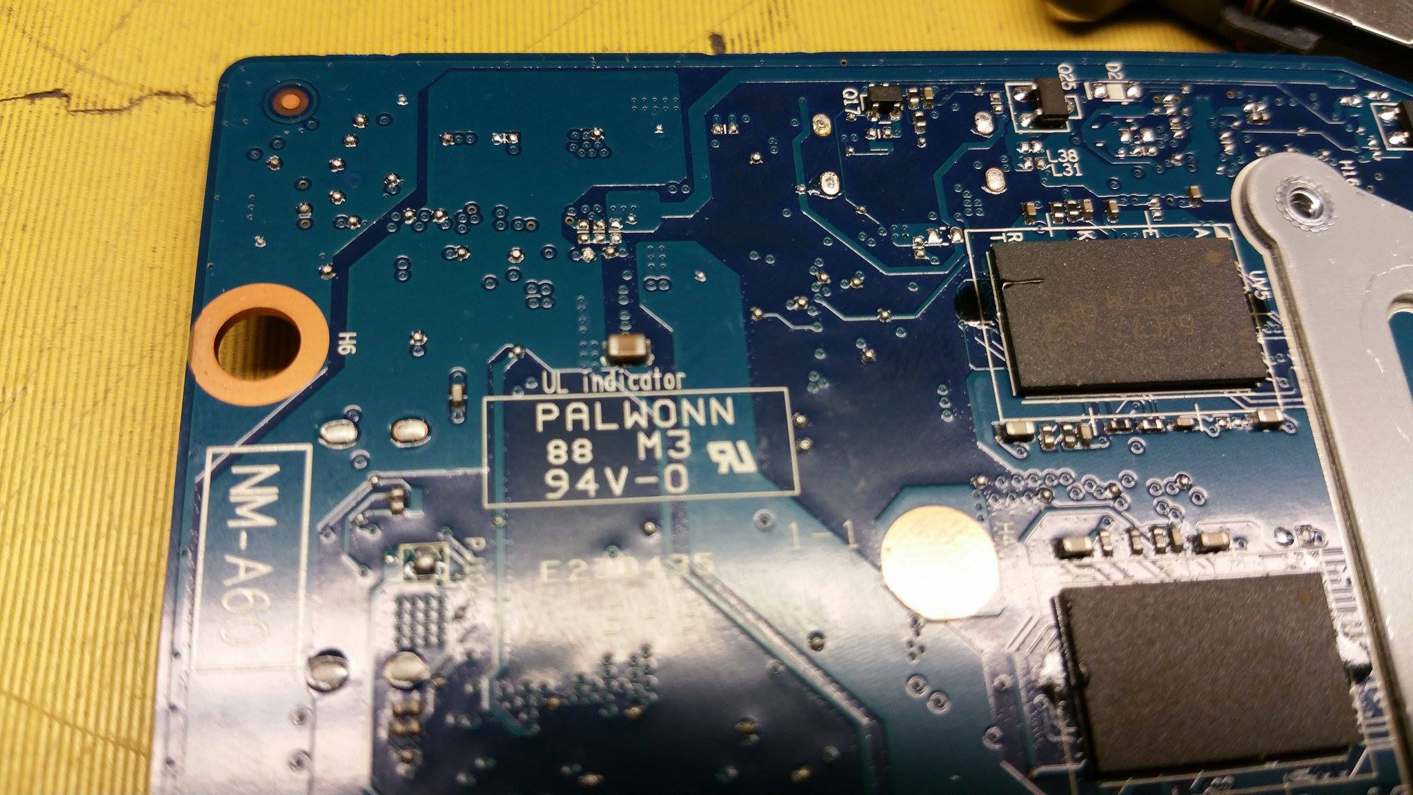

    The BYG43 NM-601 board, I can not find a schematic for this model anywhere, if anyone could identify the PD109 and U101 elements on the FWL diode and the 5 foot transistor has the 5AF2W mark in advance, thanks for all your help.

  • #3 16259314
    _1KOKO
    Posts: 2256
    Help: 223
    Rate: 164
    It was also burnt above 4407A Lenovo Yoga 700-14ISK: BYG43 NM-601 Board, Identify PD109, U101, FWL Diode, 5AF2W Transistor
  • #4 16259335
    lisek
    Service technician RTV
    Posts: 39995
    Help: 6352
    Rate: 6883
    What is this layout, description? / * yellow arrow
    - the second arrow is probably a power socket ?!
  • #5 16259426
    _1KOKO
    Posts: 2256
    Help: 223
    Rate: 164
    The system is BQ24770 and the battery socket is the 5 pin on the left side of the photo black.
    #6 16259614
    lisek
    Posts: 39995
    Help: 6352
    Rate: 6883
    BQ24770 ( Link )
    * helpful (bq24780SE) - user guide, see Link_bq24780S E
    Probably Schottky diode
    Look in SM from Lenovo 500s (Compal LA-D061P)
    ps
    See if you have similar subtitles on the disc
    448.06701.0011 that is the Wistron LT41 platform
    (write from the cooling UK side
    MS is gone.
  • #7 16261723
    _1KOKO
    Posts: 2256
    Help: 223
    Rate: 164
    Only such markings. Lenovo Yoga 700-14ISK: BYG43 NM-601 Board, Identify PD109, U101, FWL Diode, 5AF2W Transistor
