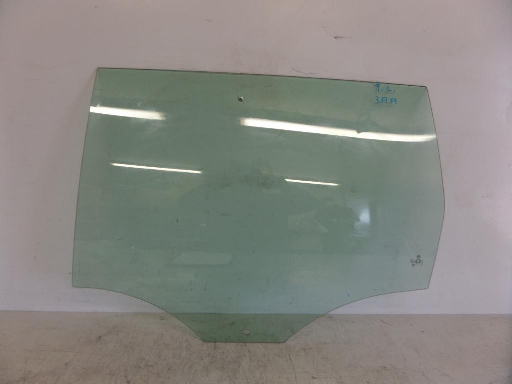

    I have to replace the glass in the left rear door.
    I know how to remove the bacon, but what next? The glass has a hole at the bottom and there are some two plastic elements in it. How do I remove them and should I put these pins in the glass before installing the new glass in the door or after placing the glass in the door?
    • VW PASSAT B7 Saloon: Steps for Left Rear Door Glass Replacement and Handling Plastic Elements szyba.jpg (46.21 KB) You must be logged in to download this attachment.
  • #2 16262134
    Pedros050
    Posts: 17914
    Help: 2471
    Rate: 3927
    Only after installing the glass you must secure the glass with pegs in the guide against sliding out when tilting the glass.
  • #3 16262142
    marcinsgdz
    Posts: 72
    Rate: 60
    And how do you remove these pins from the glass when it is still in the door?
  • #4 16262147
    Vytautas_YT
    Level 30  
    Posts: 1425
    Help: 128
    Rate: 297
    The smaller one which is inside the bigger one should be able to stand out. Once you get the smaller one, the bigger one should come out without a problem. It works on the principle of a wall plug.
  • #5 16262174
    marcinsgdz
    Posts: 72
    Rate: 60
    And what to knock out? So after breaking it will fall somewhere?
  • #6 16262218
    Vytautas_YT
    Level 30  
    Posts: 1425
    Help: 128
    Rate: 297
    Sorry buddy, correction. You have to take it out somehow to yourself. In this metal sheet, which is from the inside of the door, there are such rubber plugs, after moving the glass to a certain height in one of these holes should be (not easy) access to these pins. I made a mistake writing the previous post.
  • #7 16262229
    marcinsgdz
    Posts: 72
    Rate: 60
    OK, but the assembly is unchanged, i.e. mounting the wheels when placed in the door?
  • #8 16262232
    Vytautas_YT
    Level 30  
    Posts: 1425
    Help: 128
    Rate: 297
    Yes, you have to slide the glass in its place and then install the dowels through the same hole.

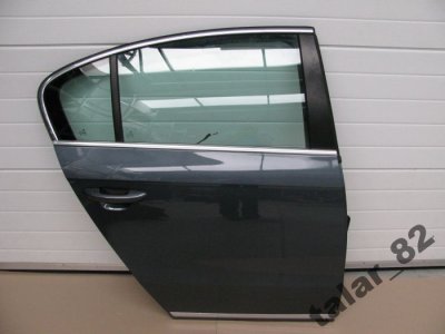

    And can you advise how to replace this small glass?
    • VW PASSAT B7 Saloon: Steps for Left Rear Door Glass Replacement and Handling Plastic Elements 6287927130.jpg (17.5 KB) You must be logged in to download this attachment.
