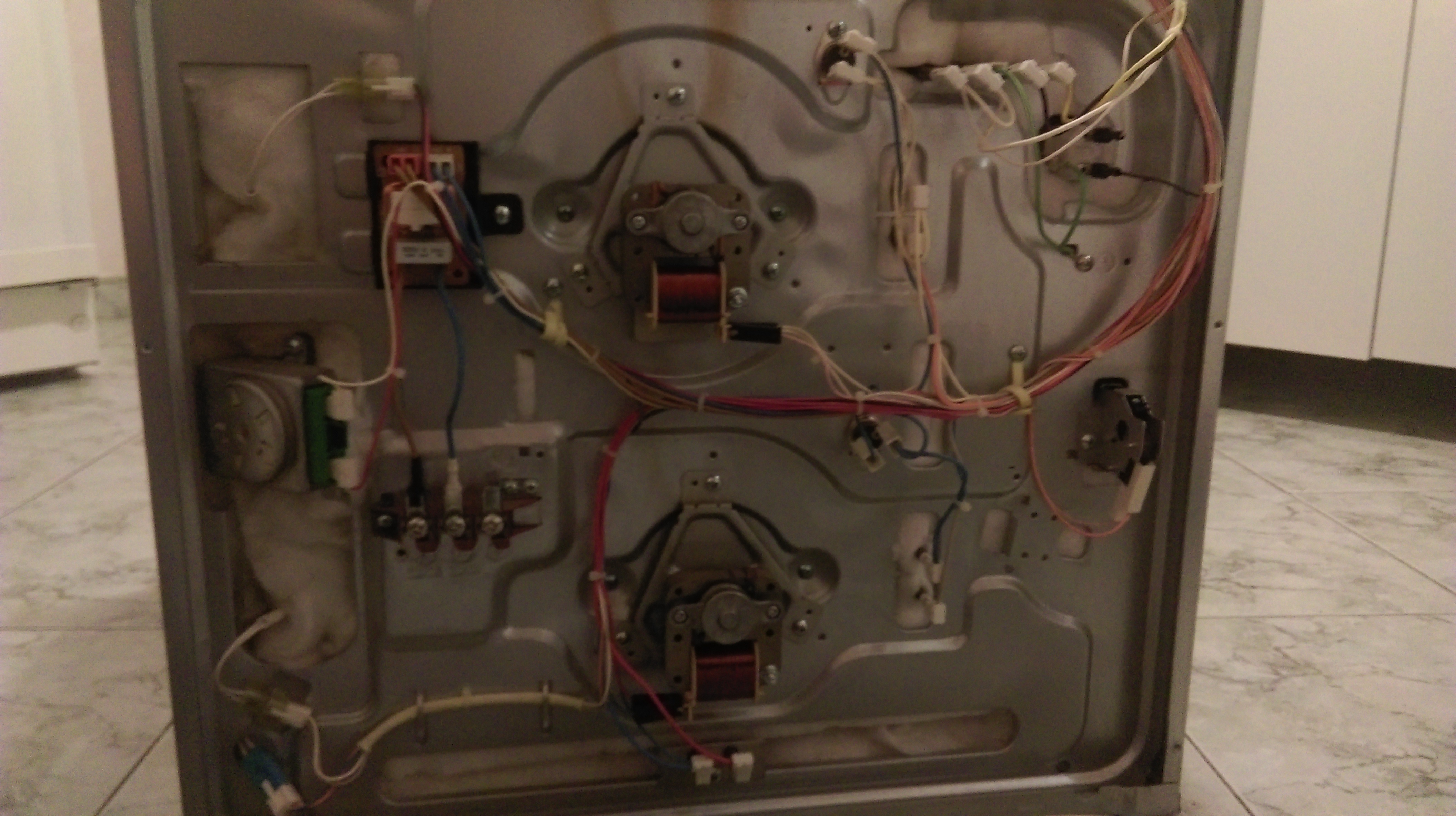

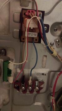

    #4 16276593
    zegnallo
    Posts: 20
    Rate: 9

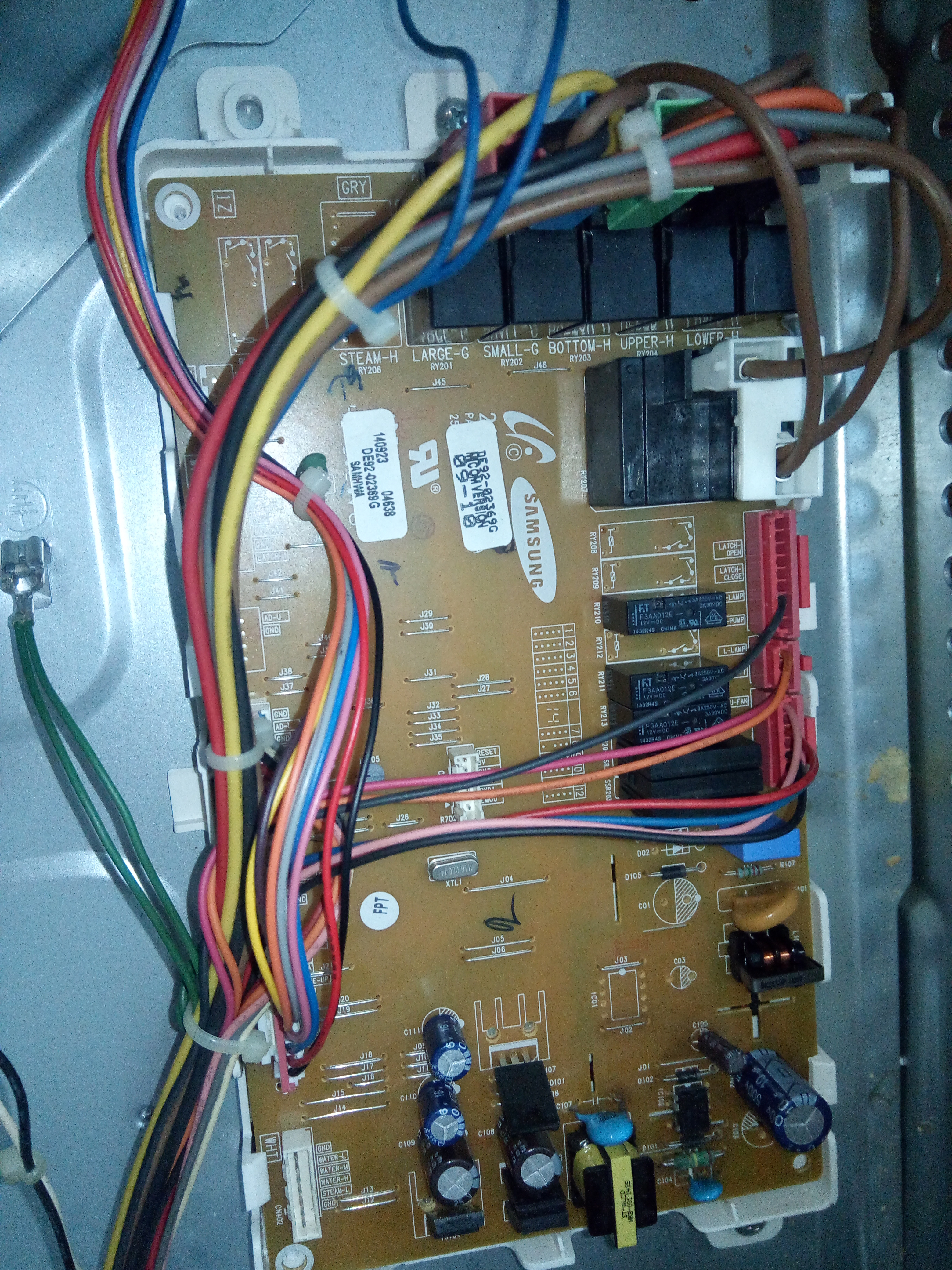

    The power cable is ok. The board looks good too, there are transitions.
    Samsung BT62TDBCT Oven: Display Off, Not Working - Troubleshoot & Possible Causes
    I checked the cables ... I moved everything I could and connected the oven ... it works, I was happy but after twisting everything and reconnecting it didn't work anymore ... I don't know where the problem may be. I also noticed that in one cable you feel a slight tingling sensation as if the current was coming ... it's about the pink cable on the bottom right
    It also adds other photos, and maybe someone will suggest something ...
    Samsung BT62TDBCT Oven: Display Off, Not Working - Troubleshoot & Possible Causes Samsung BT62TDBCT Oven: Display Off, Not Working - Troubleshoot & Possible Causes Samsung BT62TDBCT Oven: Display Off, Not Working - Troubleshoot & Possible Causes Samsung BT62TDBCT Oven: Display Off, Not Working - Troubleshoot & Possible Causes Samsung BT62TDBCT Oven: Display Off, Not Working - Troubleshoot & Possible Causes
    I also wondered about one cable that looks like it has been smoked.
    One more thing ... colleague tod.1977 from the forum he wrote to me that it could be a suppression filter ....
  • #5 16276675
    cezet
    Posts: 7549
    Help: 719
    Rate: 1407
    zegnallo wrote:
    a colleague tod.1977 from the forum wrote to me that it could be a suppression filter ....
    The interference filter is the one at the top of the picture. The supply voltage at the filter outlet and the main module input must be measured.
    And if you think that the sooty cable may be the fault - it would be better if you ask a competent person to repair it.

    Organoleptically impossible to check. Multimeter in the handles and forward one by one and probably will be better as the colleague above suggested (because you can see that probably even a particular color is not known). I am sorry to write this but it will be safer if you even ask a neighbor with a multimeter.
  • #7 16276855
    zegnallo
    Posts: 20
    Rate: 9
    I do not think that this may be the only reason why this is ... the fact that I know very little about such things, but that's why I wrote this topic.
    There is 240 at the filter output. At the main module input? I mean on this board yes? Only where what and how if you can say

  • #8 16276972
    wiesiekmisiek
    Posts: 1588
    Help: 259
    Rate: 524
    The current flows in cables, so along this path. L is the power supply (line) N neutral. Do you have a fuse on the board, check the resistance, next to it is not see a varistor, thermistor? Check continuity, do not make circuit resistance under voltage because you will damage something and yourself. The board is described and there are paths on the other side. So much for now. Good luck.

    The first thing to check the thermostat model PW-3V X241 N130 on the ohm meter should be a transition of 3 pcs, (looks like a metal tablet) then a burnt relay to AQG 22212 fans which caused the fans to overheat and melt.
    After replacement, the thermostat costs about 60 PLN, relay 15 PLN, fan 170 PLN.
    everything works .

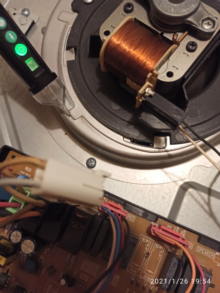

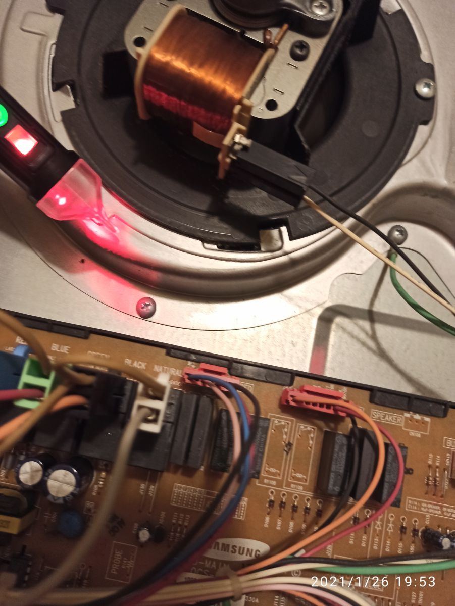

    #13 19212074
    podri
    Hi
    Was the oven repaired?
    I have a problem with puncturing the housing. When this white wire is connected to the natural lower Heather, there is a puncture on the entire housing. It is the lower heater on the fan. When I disconnect everything is ok except that the heater does not work. Can the relay itself be replaced or the entire board?
  • #14 19212125
    mrice
    Moderator of Home appliances
    Posts: 13955
    Help: 2213
    Rate: 6951
    First, check the correct connection of the power socket (especially the protective conductor), then throw the toy away and perform a proper measurement with a multimeter.

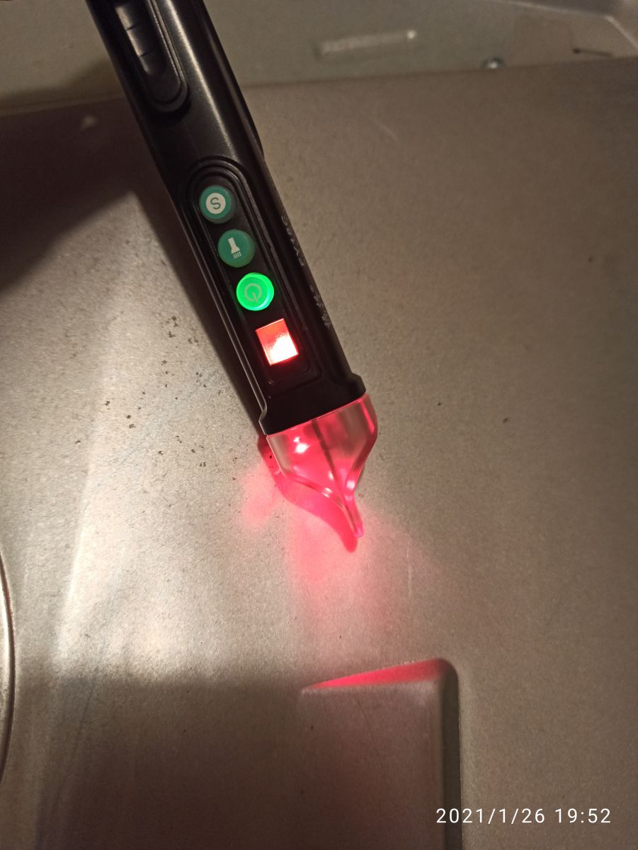

  • #15 19212170
    podri
    Thanks for the answer
    1. The oven worked flawlessly for 11 years.
    2. This toy prevented my family from shocking.
    3. The puncture is present throughout the restoration and the photos were only to show that the puncture disappeared after disconnecting the white plug
  • #16 19212188
    mrice
    Posts: 13955
    Help: 2213
    Rate: 6951
    podri wrote:
    2. This toy kept my family safe.
    What did this toy measure? What is this leakage?
  • #17 19212413
    podri
    She did not measure anything because it is a voltage detector only indicated that there is a breakdown on the housing
  • Questioning what the detector actually measured
    #18 19212441
    mrice
    Posts: 13955
    Help: 2213
    Rate: 6951
    Such a charm of devices with motors, heaters and other interesting elements, for a mushroom, the manufacturer decided that the device should be connected to a socket with a pin.
    The detector, as the name suggests, is used to check and detect voltage, and in practice the only thing it can do is to determine the phase conductor, certainly not to check breakdowns.
    Besides, you didn't answer my question
