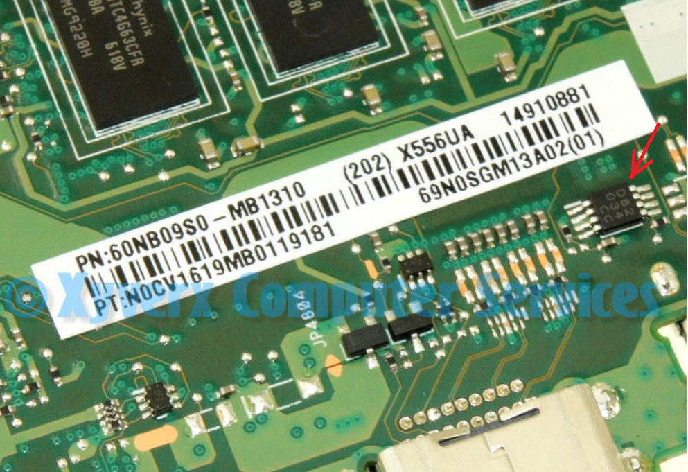

    The laptop got damaged after a power surge. Maybe someone has the D82034 layout as in the photo, or part of the schematic with it.
    60NB09S0-MB1310

    This is DAC8552IDGKR.
    What role would such an A / D converter play in a laptop?
    This is only an 8-pin, take a piece of paper and a pencil and draw it ..
    - see "where this (D82034) is located" and draw conclusions
    ( ' :idea: ') Then compare what you drew with e.g. G547G or ... (TPS2061, G528, ...)

    In fact, this DAC8552IDGKR circuit powers the USB socket. I typed him as damaged, because he has a hole (chipping of the housing), but it is not he who will probably be responsible for the lack of switching on. I also found a short circuit between the gate and the source of the M0930M system (counting the second from the power plug). I ordered a replacement FDMC8884 from ConradElektronic. The defect arose as a result of damage to the power supply and the input in the laptop appeared 230V when the laptop was connected to the lan network with "cable".
    No DAC8552IDGKR only BD82034FVJ.
    damszelb wrote:
    The fault arose as a result of damage to the power supply and 230V voltage appeared at the input of the laptop when the laptop was connected to the lan network with "cable
    After such overvoltage, the repair of the plate is impossible, even because of almost certain damage to the laminate.

    You have a datasheet for this layout (d82034fvj) link
    - draw as I wrote and think
    Since how you write 230V appeared on the input ? ( which input / output ) (after damage to the power supply) rather start looking for a new disc!

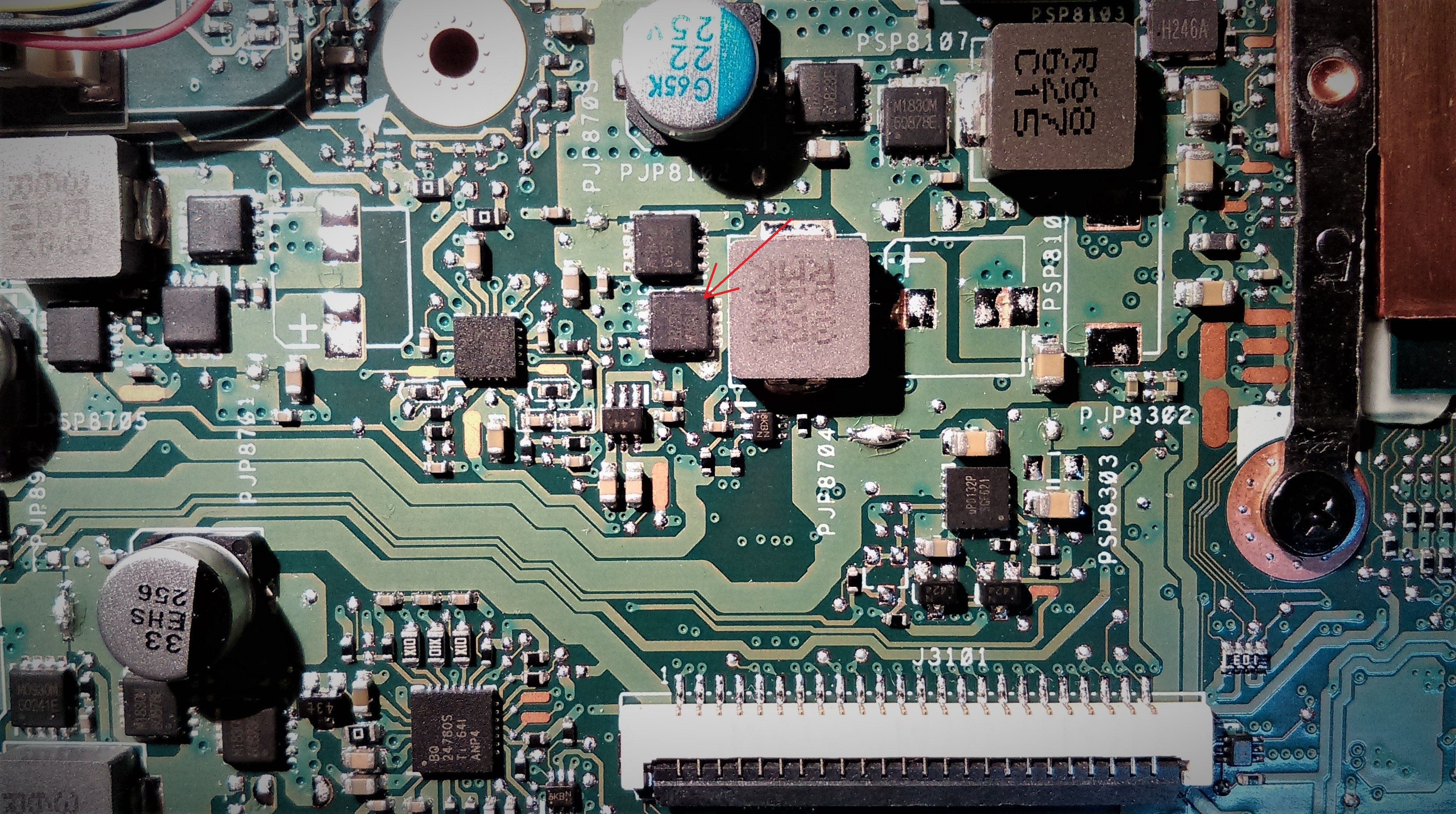

    I have found a short circuit on the M1830M transistor, but the transistor is OK. Asus F556 - identification of the D82034 element after overvoltage

    damszelb wrote:
    I still found a short circuit on the M1830M transistor, but the transistor is OK
    What is the coil resistance to ground?

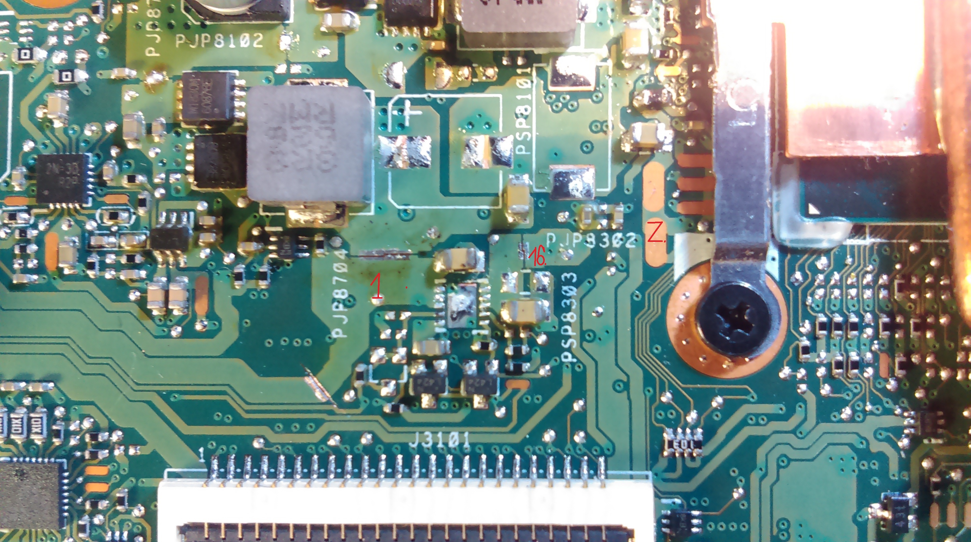

    Through this coil, next to the M1830M transistor, a voltage of 3.3V is supplied on uP0132P, which I dismantled thinking that he is doing a short to ground. I removed the PJP8704 and PJP8302 service jumpers and took my break. Resistance measurements showed:
    Point 1 has 1ohm to ground, Z is shorted and 16 has the same amount to ground. Asus F556 - identification of the D82034 element after overvoltage

    I need a hint regarding the points described in the picture 1.16 and Z - what elements on the board are connected with?
    In a working board, point Z is 100 ohm relative to mass, and the remaining 1 and 16 do not have such a short to ground.

    See if you have passage points. 1/16 (meter to ohms) to the pins of the soldered circuit, if so which?

    A short-circuit test will help you.
