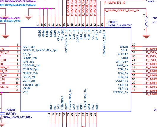

    The X540UV rev 2.0 board from ASUSA after flooding. After cleaning and replacing the damaged components, it boots with no image. The current voltages on the chokes are 3.3V, 5.1V, 1.230V and 1.025V. One choke from the CPU has 1.025V, and the other two have 0V. A voltage of 19V reaches the mosfets, but the mosfets do not open.
    In the picture I marked the mosfets, from two gates lead to the adjacent NCP81236A (I could not find the datasheet), and the other two gates I do not know where they have a connection.

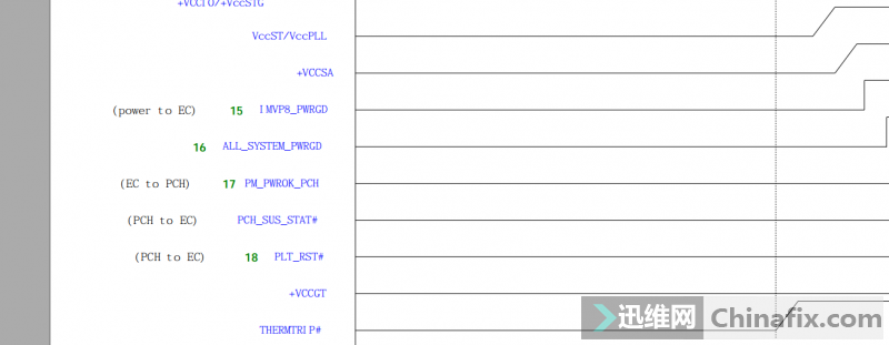

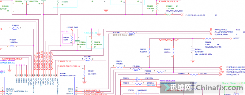

    pin.12 19V, pin.13 VCC has 5V, pin.14 4.5 V, pin.22 empty, pin.26 4.5 V, pin.39 for which all the way to the CPU power supply power stage open(the other way is no post-stage driver chip, directly to the upper and lower tubes), a red table to measure this foot on the protection, pin.41 is open 3.3 V, pin.42 is IMVP8_PWRGD 3.3 V, now the question is, CPU power supply is not out, why pin.42.... Through the timing, found that PCH_SUS_STAT#(including and after) are no voltage,before all signals and voltages are normal, PLT_RST#no voltage, this should be CPU power supply is normal, there will be a reset
    * no NCP datsheet...., but look after the similar RT8820AGQW ( RT8815A)
    * see if this one doesn't approach NCP81232 qfn40

    4 days and the owner tried to start it +dryer marks on the palmrest
    which means NCP plus field plus ? cpu ... to replace
    *since the graphics in the cpu (without NVidia)
