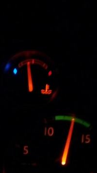

    Hello, I would like to emphasize that Daf has a retarder, I replaced the thermostat with a second (not original) new one, it turned out that the temperature was lower than on the old one, so I ordered the original Dafoski with parameters 83 'the temperature is still low 75' maximum, the car burns 33l / 100km normally smoked 29l, (the normal thing is that he smokes more). The driver covered the entire coolers with cardboard, but the temperature did not rise. Apparently, in the housing where the thermostat is mounted, there are o-rings that could pass, but the o-rings are whole. The radiator should be cold and after the engine fluid warms up, the thermostat should open and the radiator should become warm and cool the warm fluid, etc. In my case, the radiator is cold and after some time it heats up and is still warm, it would turn out that the fluid all the time circulates in the system and is not held by the thermostat or the o-rings in the thermostat housing, maybe someone had such a case and will suggest something wise.

    The car had a completely blocked cooling cover and a continuous 21 tons of temperature did not rise at all. It is not possible that the temperature would not rise, although it would go up a little. Suspect temperature sensor or sensor installation. When the computer sees that the car is underheated, it gives it a larger dose of fuel and thus burns more. Visco had a test done and it came out normal, Everything will be explained on Tuesday.

    Hello. I have the same problem with the liquid temperature indicator before half in 2010 Daf 105,460, fuel consumption has increased tremendously at the level of 40-42 l. If the matter has cleared up, please give me a hint to remove the fault in my Dafa :) best regards
