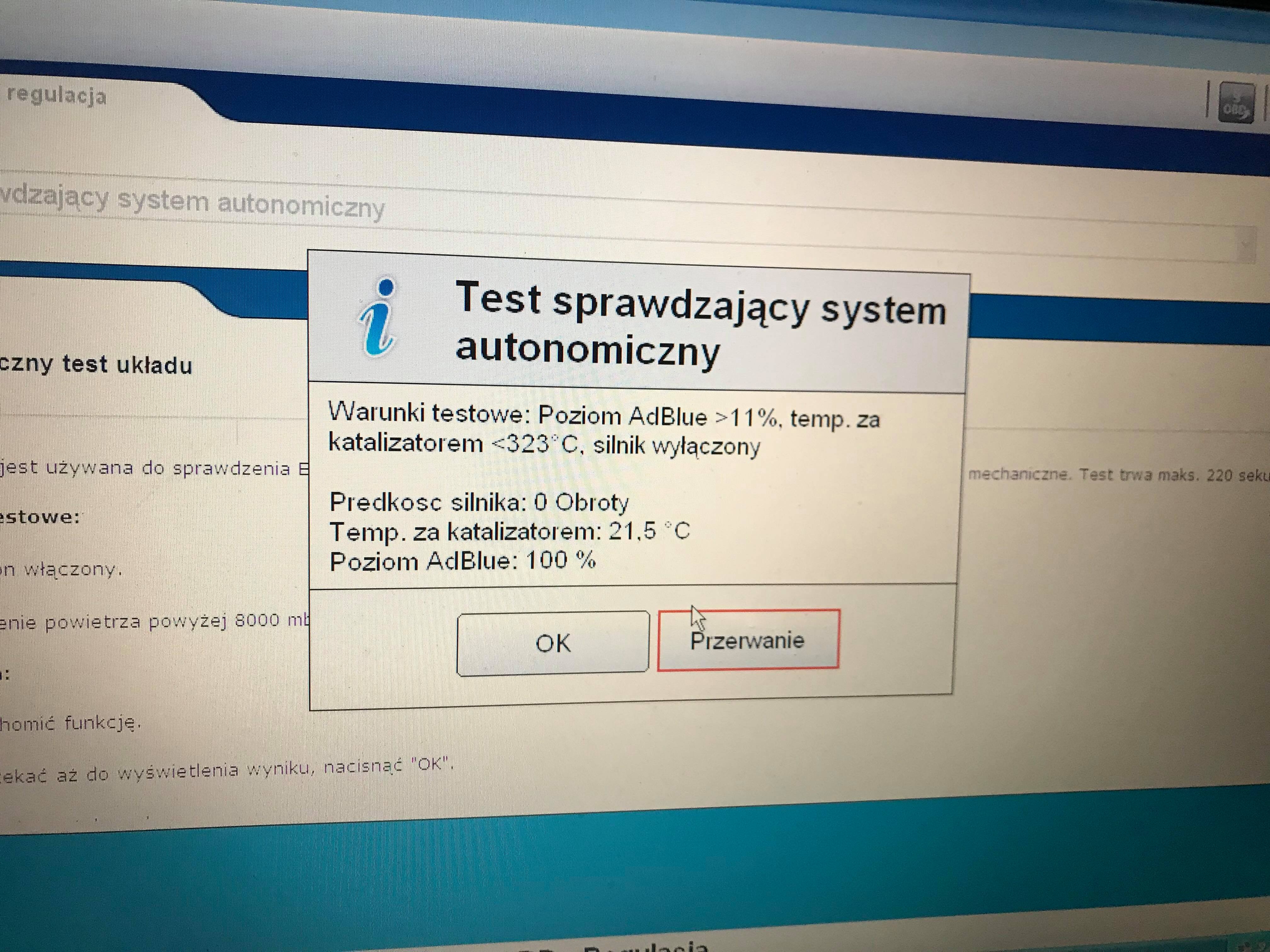

  • #19 17799432
    szy18
    Posts: 152
    Help: 8
    Rate: 126
    Board Language: polish
    DAF Xf 105.460 (2007) - Exhaust and Cloud Warning Light Issue, Adblue Module & Sensors
    Unfortunately, despite the removal of the problem of clogged tube, there is no improvement. The same error returns.
    Higher screen from the autonomous test, next window "test failed"
    in the 2013 EEV, the autrinomic test passes without a problem. Is the end of the pump?
  • #20 17817971
    szy18
    Posts: 152
    Help: 8
    Rate: 126
    Unfortunately, the black vision came true. The pump replacement solved the problem.
