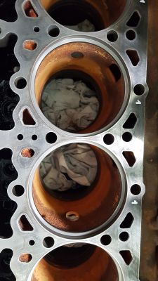

  • #8 17370277
    mechanikDAF
    Posts: 8
    Rate: 13
    Everyone who has Dafs from 2010-13 and gathers compression, pressure in the expansion tank, there is no uncle in the village so that the reason for this was not a dropped or cracked sleeve due to cavitation-falling out of iron particles within the cylinder seats under the sleeve flange . This is a disadvantage of these blocks. In older models, the sleeve may be dropped due to operation, and only milling of sockets for oversize sleeves brings effect.
    Guest from Bielsko Biała DAF XF 105.460 2008 - Coolant reservoir pressure. (fluid out) comes, milling and after the case!
  • #9 17370532
    krisbrumm
    DAF Trucks specialist
    Posts: 912
    Help: 164
    Rate: 831
    it's not cavitation buddy. The effect of cavitation is pitting on the surface of cast iron reminiscent of the surface of mars or golf ball. And by the brackets, cavitation is created when the coolant contacts the free surface of the sleeve. In the place where the sleeve has a flange there is a tight contact of the flange surface in the sleeve and the flange surface in the block.
    The phenomenon of sleeve fall is caused by so-called relaxation - that is, in the sleeve collar subjected to compressive stress, as a result of temperature cycles, the compressive stress disappears and deforms plastically. The same applies to stresses in the block within the flange.
    Current methods used in engine design include FEA simulations and are able to simulate this phenomenon by computer and predict when the phenomenon of internal stress disappears in the material - if it occurs at all.
    Read about relaxation in the materials and you will learn, among others why a spring loaded with constant pressure, after a while it gets lower ... And the fact is - this is a disadvantage of these engines. The boring machine is available among DAF's special tools, but it is extremely expensive. I saw it somewhere in 2013 with an electromagnet to immobilize on the block ... You can suspect the sleeves if the car overheats. But if you just build up pressure in the system. cooling and the car does not lose fluid and does not overheat, the compressor will be more likely ...

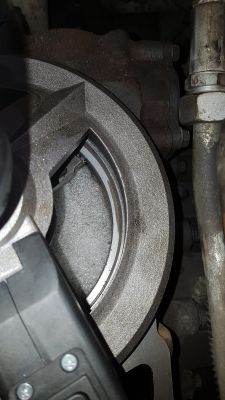

  • #13 17878080
    Waldek Gdansk
    In case of pressure in the cooling system, please contact me.
    We have a professional boring machine for engine blocks with a knife dedicated to Dafa.
    We arrive, measure, and if necessary, mill the damaged socket of the block.
    I invite users and workshop owners to cooperate.
    Fast, efficient and reliable
    Waldek Gdansk
    Tel. 603 923 275
    • DAF XF 105.460 2008 - Coolant reservoir pressure. (fluid out) 20190331_192709.jpg (559.08 KB) You must be logged in to download this attachment.
  • #15 18481090
    Trucker Daf
    Posts: 97
    Help: 8
    Rate: 59
    Here the anti-cavitant will not help, too late! The need for "milling for oversize collets" DAF XF 105.460 2008 - Coolant reservoir pressure. (fluid out) . DAF XF 105.460 2008 - Coolant reservoir pressure. (fluid out) DAF XF 105.460 2008 - Coolant reservoir pressure. (fluid out) DAF XF 105.460 2008 - Coolant reservoir pressure. (fluid out)
