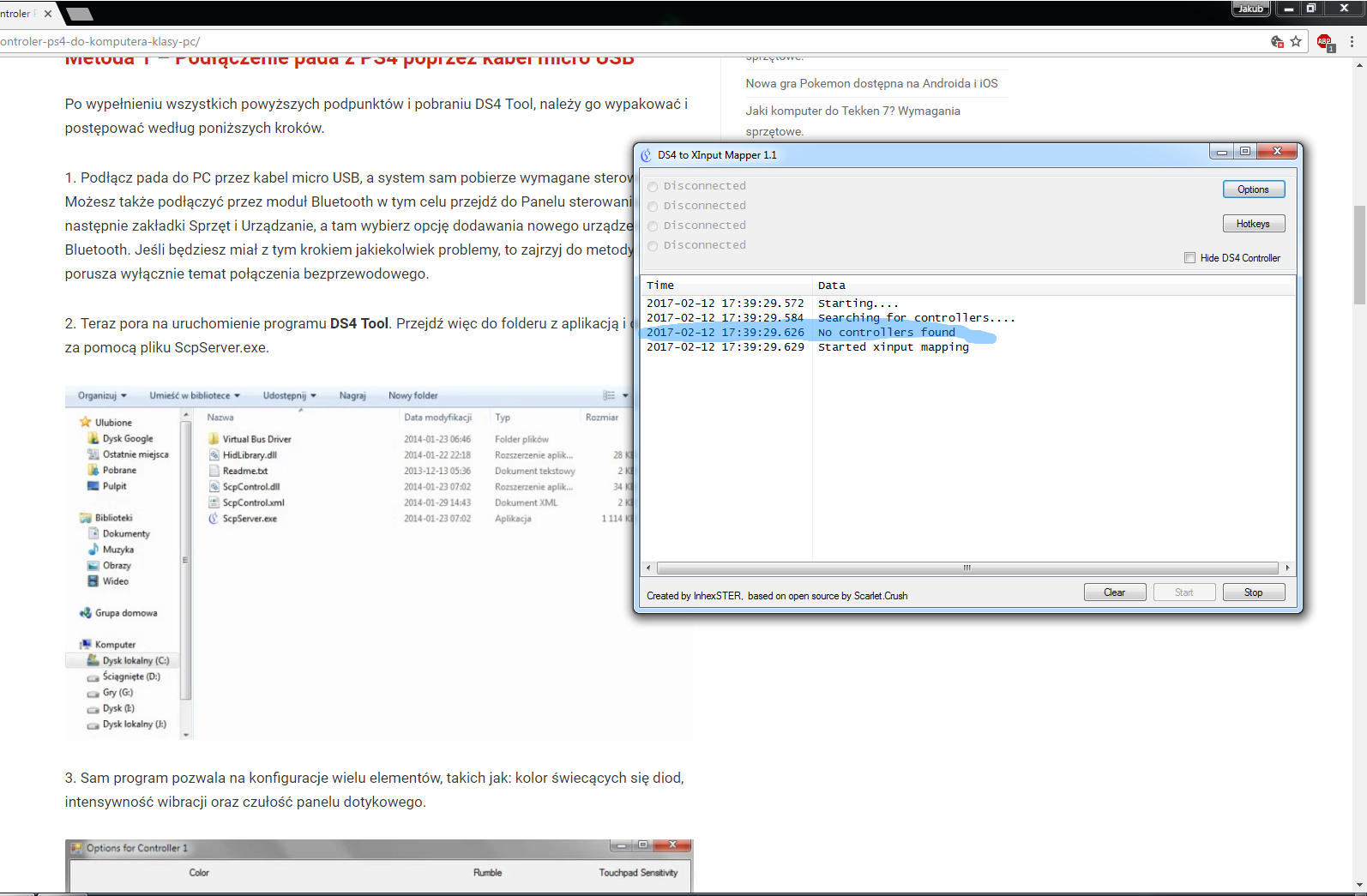

    Hello, would someone help me connect rada dualshock 4 and install all programs so that I could play Fifa on the PC? Because as it installs something is wrong - all buttons work inversely and the right analog does not work at all; I was modeled after different YT affiliates and always the same. :( Please help.

    The pad does not work as it should, I press the wheel and the player passes instead of shooting, I press r2 and it presses 2 times and I press only once

    I have 2 pads - they don't even have a month. :D
    This situation, and even how it works, is not how it should be:
    Connect & Install Rada Dualshock 4 for PC - Reverse Button Fix & Right Analog Solution in FIFA 15SHU_dz3...png (328.65 kB)You must be logged in to download this attachment.
    Added:
    He shows me 2 pads and 1 is connected, don't ask why Fifa 15 because I want to go back to older Fifa, I have 17 on PS4. :D

    I have ds4 windows, and this is how it looks, I will add that when starting the game it is ok e.g. I press x to scroll, and already e.g. in the game menu I press r1 and jumps by 2 positions instead of 1 ..., the rest on the attachment Connect & Install Rada Dualshock 4 for PC - Reverse Button Fix & Right Analog Solution in FIFA 15

    The solution to the problem turned out to be turning on fify and only then connecting it with the program turned on and everything flashes, I close
