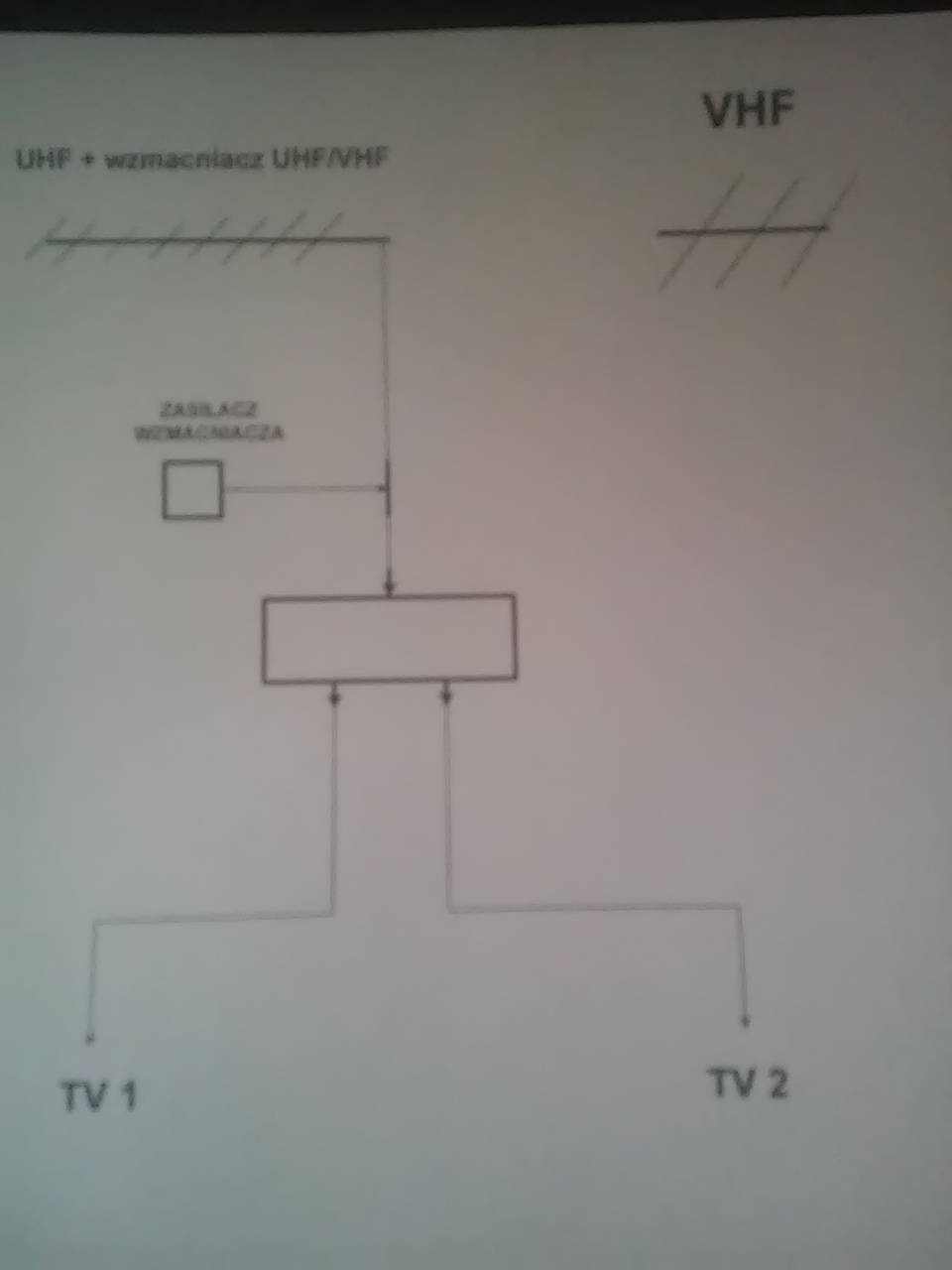

    Hello. I currently have a layout like in the picture - logarithmic directional antenna with UHF / VHF amplifier, power supply and splitter for two tvs. How to connect an antenna on a VHF to it, does it have to be an amplifier? I have 55 km for the VHF 16M transmitter.

    If you want to receive both the UHF and VHF bands from these two antennas and connect them to, for example, a DVB-T decoder, then in this case you should use a crossover that will sum up the signals from both antennas and send them to the input circuits of the head in decoder.

    I know about the crossover, but what plates in the antennas? One amplifier and the other also an amplifier? How to power it?

    There must be an amplifier in the UHF antenna and in the VHF I do not know if it can do without an amplifier, they say to avoid amplifiers

    Hello. I currently have a layout like in the picture - Logarithmic directional antenna with UHF / VHF amplifier , power supply and splitter for two TVs. How to connect an antenna on a VHF to it, does it have to be an amplifier? I have 55 km for the VHF 16M transmitter.
    And what do you need a second antenna for if you already have VHF / UHF?
  • #7 16274091
    Probably the VHF signal is coming from a different direction.

    Another direction
    Added after 3 [minutes]:
    I was offered the ZWR-210 DC Telmor crossover, I think it will solve the problem

    Definitely. And you can have one or two amplifiers depending on which antenna you need.
